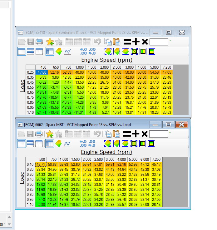

E30 should give full MBT timing

It's fine to use E30. The only reason for @WildHorse to do a check log is because he has a 18 intake manifold on a gen 2 coyote with gen 2 injectors. The 18 manifold reves higher and flows more air than the gen 2 manifold.
Yep. Good thing I spend very little time @ WOT doing the 1/4 mile. 11 secs or so haha.

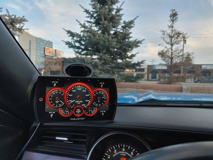

Good to be driving the whip again after a long slumber
Anyways, reloaded my 91 tune.. went for a burn. E30, probably
closer to E35 after 4 miles.

Went on a 100 mile drive today.
STFT seemed to have settled at 2%.
