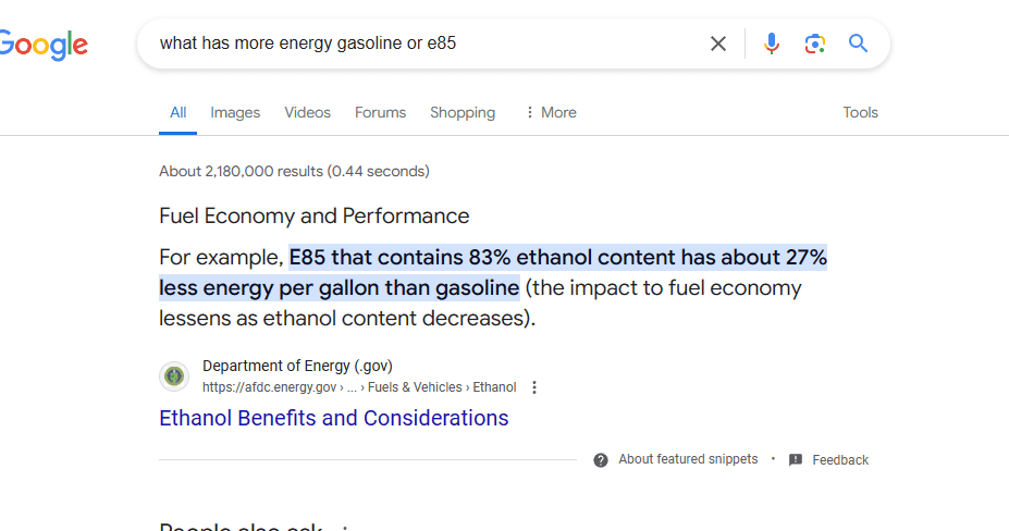

Ok I did.
Im curious, have you tested you theory?

no you didn't do it right.
do this math for ethanol and gasoline:
https://forum.hptuners.com/showthre...le-or-wasteful&p=735061&viewfull=1#post735061
gasoline = 18.4k btu/lb, gasoline stoich = 14.7:1
ethanol = 11.5k btu/lb, ethanol stoich = 9:1
at an airflow mass of 30 lbs/min:
ethanol: 30/9 = 3.3 lb/min of fuel * 11500 = 38333 btu/min
gasoline: 30/14 = 2 lb/min of fuel * 18400 = 37551 btu/min
it it putting more energy into the cylinder.
thats just at stoich its already making more power, when you go to power enrich it gets greater, because you can't enrich gasoline as much as you can enrich ethanol.
Ethanol makes more power than gasoline, all the time. This doesn't count for efficiency, the design of the engine will lend itself to being more efficient with one fuel over another. That's why it works so well on this engine, the engine itself works well with ethanol and you're getting the additional benefit of high octane. Ethanol is a twofold power adder. That's why its so good.
also its a percentage, so as you flow more air the absolute increase in power gets larger.
