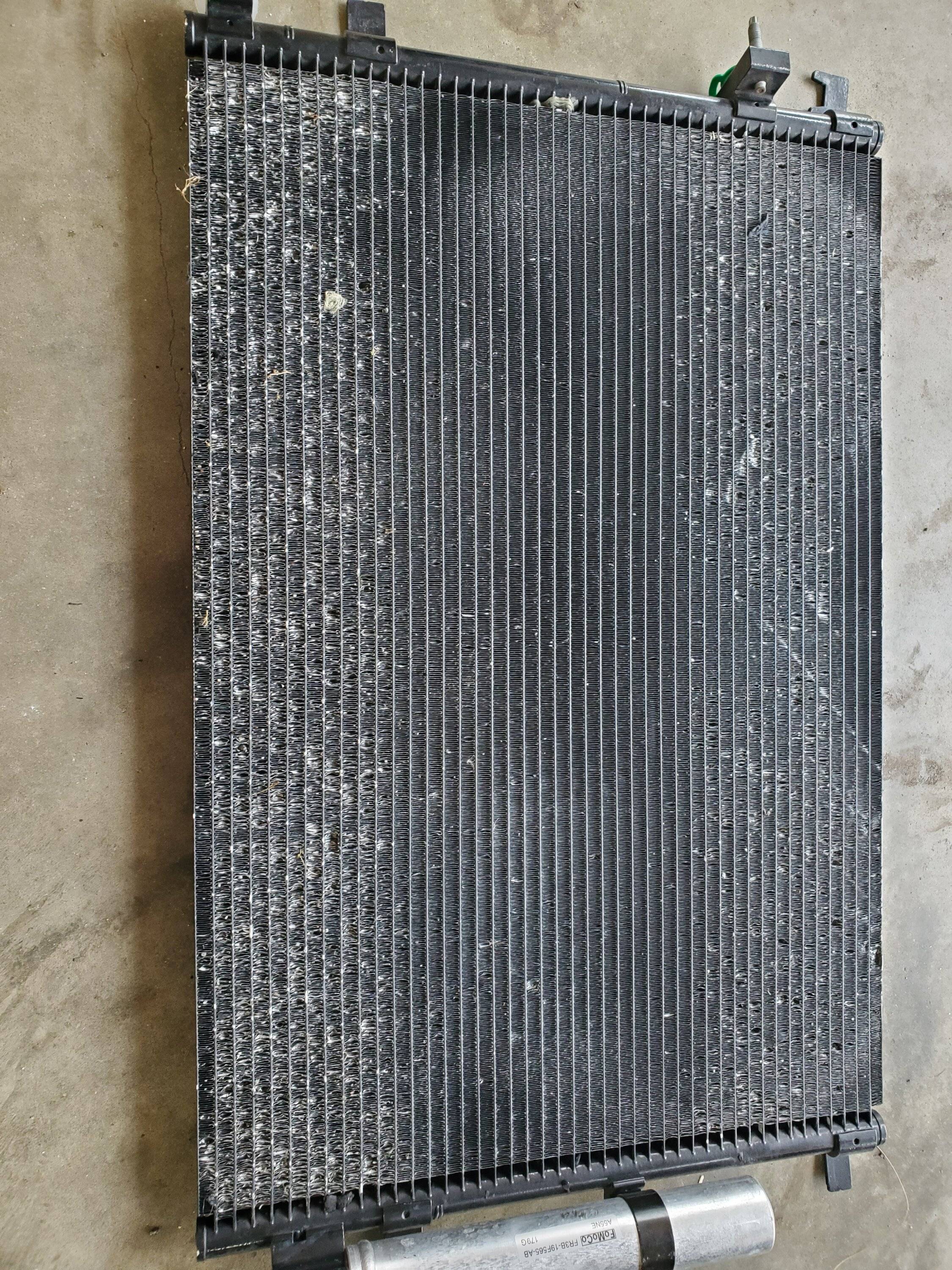

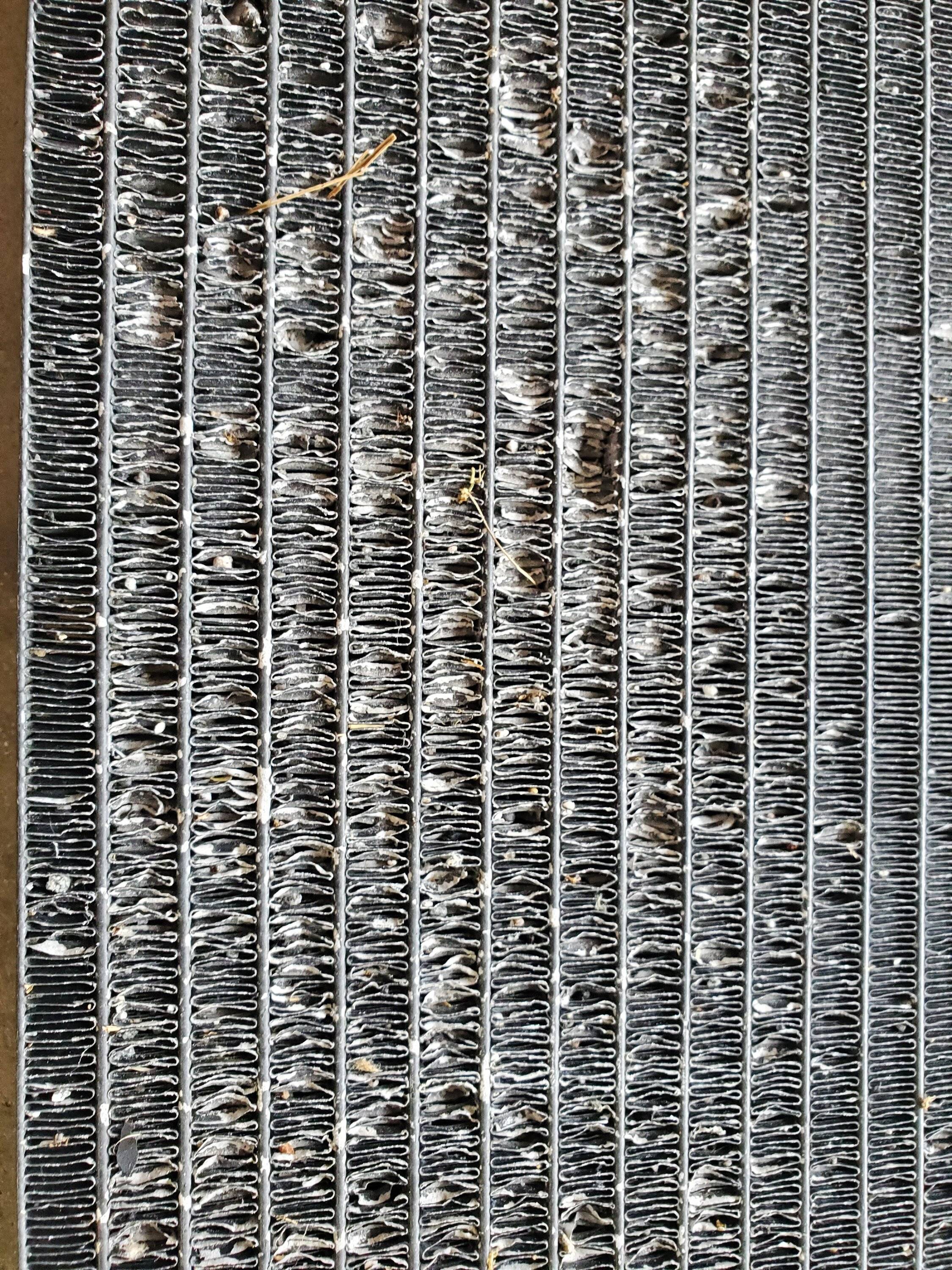

This was the condition of the condenser which prompted me to replace it.

Lots of shrapnel flying up from the track Iā€™m assuming. That seems like a lot of damage. Just wow.

Track? Nobody said anything about driving my car on a track. That would void the warranty....

I guess thatā€™s what 180 mph does to soft aluminium fins ā€¦ šŸ˜³
I bet you are happy with your decision for PPF / track armour now :wink:

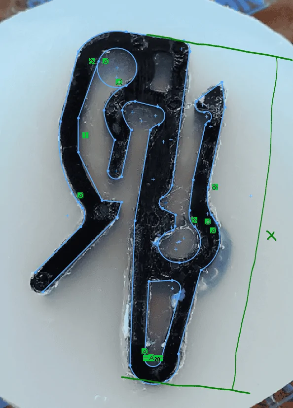

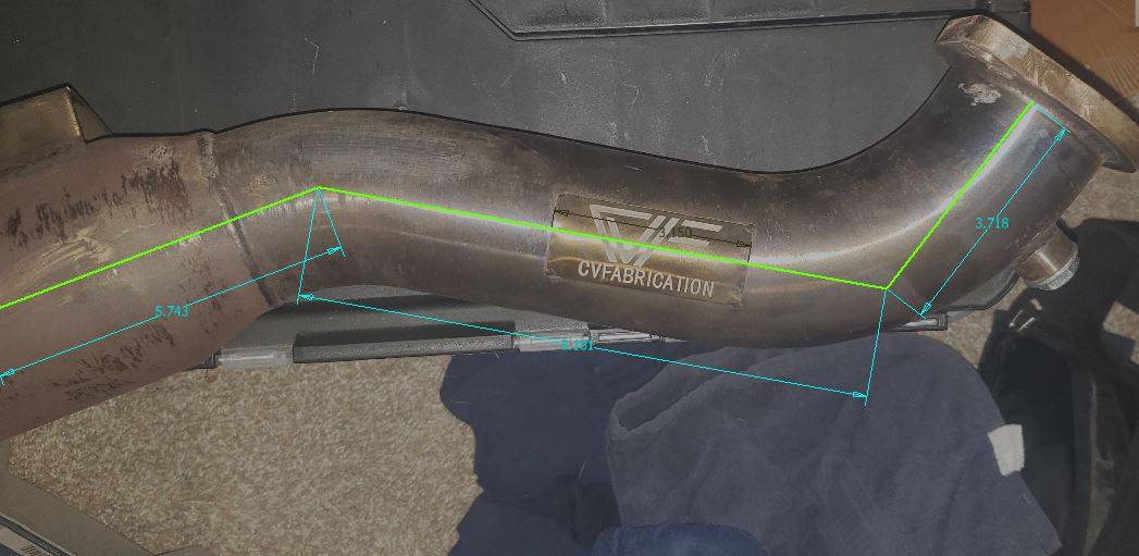

i would of taken a picture looking down through the part and then import that picture into cad and scale based off a known overall dimension. in my case i used the cvf plaque as my known dimension. granted this example has its limitations and i was just using it as an experiment
My CAD Kung Foo not so good.

187 to be exact

feel free to message me with an HQ picture looking normal to this face if you want a 3d model of it. along with a dimension i can use to scale it. i did this quickly

sorry, to be more clear. i need a picture of the original part looking down centered over the part, similar to how i have it shown, with the phone flat. i also need a length dimension like i drew with the green line, and also the part thickness.
