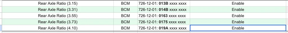

Are you sure about this? There is a place to designate the rear end ratio in the ForScan software.You won't have to change anything in the programming of the car. The Car will auto detect that ratio.

I was going to ask the same thing... Speed is read from a wheel speed sensor, so a gear change won't affect the speedometer, but I would have to imagine that the ratio is in there for a reason. On a manual car it might not matter, but I'm guessing it will be more important on an auto car.Are you sure about this? There is a place to designate the rear end ratio in the ForScan software.

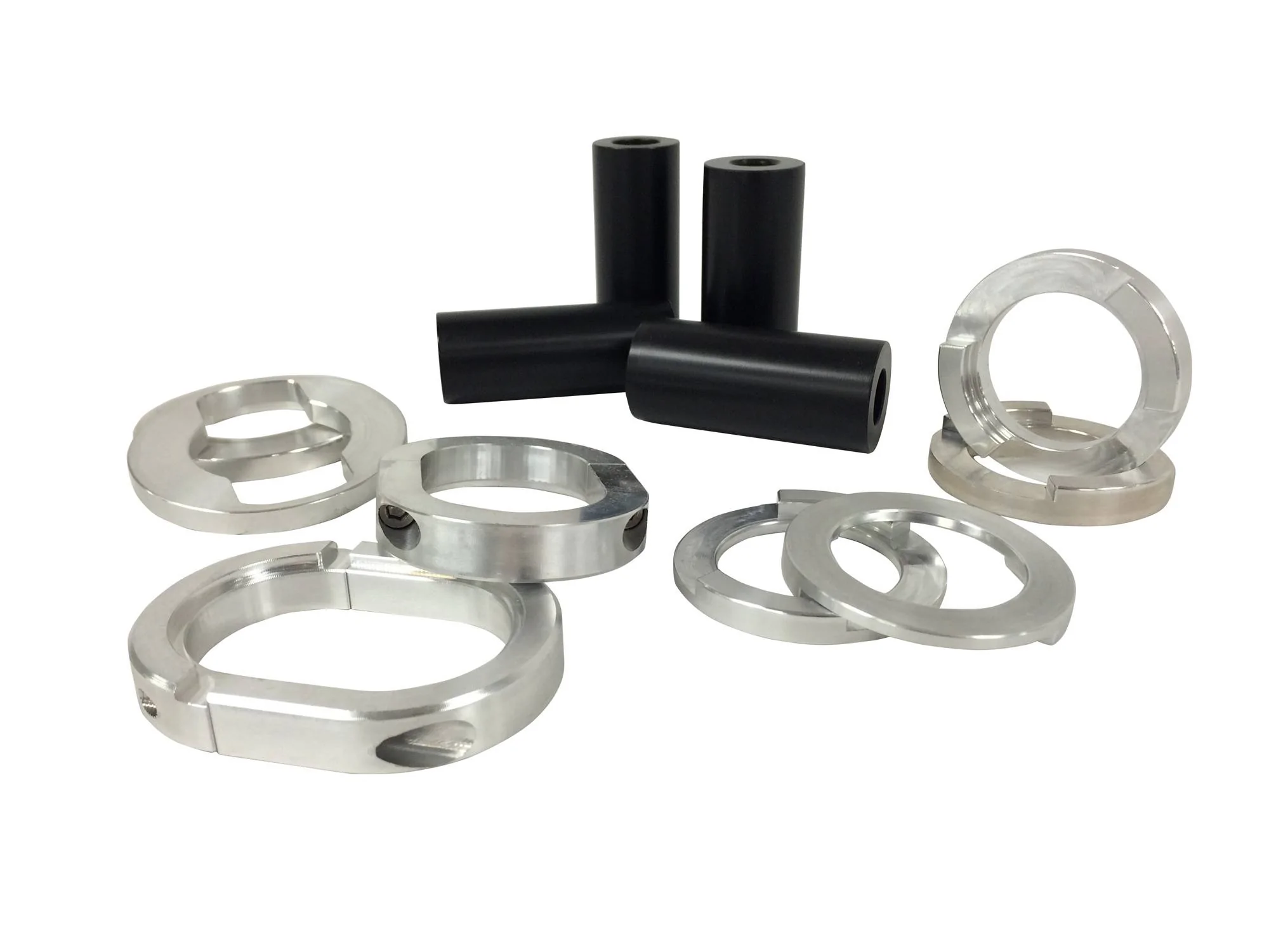

Great time for the steeda alignment and bushings kit to go in. I would definitely do that.Stop stop! =)

And if we're talking about the rear end in general, do we need to install bushings in the subframe STEEDA or is this a useless upgrade?
