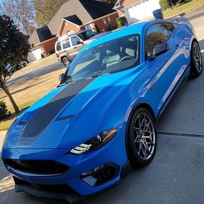

My almost new (<500 miles) y-spoke factory Mach1 wheels in 19x9.5/10 with new PS4s are also available.

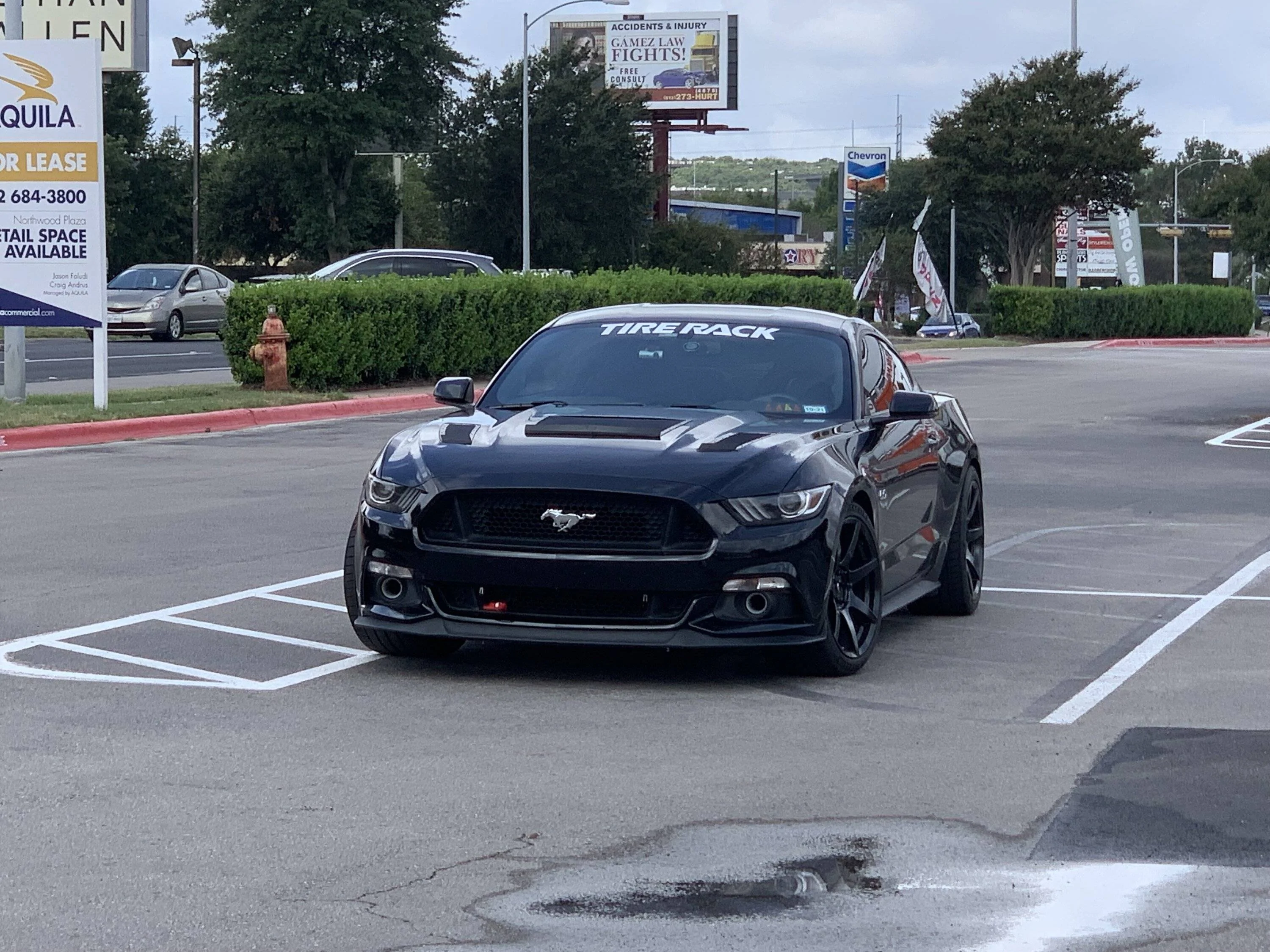

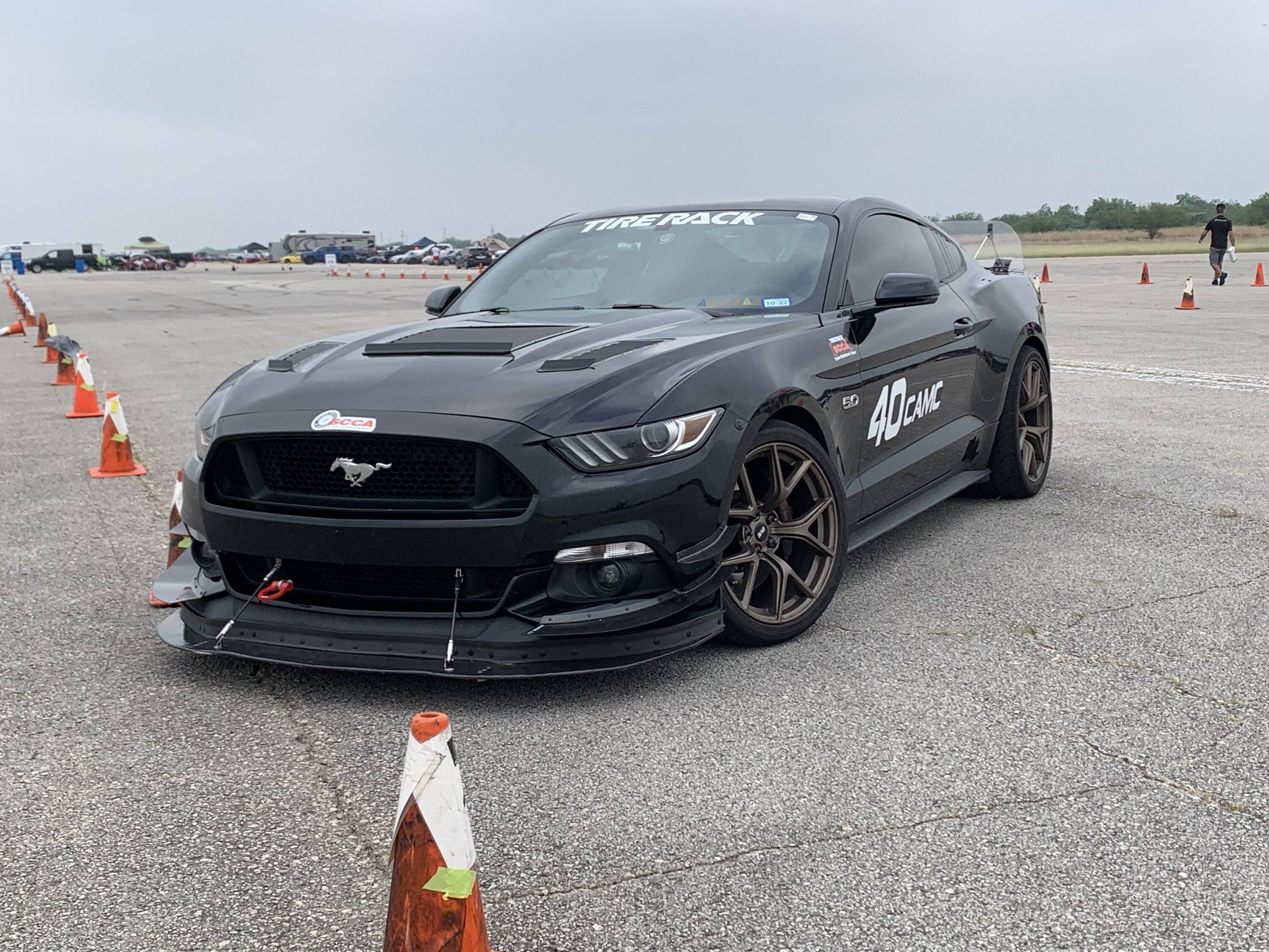

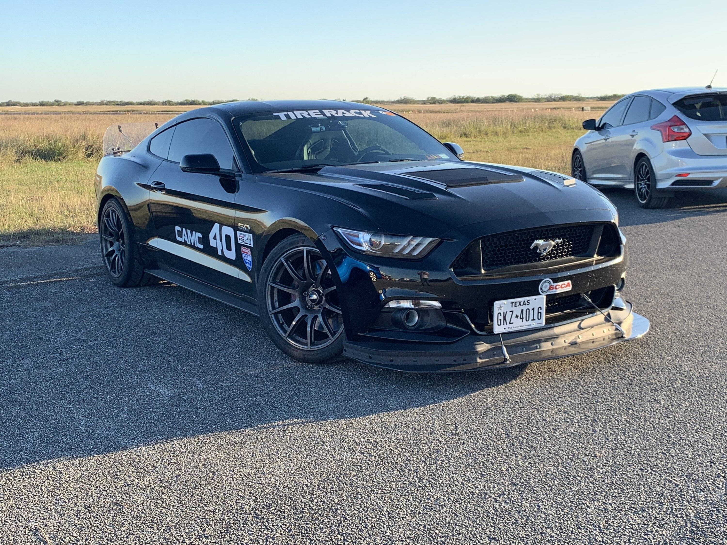

I daily drive my autocross mustang and don’t want wheels that will scratch up during DD.
should I go with Apex flow formed EC-7s, or SVE SP2/R357s?
I don’t want to spend a whole bunch just to scratch them up. I need a square 19x10 stance that can rock 285 Michelin Cup 2 Rs or 285 Michelin Pilot A/S
thoughts?

Either the Apex or SVE will be just fine. Depends on what style you like but either will work
