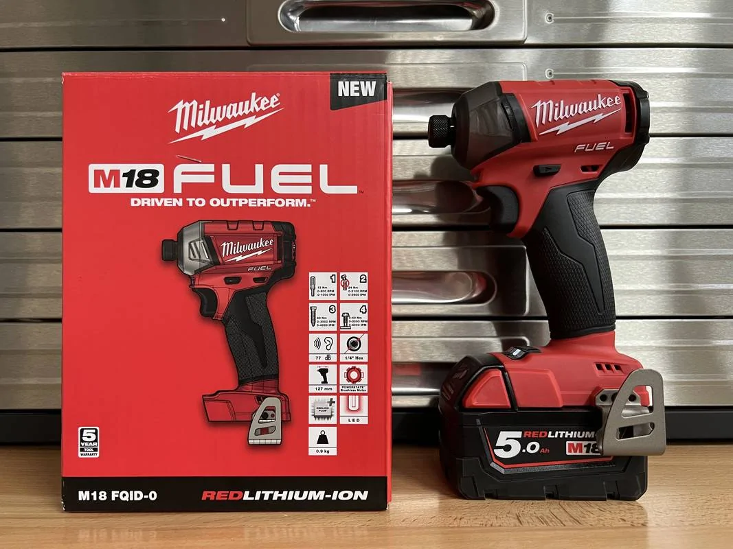

Got my first chance to use the M18 Surge today, making treated pine backing boards for Elkhorn and Staghorn ferns. Wow, this thing is so smooth, easily the best impact driver I have used to date. Granted, treated pine is not a great challenge, but I love how you can creep up on the fastener rather that pounding it into submission.

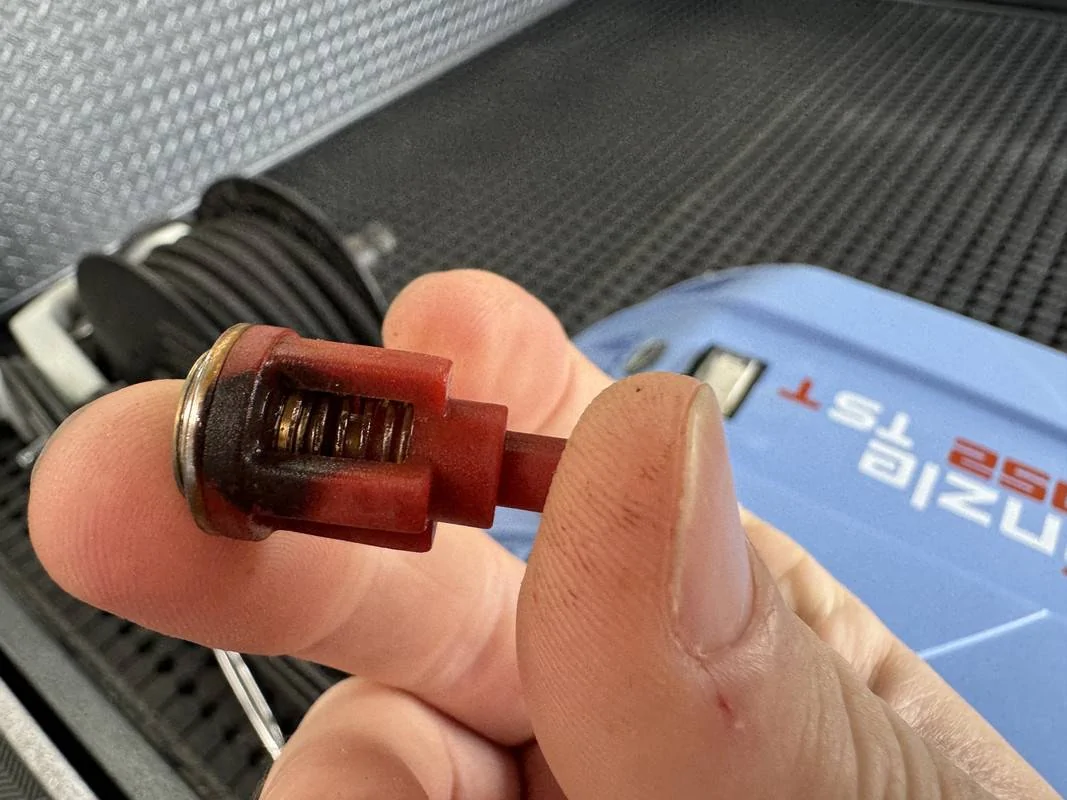

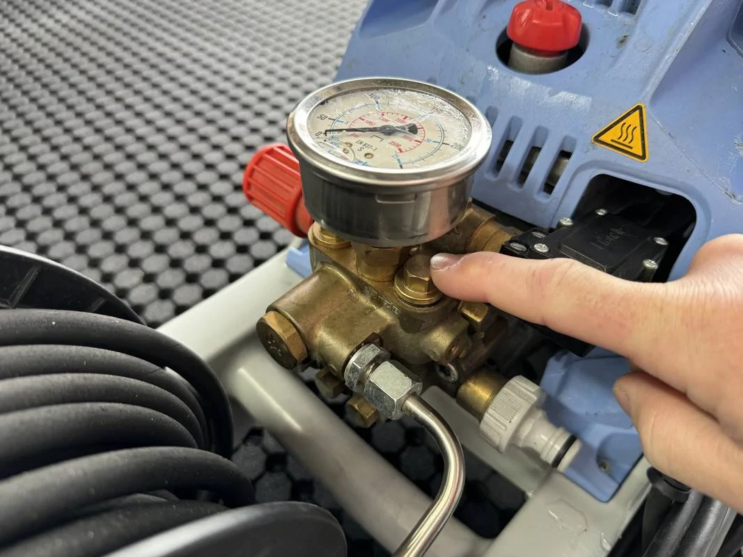

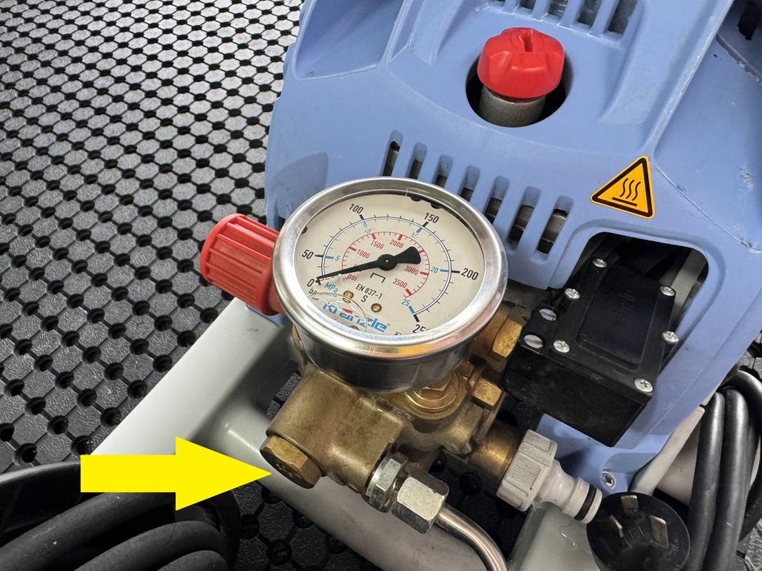

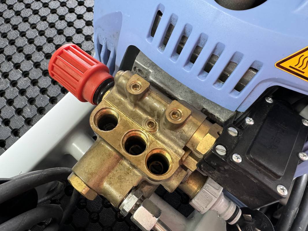

Kranzle Check Valve Repair / Service

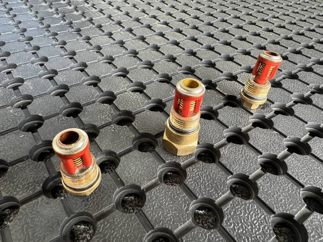

After nearly four years of flawless hard work, my German tank failed me last week. I bought this Kranzle K1152 TST (1122 TST in the US) in mid-2020, a sight unseen purchase that was a go-big-or-go-home type of deal. Apart from the stout water flow, low noise and high-quality construction, the main benefit of a Kranzle is the ability to service and repair these machines as needed. The pumps are fully serviceable or completely replaceable, a contrast to the throw away type of deal with cheaper pressure washers. The hoses, fittings, pressure gauges and oil are all replaceable as needed, even the electrical circuitry.
After sitting for more than 6 months unused, I took the Kranzle to work on Wednesday to wash the two delivery vans. I connected the hose and turned on the tap to purge the lines, but nothing came out. Apart from a tiny trickle, water was not flowing through the pump. I checked the inlet screen and the nozzles for blockages, but all was good on that front. I later discovered the glycerin filled pressure gauge was leaking fluid. I ended up having to wash the vans with a garden hose, further diagnosis would have to wait.

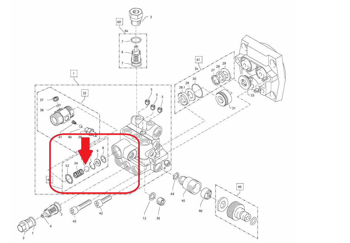

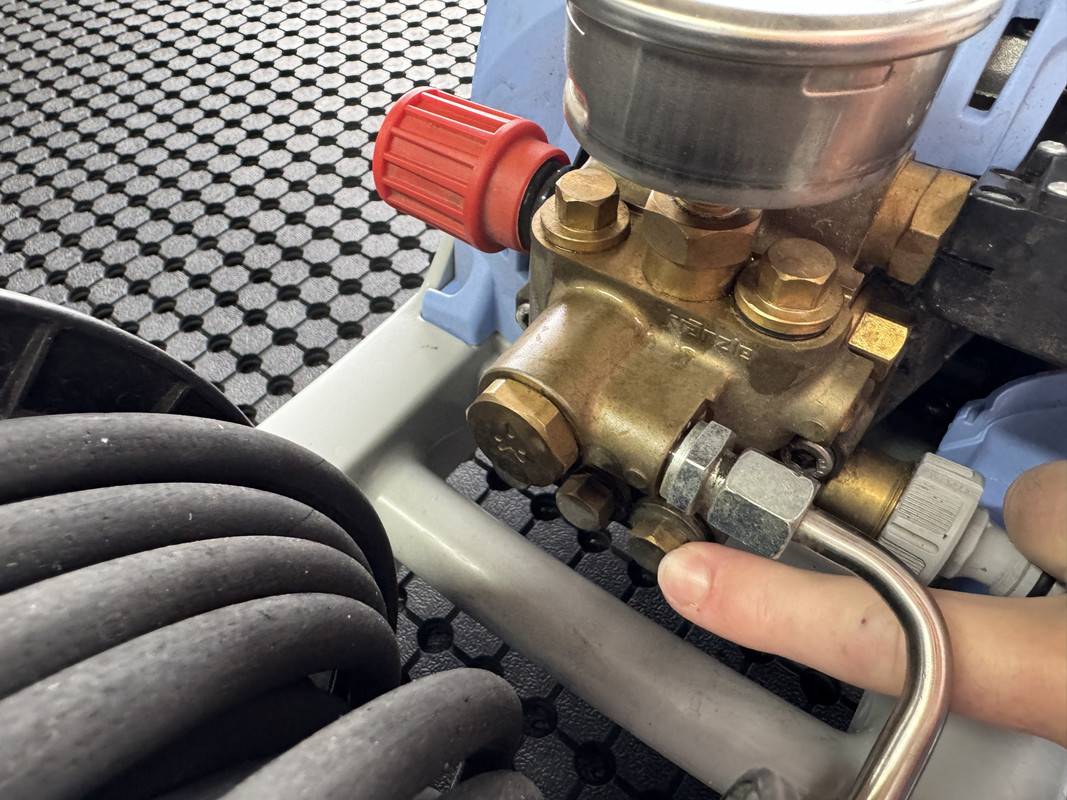

A quick Google and further discussion with PowerBlast, the Australia service and parts agent for Kranzle, the issue would be a stuck check valve, of which there are seven on the AZ pump. The first 6 valves are accessed by a brass plug, the exception being the valve below the pressure gauge, which needs to be removed to gain access.
Upper outlet valves -
Lower inlet valves -
The seventh valve is the final release valve and is accessed behind the larger cap highlighted below. This is not the same arrangement as the red plastic check valves in that the cap acts against a spring and ball bearing. The ball bearing can weld to the seat and cause a blockage. I actually removed this valve first but found everything to fine, the ball bearing free and clean.
It’s recommended to start by removing the three top (outlet) valves, of those the central pressure gauge and valve cap should be first to allow clear access to the outer two valves. The three lower (inlet) valves are then removed, starting with the two outer caps to allow access to the central one. Most will remove the hose reel for better access, but it can be done with it in place like I did here.
The first three outlet valve came out free and easy, the springs moving within the housing just fine. However, all three lower valves came out with the spring frozen to the seat. In this case, I mostly likely didn't purge water from the pump after use. As it sat for so long, the minerals in the water calcified around the spring and freeze it in place.
According to PowerBlast, the valves often free up after being removed, which was the case here. Using a pick, gentle pressure freed the spring from the seat, working it several times to dislodge any build up. I then followed by sprayed the valves with IPA and wiped them clean. I also cleaned each valve cap, including a light go over the threads with a wire brush to remove any thread locker used during manufacture. There are also o-rings at the base of each check valve channel, but I didn't want to mess with those.
To reinstall the valves, simply slide the valve back into the channel and replace the cap. Start with the central top valve and cap, then the two outers. You can then re-install the pressure gauge. The lower valves, again start with the central, followed by the outers. Despite what is shown in some of the below videos, I do not recommend using a power tool on these brass pumps, just run them down by hand until you feel resistance, then nip them up with a socket or wrench. It would be all too each to destroy one of these $1000+ pump housings by smashing a cap home with an impact gun.

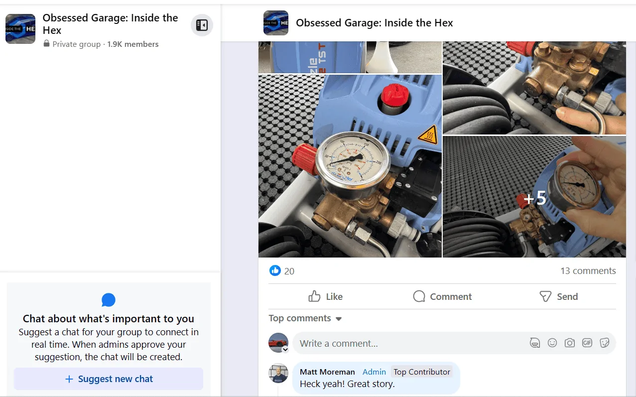

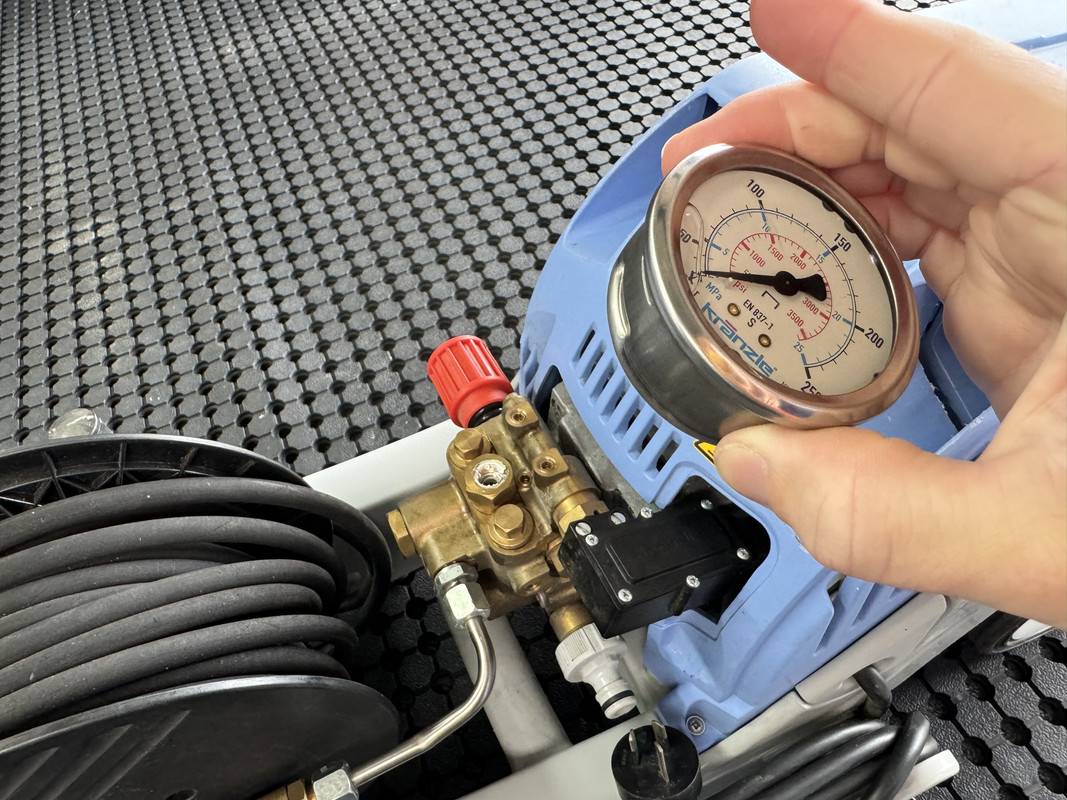

Once I had the pump back together, I went out and connected the water, purged the lines and then fired the unit up. Success! :rockon:
You will notice that the pressure gauge is not working, which I had expected. The bubble in the gauge is normal by the way. I have ordered a replacement gauge, along with a check valve kit which includes 6 new valves and 12 new o-rings to have in stock.
Check Valve Kit - 41.648
41648 - Repair Kit Valves AZ Pump | Powerblast Global Pty Ltd
Pressure Gauge - 15039
15039 - Kranzle Pressure Gauge 3625psi | Powerblast Global Pty Ltd
Through all of this, I discovered that PowerBlast have a distributor local to me. While they don't stock spares, they can get them in for me.
Normally, something like this would have freaked me out. In fact, Detailing Shed suggested I just send it to PowerBlast. If it was the plungers, from what I have seen they can be tricky to seat properly. But the check valves were a piece of cake. As such, I'm so glad I did this myself and learnt more about these awesome machines.

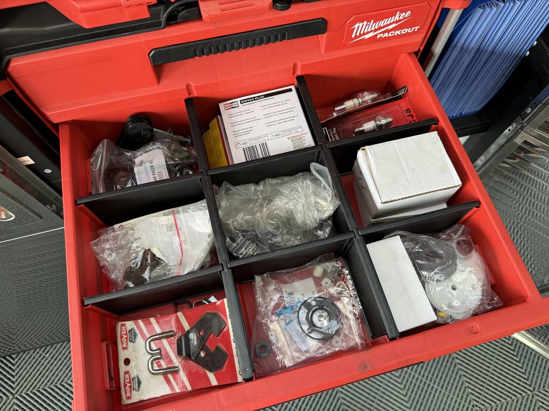

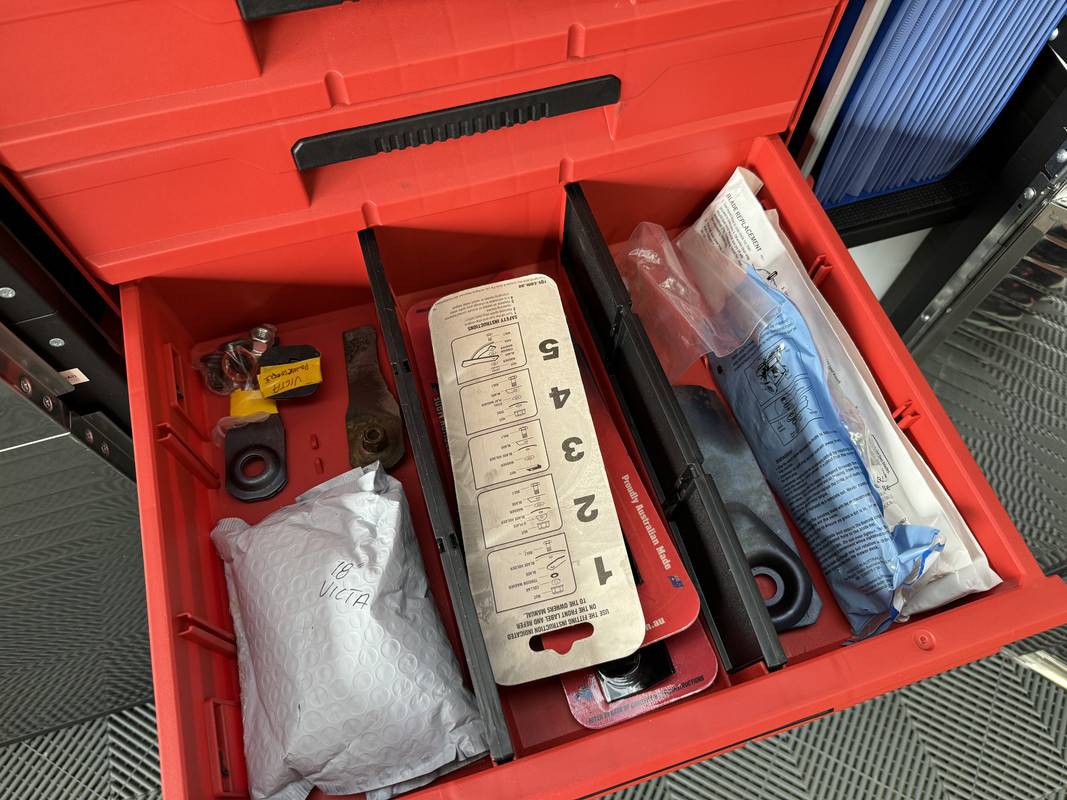

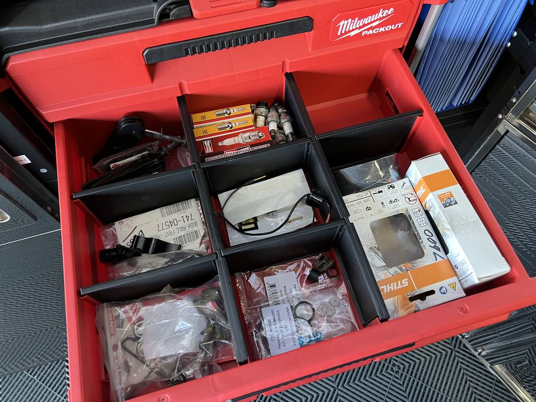

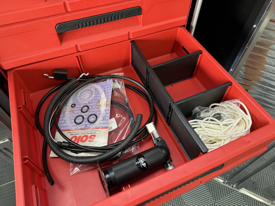

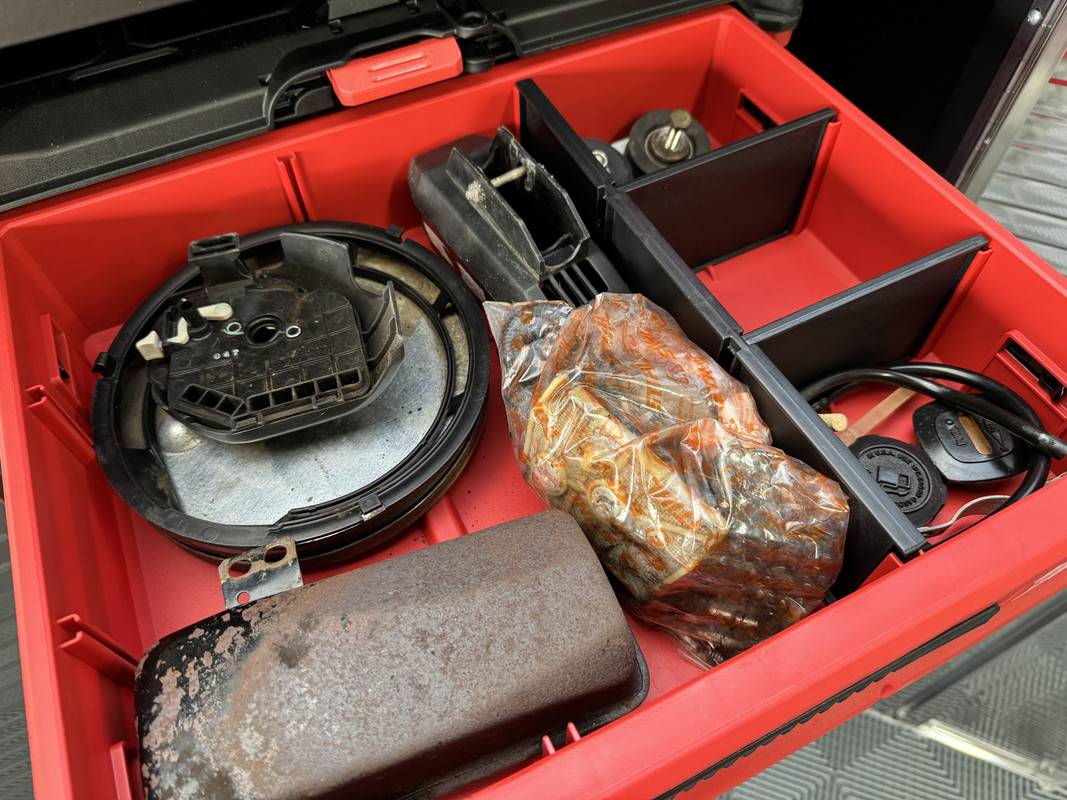

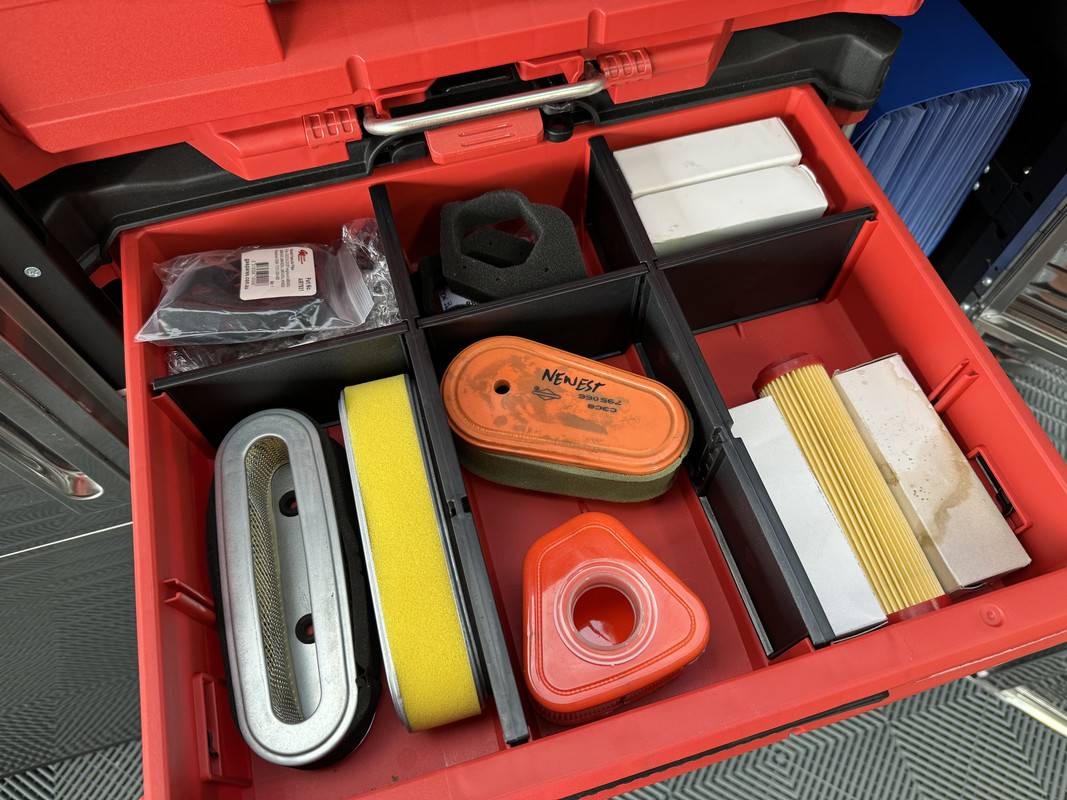

Expanding The Spare Parts Department

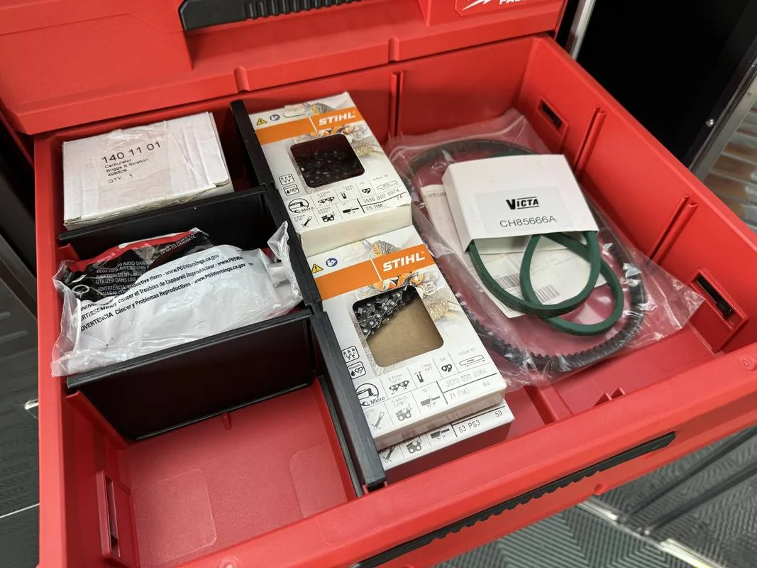

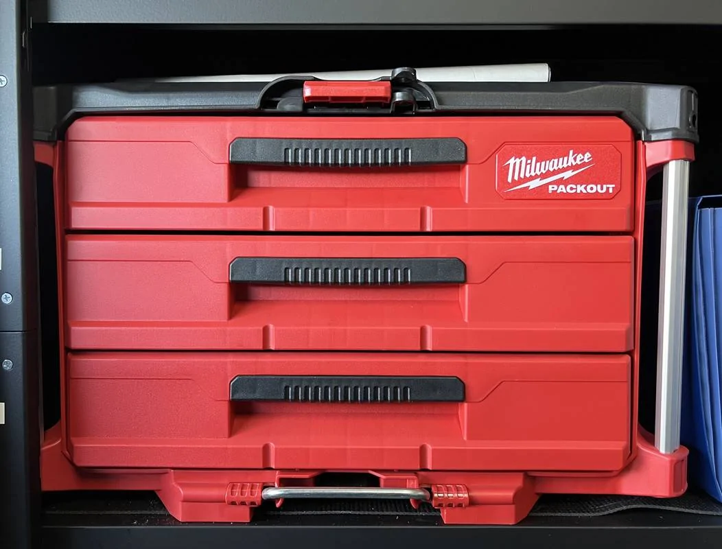

Last year, I bought a Milwaukee Pack-Out unit to store various spare parts for my equipment. This was set up within one of my cabinets, allowing it to be out of sight but still easily accessible.
https://www.totaltools.com.au/180066-milwaukee-packouttm-3-drawer-tool-box-48228443

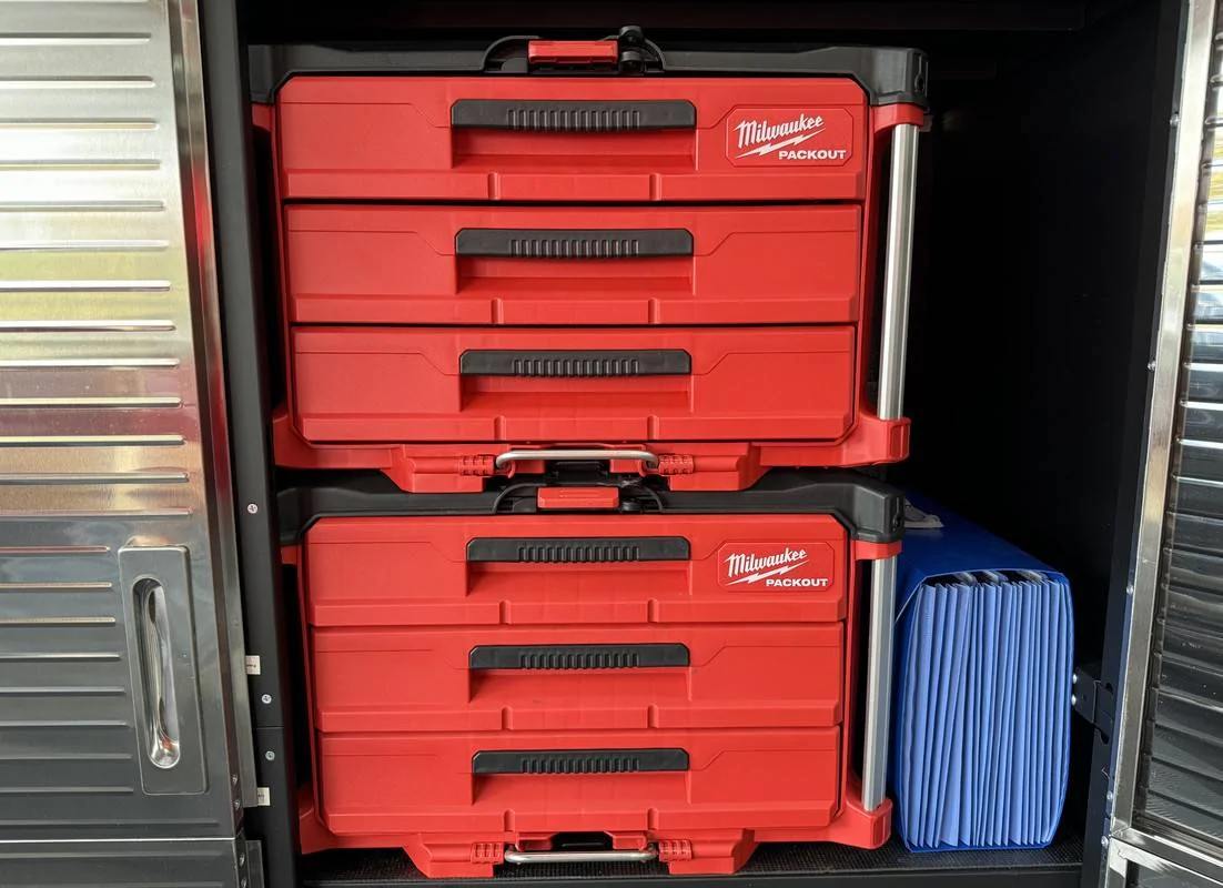

This setup has been working very well, but.........................I was running out of room! The beauty of the Pack-Out system is the modularity, meaning you can easily add to the setup and have it all lock together. So, adding another unit was a natural decision.
Milwaukee now offer 2, 3 and 4-drawer configurations, but I decided to stay with the 3-drawer unit. Because I had a store credit, I again bought this from Total Tools, but the same units at Sydney Tool's right next door are noticeably cheaper. That's strange because typically Milwaukee has their prices standardized from store to store.
MILWAUKEE PACKOUT™ 3-Drawer Tool Box | Total Tools
Milwaukee 48228443 PACKOUT 3 Drawer Tool Box (sydneytools.com.au)
Blades...................
Spark plugs, chassis and carburetor parts..................
Air filters.......................
Fuel line and starter rope.......................
Oil filters, chains and belts........................
Various used parts.........................
The blue folder sitting next to the drawers is used to catalog the various owner's manuals, ideal for quick and easy reference when I'm not in front of my computer.
Organizational Bliss! :like:

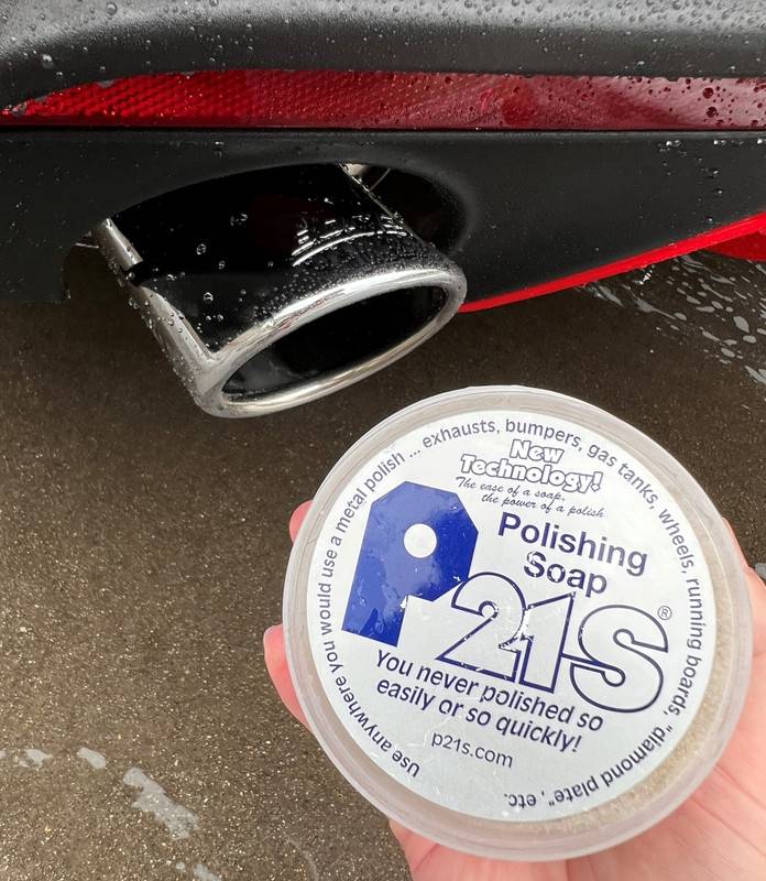

Capping off my day pottering in the garage, the Mustang got a "sanity wash".
The wheels and paint were cleaned using Opti-Coat M-Wash. I also gave the exhaust tips a once over with P21S Polishing Soap.
Get P21S Metal Polishing Soap Online | Waxit – Waxit Car Care
P21S Polishing Soap | Metal Polishing Soap | Obsessed Garage
After drying, glass, tyre dressing, interior wipe down and vac, I went over the exhaust tips with two layers of Dr. Beasly's Metal Coat.
Dr. Beasley's Metal Coat | Ceramic Metal Coating | Obsessed Garage

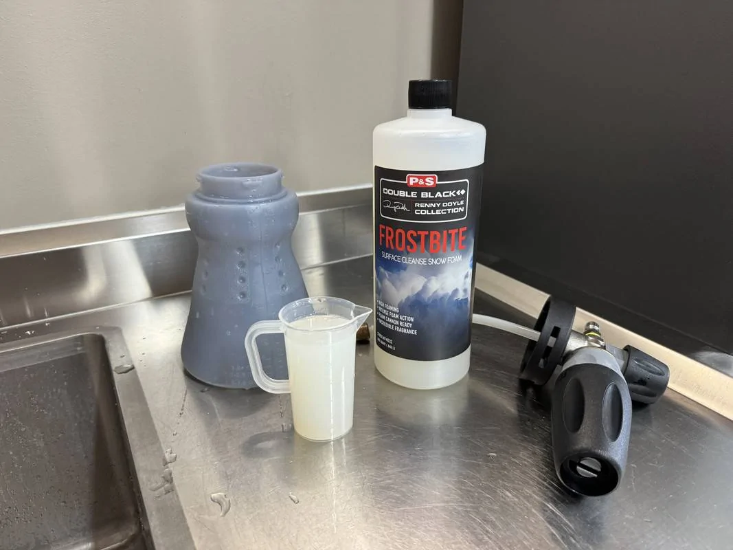

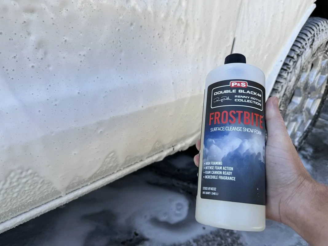

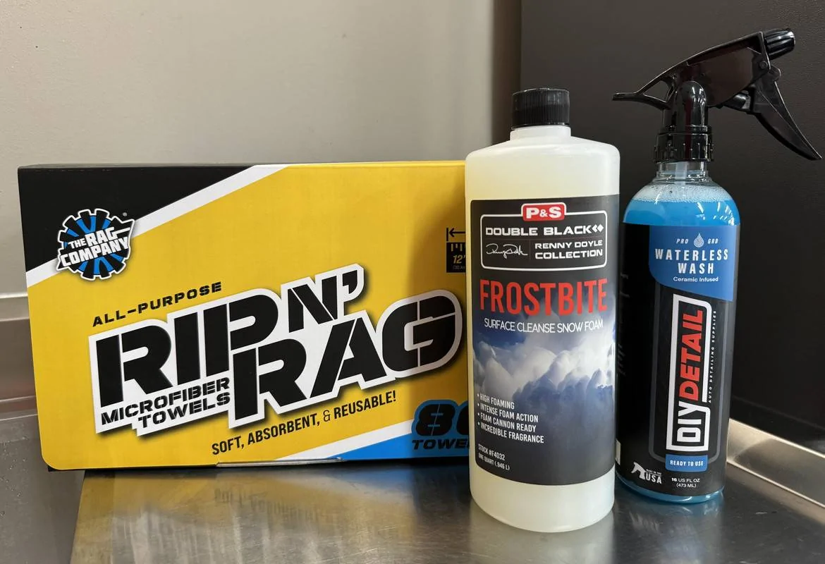

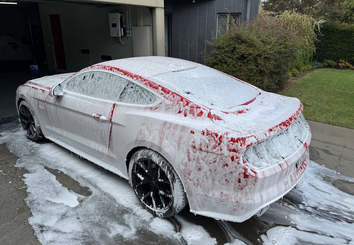

I then had a delivery arrive from CarCareCo, of which the bottle of Frostbite was only unveiled in the USA this time last week, so it's quite unusual to get a just released product so soon in Australia.
Shop P&S FROSTBITE SURFACE CLEANSE HIGH PH SNOW FOAM - 946ML Online - CarCareCo
Frostbite Surface Cleanse Snow Foam – The Rag Company
Compared to the runnier Pearl and Radiance from P&S, Frostbite produces much thicker foam for extended dwell time. It's also an alkaline soap, with the pH quoted as being 9.9. Scent is Eucalyptus Mint. The DIY Waterless Wash is something I have been wanting to try for a little while now.

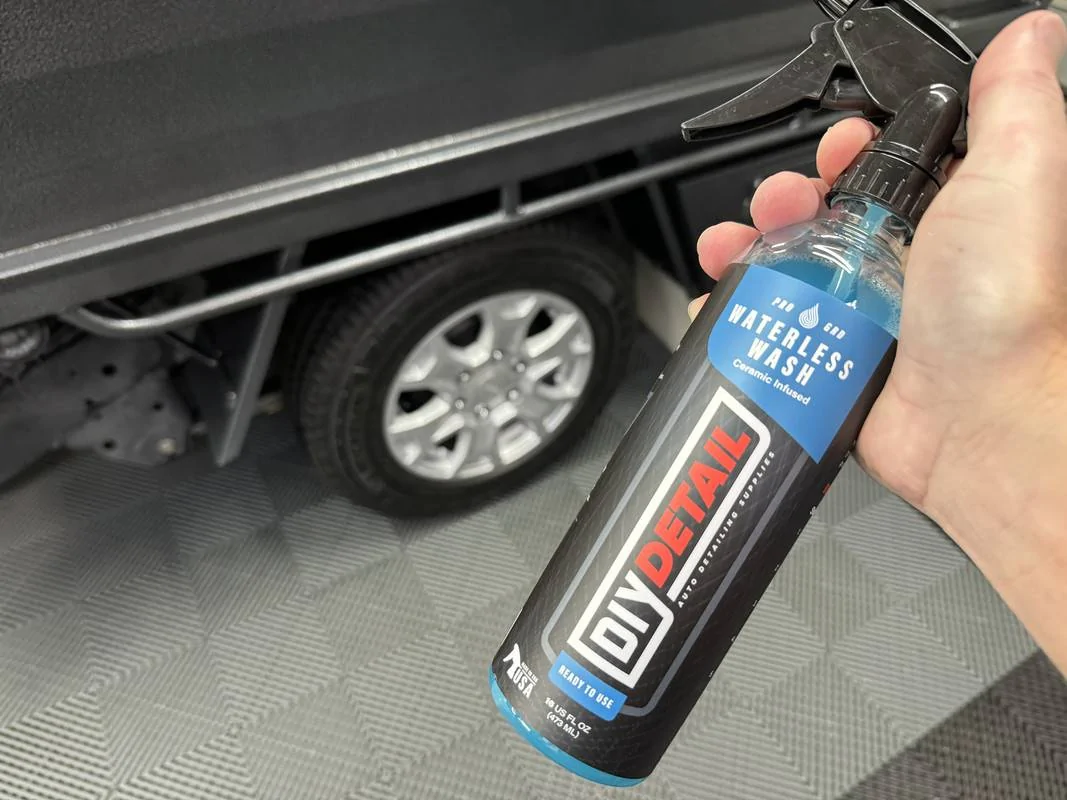

Shop DIY DETAIL WATERLESS WASH - 473ML Online - CarCareCo
Waterless Wash – DIY Detail
The concept of the Rip-n-Rag is not a new idea, I've had bulk towels like this before. However, the point of difference with The Rag Company offering is the quality. Despite the low 190 gsm and the multi-purpose job description, the 70/30 blend delivers a quality towel at a low price. For perspective, an 80-count roll delivers a per towel cost of 0.87c AUD, or 0.37c USD. Instead of using shop or paper towels, I like to use this sort of towel for checking oil, machine maintenance, oil changes, polishing exhaust tips, adhesive removal...................
Shop THE RAG COMPANY - RIP N' RAG - MULTI-PURPOSE MICROFIBER TOWELS Online - CarCareCo
Rip N' Rag - Multi-Purpose Microfiber Towels | The Rag Company

Very nice. Firat time I have heard of Frostbite. I did order a bottle of M wash, it should be here today (among other things) from the Rag Co where I ordered some stuff during their 25th anniversary sale. I also LOVE the Rip N Rag, I bought a small roll and just got a larger roll, they are extremely handy and as you said, suprising good quality. DIY Detail Waterless wash I love to keep in my detail kit in the trunk (boot), is really handy for emergency touch ups (mainly bird bombs :) )

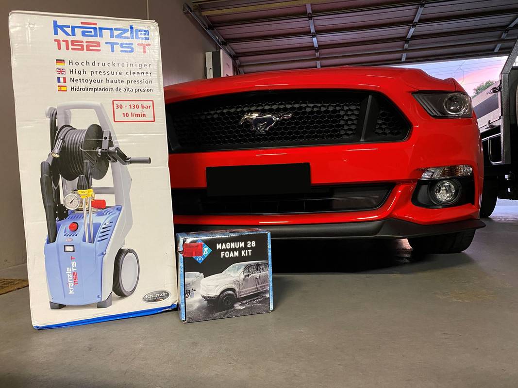

<grinning again> The "1152" confused me, amigo, and I spent ten minutes searching for one only to finally realize that it was a typo. <wink>
Kidding aside, I went through the same matrix of questions and it looks like we both purchased the 1122 within just a few months of one another. :=)
..the main benefit of a Kranzle is the ability to service and repair these machines as needed.
Like minds think alike. <BSEG> After many years of using cheap, chineeze PW's, I was fed up with throwing them away after a year or two and the serviceability of the Kranzle products convinced me to lay down the cash and SO glad I did.
I too had an issue that caused me to remove the plunger, spring, and bearing. Tricky little bunch of parts and I did have trouble getting it to seat which required multiple re-install attempts.
I WISH I had found Pump Saver YEARS ago, D, and I'll bet you do as well. Chances are, some of my pinko commie units might have run longer.
Call me crazy but, I love seeing the Pump Saver solution come out of the wand after I hook it up, it gives me piece of mind. <grin>
Boy do I ever like those boxes and I think I need at least three but damn, Milwaukee is proud of their plastic! I believe that I will shop for comparable storage units first before handing over almost 250 beans.
<smiling> I too have a collapsible folder with manuals but I HAVE to get another cabinet, mine is beyond completely full. <laughing>
GREAT post, D, and thanks SO much for the Kranzle pump rebuild kit gouge. Hopefully, I ordered the correct part number from Kranzle's distributor here, DirtKiller. Part numbers match so I hope I didn't screw up as usual and order the wrong item.
However, I could not find the AZ-L pump part number on the pump itself. Granted, I didn't disassemble anything for a better view, do you happen to know where the stamp is? Instead, I took the end around approach and searched for it referencing the 1122 and saw that it does have the AZ-L pump so I ordered the valve rebuild kit, Dirtkiller PN 9741648.
My OEM gauge also failed last year (internally, no leaking,) but I didn't want to pay Kranzle prices <grinning> so I picked this one up instead. Works fine.
They sure do! I like them because they have proper drawer slides so they open smoothly.
Either of those will be fine. The 41.648 kit will fit the K1152 and K1122 mobile units, as well as the static KHD-7 and KHD-10 / 1322 and 1622.
Wish I had spotted that before ordering the OEM gauge, although I got it at wholesale cost.
