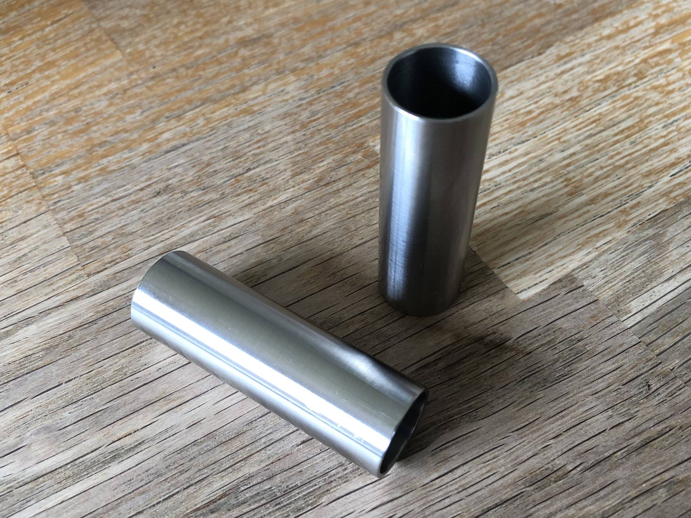

With regards to the size of the hole I might be able to help - I have some bolt sleeves in the garage and I’m pretty sure they are 16mm OD :like:
