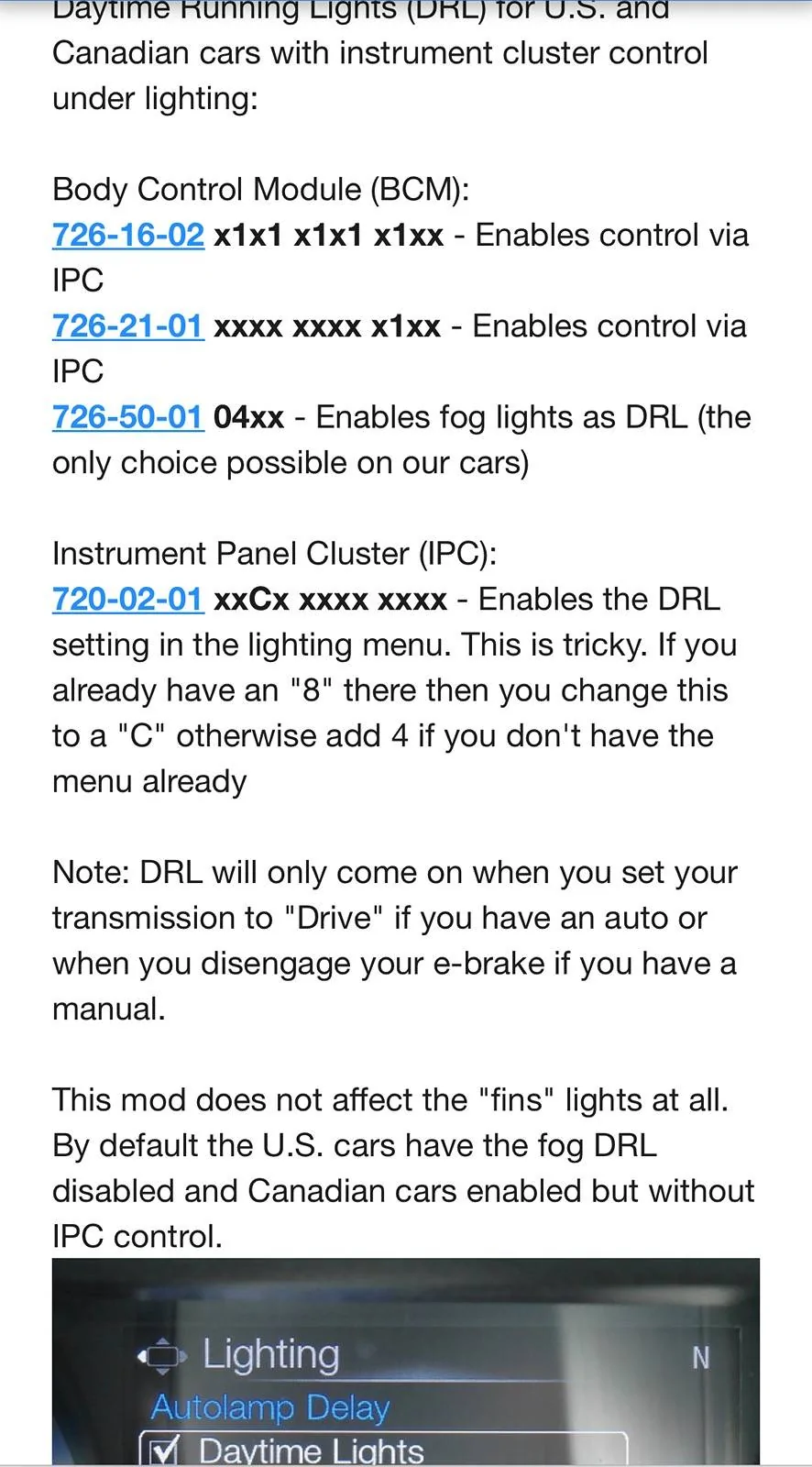

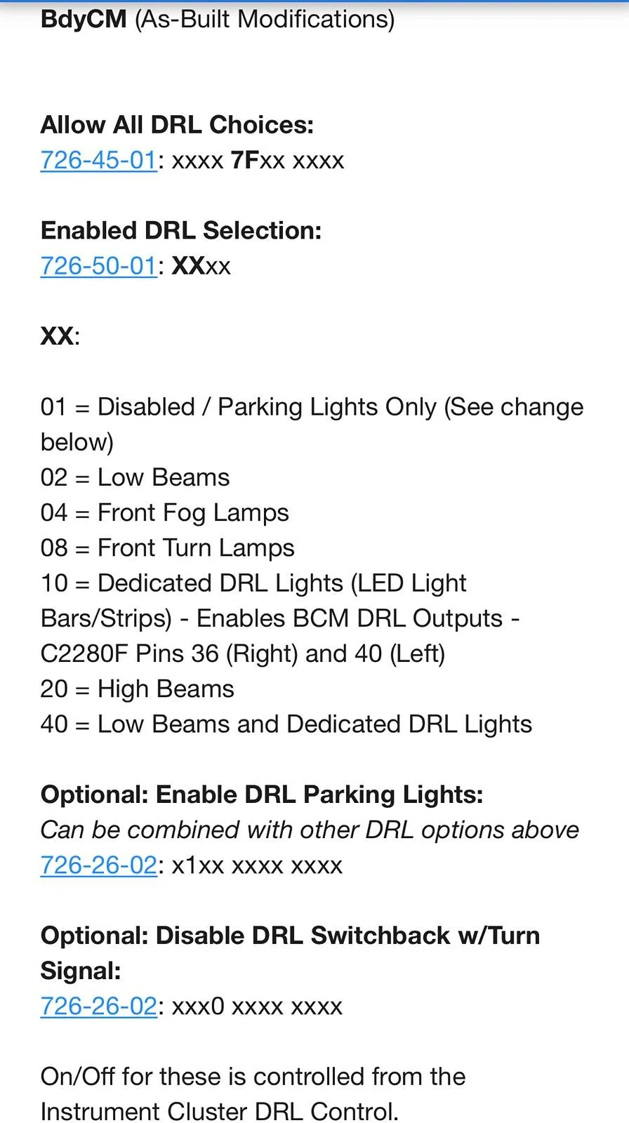

My OBD connector showed up today so logged into ForScan; changed about 3 different DRL settings and then also had to change headlight switch setting.
now everything works as it should normally, DRL is the tribar lights and nothing else and all the other lights operate as normal with the switch.

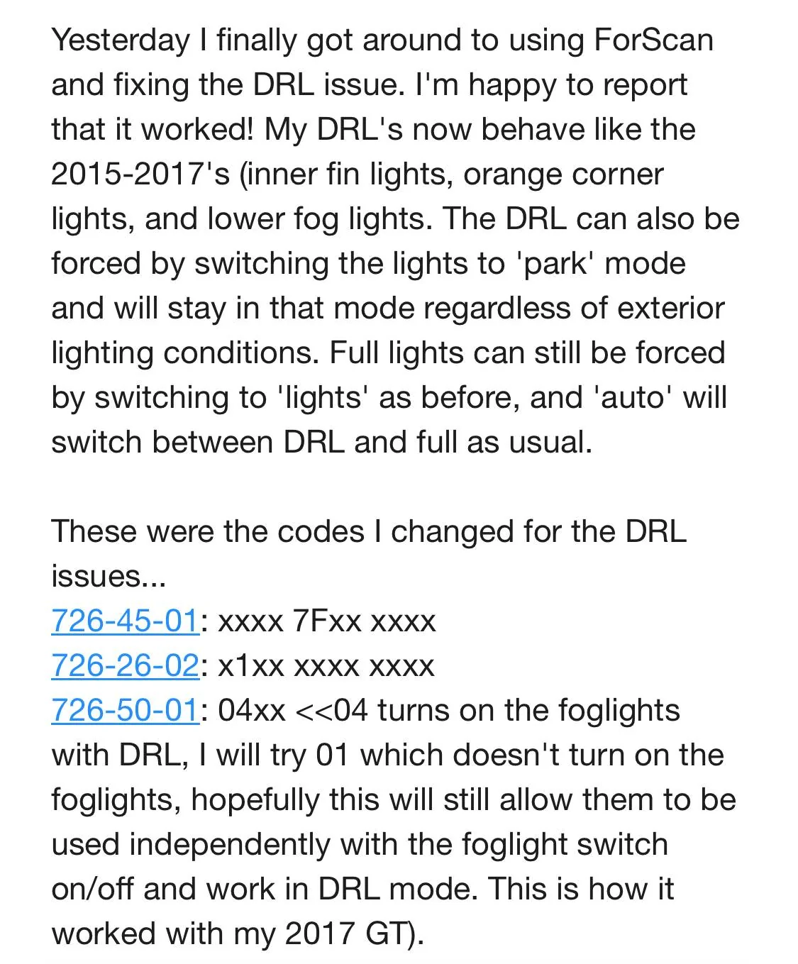

Now we have 12” of snow forecasted over the next couple days so car will stay in the garage…
Ordering a forscan soon! do you mind sneding/posting the codes that you've changed aswell to leave only the tribar is drls? I traded in my american eco for a canadian GT and the always on headlights bothers me lol!
