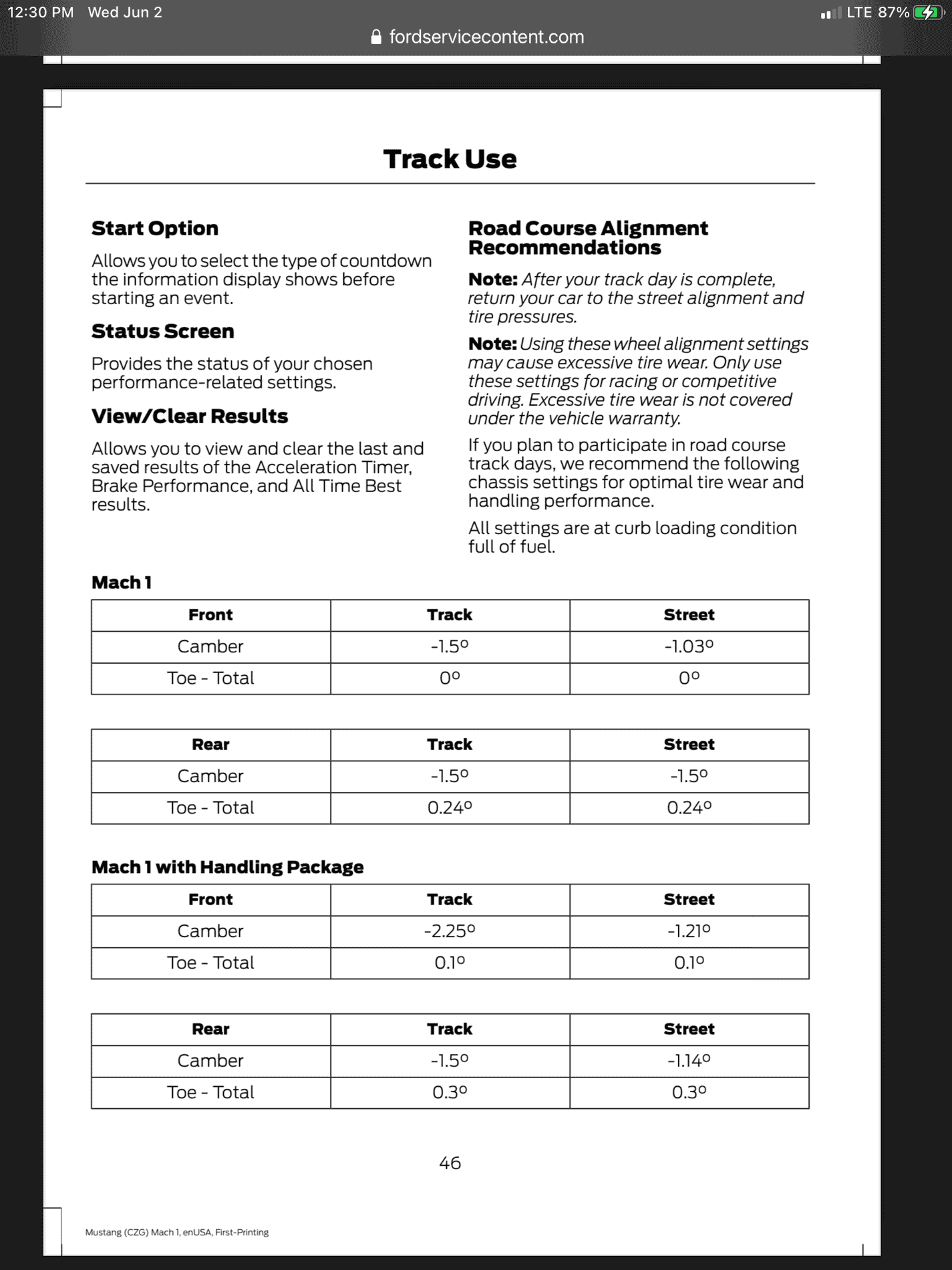

The engineering teams have different performance goals
would this also explain why the GT350/R recommended track setup incorporates negative toe for the front, while the Mach 1 utilizes positive toe in front?
I do not disbelieve you in any way- but just out of curiosity, how did you acquire the alignment specifications of the Mach 1?

I do not disbelieve your in any way- but just out of curiosity, how did you acquire the alignment specifications of the Mach 1?
[/QUOTE/
sorry, I know this is a crude way to show you. Not very good with links.
