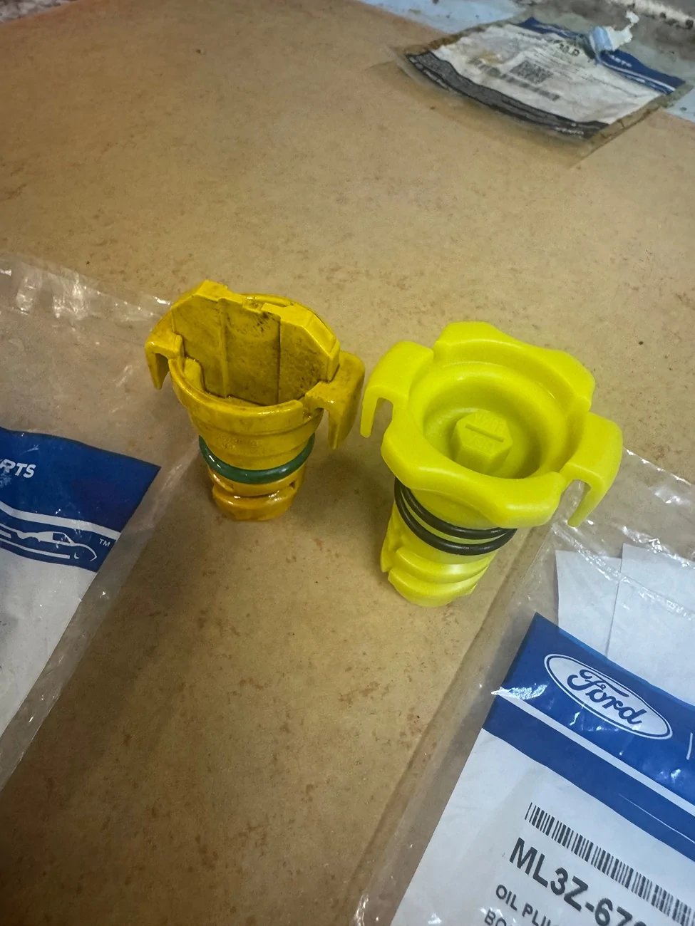

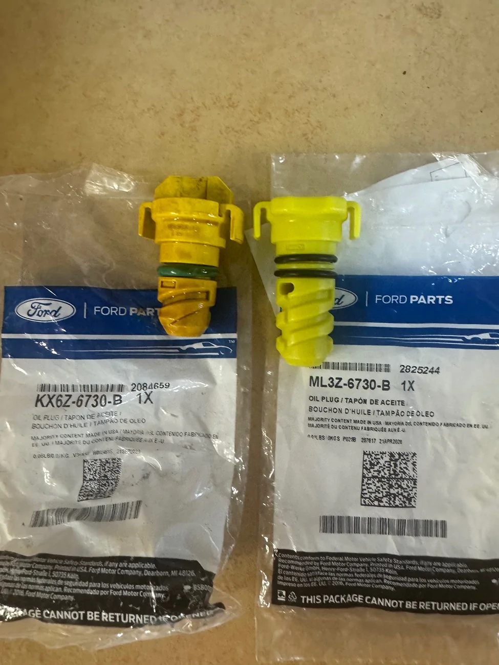

I picked up some new drain plugs from my Ford dealer and they are a different design with two black o-rings instead of the single green one, a longer twist in connection, and now using a small socket to remove instead of a flat pliers. Both have the same base part number 6730 and he verified it in the Ford system by the VIN and by the Engine type (5.0 v8). So I have two questions: Has anyone used this revised design yet? And how do you replace the plastic drain plugs every time the oil is changed or do you reuse them?

The slot and hole appear to allow you to loosen it and drain the oil in a controlled fashion through a smaller hole before taking it all the way out and having a wall of hot oil gush out. I'm going to have to order one.
Wow that is a very observant comment from the photos. The drain hole and slot would be a nice feature to replace my skill at holding the old style plug in place to regulate the outflow while draining!

I noticed the change in drain plugs when I did my last oil change a month ago. I thought the dealer gave me the wrong plug so I reused the old one.
I don't understand though, why they would use different o-rings. I'm not talking about 1 vs 2 o-rings, but the change in color. As I understand it, the green o-rings are for higher temp for fuel/oil, while the black orings are for general use and not for high temp situations.
I also have a UPR dp, but I can't stand that they charge $20 for 2 o-rings, and they are black o-rings not the original brown o-ring.

They can make an o-ring any color you want, regardless of the base compound. It could be Ford saved a few pennies by using something off the shelf. I agree black is the most common color you see.

Yeah they can make orings any color, but why not do it right and make orings the color they are designed for. That is the whole purpose of color coding orings, so one can differentiate what they are designed for.

I just used the new plug about a month ago. The design is supposed to allow you to remove it either by hand, with a hex wrench, or a slotted screwdriver. I like the double o ring design. I use them for three oil changes, and then replace it for the hell of it. Don’t know if it’s necessary, just figure why chance a leak.
