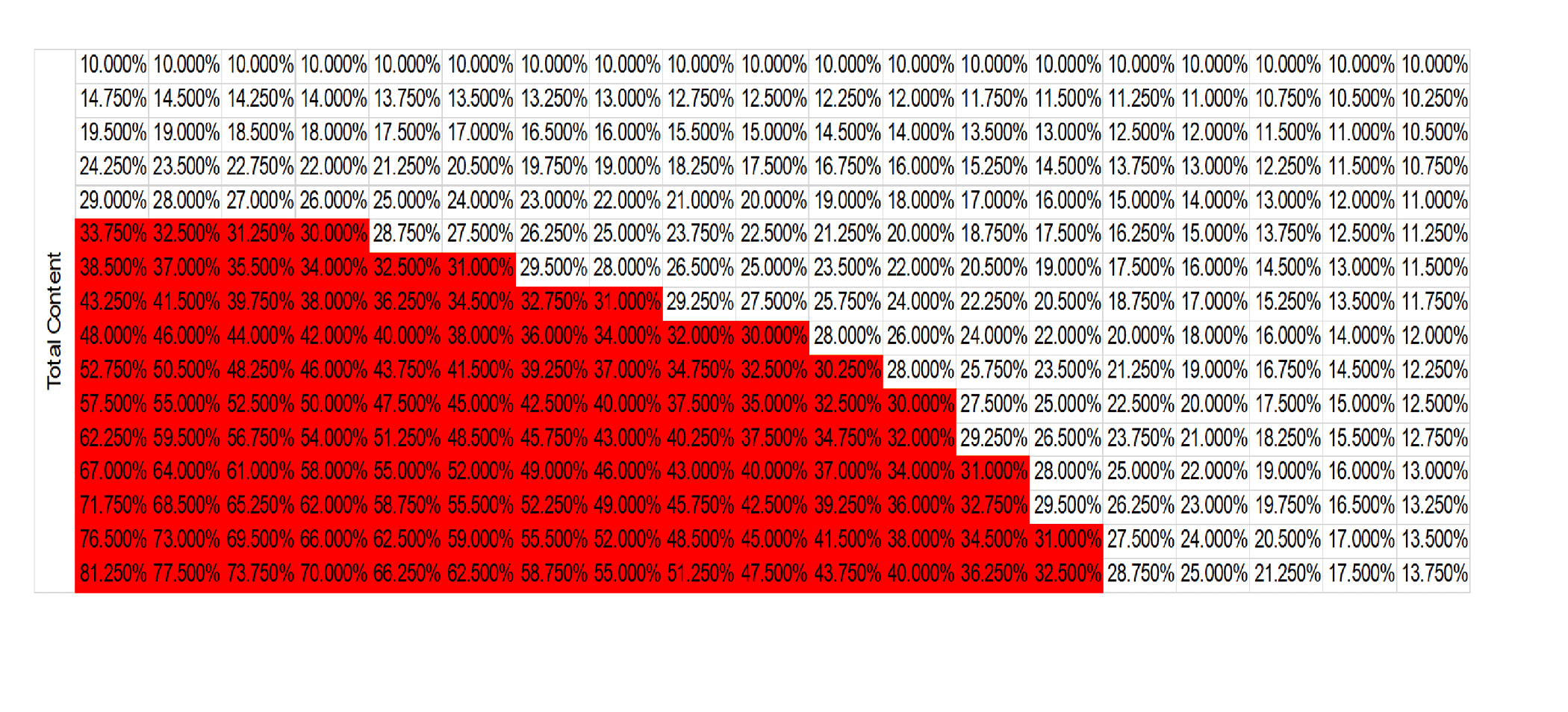

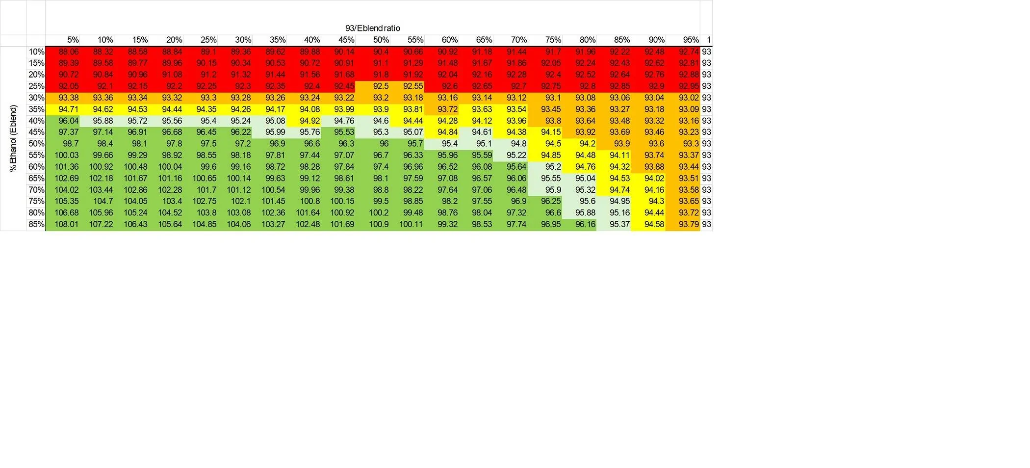

This will be a long post but I'll do my best to be succinct.
First, there's this misunderstanding out there that ethanol blends are all the same. The reality is, the E10 blend you get with 93 is different than the E10 blend you get with 87. Furthermore, much of the time, the "E85" blends you get are ethanol mixed with trashy 85 octane.
This has impacts on the octane ratings resulting from different mixtures of pump 93. What does that mean? It means that in certain parameters, it's BETTER to mix pure E85 with a higher ratio of pump 93 than it is to mix a lower amount of 93 with a low grade ethanol blend.
As you can see, blending quality 93 with trashy low grade ethanol blends (which have 85 octane as the remainder component) isn't always the best solution.
From the snippet of the chart, the red are eliminated as a reduction in total blended octane. The orange are highlighted as a "not really worth it" section where you're getting a slight octane increase but it's not really worth the brain damage and hassle of mixing your fuel.
The yellow are 94 octane (a slight improvement) but again, not exactly moving the needle. The light green is 95 octane where it starts to really create noticeable benefits worth the exercise. The solid green are 96+ where it's obvious those are meaningful and should be worth the effort.

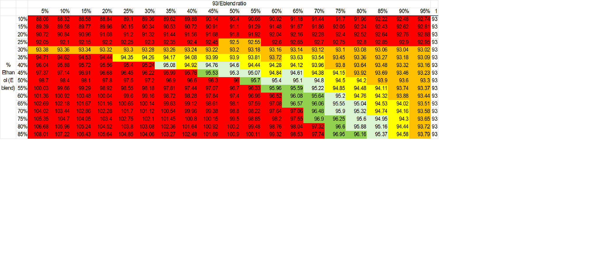

Now let's examine the "limits" for an untuned system. If we set a 30% octane content as the max we should run without unacceptable fuel trim adjustments, the constraint shaded results with this:
If we eliminate these from the original table (or overlay) the result is this:

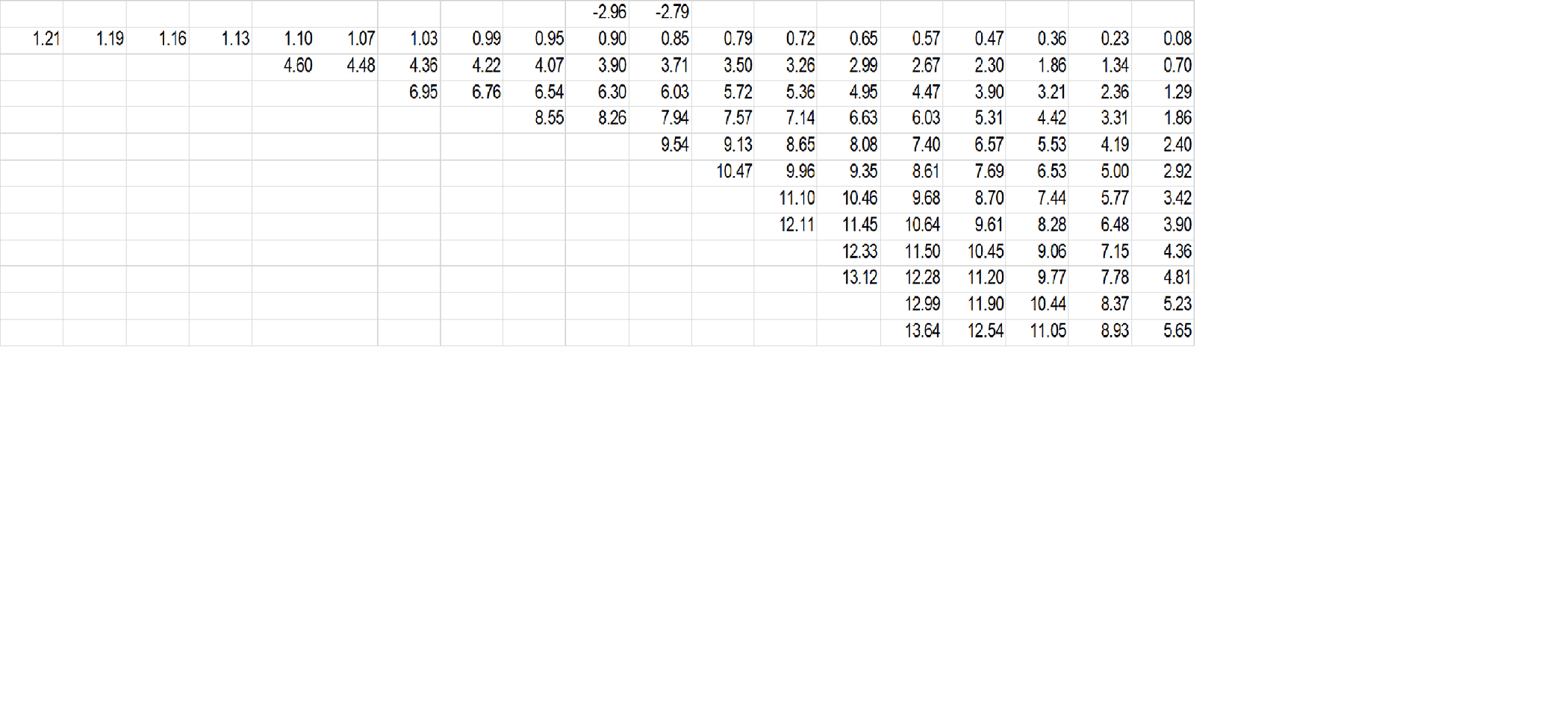

Lastly, if we evaluate these preferable areas to try to maximize the amount of octane increase and minimize the amount of total ethanol, we end up with this:
So what does that all mean?
Well, some obvious and not so obvious takeaways:
1) The meat or sweet spot of this is around the 50% quality 93 mixed with E50+ ranging to increased 93 ratio (up to around 80%) mixed with even higher quality Ethanol (up to 85%).
Once we examine how much octane we're getting with each combo compared to how much we're increasing the amount of fuel flow and trim adjustments, we arrive at the area where the best combo of upping knock resistance compared to the increase in ethanol % is around the 70-75% quality pump 93 enhanced with 30-35% of E75-E85.
2) Hitting this from the NEGATIVE side, running a quarter tank of 93 and the rest E30 results in a near unacceptable increase in fuel flow (beyond the 30% ethanol) with little to zero increase in knock rating.
Furthermore, contrary to popular misconception, having 90% of your tank quality 93 and splashing it with anything less than 60% Ethanol isn't really doing much. You're having to mix fuels and getting a very very small increase in knock resistance.
Case in point, 3/4 tank of quality 93 mixed with 1/4 tank of E30 does virtually nothing for knock resistance (from a chemical standpoint).
