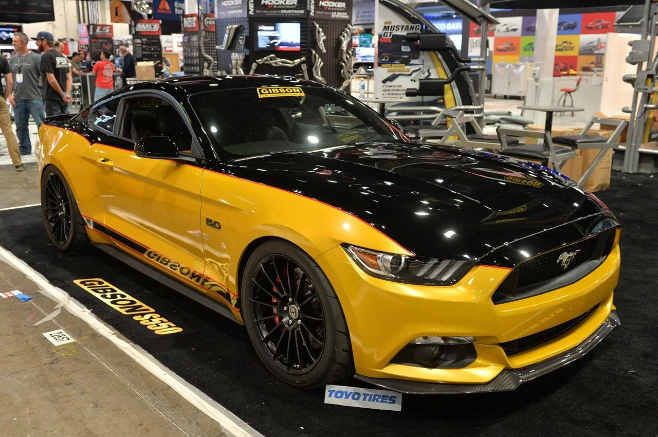

Gibson Exhaust Mustang GT was running HRE FlowForm FF15 20x10 et40 front and 20x11 et55 rear with Toyo R888 285/35 20 front and 315/30 20 rear with OEM struts and Eibach Sportlines...perfect clearance in board and outboard.

Hmm they posted on facebook and and on this site that the front is 20x10? When I pm'ed them I was told 20x10 +38.
The Gibson Mustang has a great stance for being on springs and good to know that they fit without coilovers.
