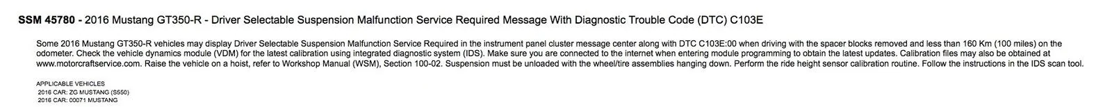

Well as you all know I have been bitching about the ride on my R...Well after complaining here at nausea, I was instructed to look and see if the dealer left the "yellow spring space" front and "white shock spacers" in the rear....Of course the dealer left them in thereaddle:.....however this is where it gets interesting. According to Ford Performance the car can not be PDI properly with the spacer in the car..So your car needs to go back for this to be done again. Also, there has been a PSB (I think it stands for... Public Service Bulletin) in regards the R's ride. (Poor ride i.e. bouncing, stiff rear suspension) The R's need to have the dealer check for an update software or something similar, in regards the following codes: #SSM45780 or #SSM45709 According to FP several people have been complaining about this !! (Most, not all, have said their car said Error/Malfunction in Suspension, like mine) If your dealer has any questions call FP at 800-367-3788......So if your R rides like a flat bed truck...go see the dealership at let them see this info...
