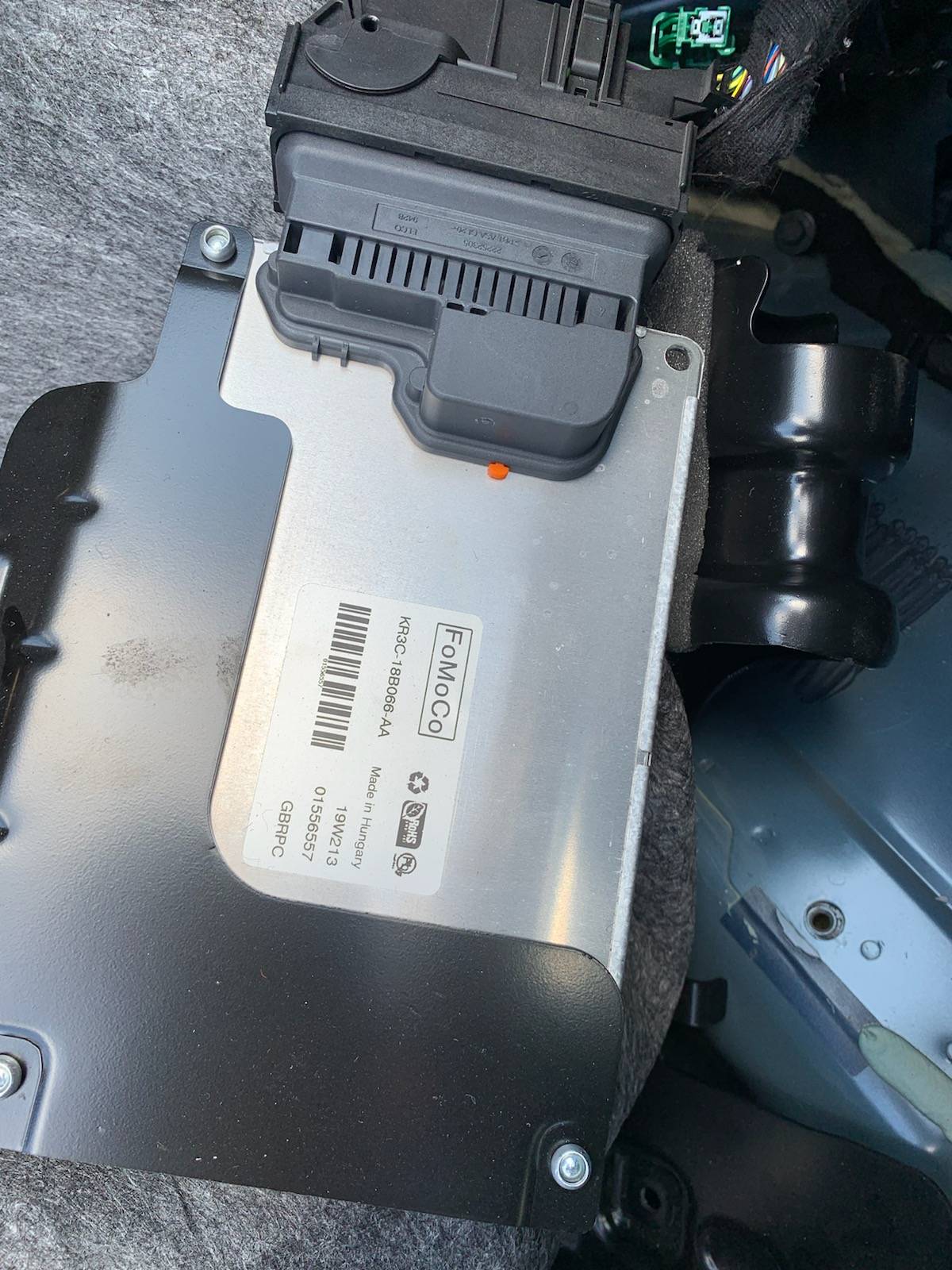

Riddle me this.....I found a 2019 GT with PP2 and had the vin verified that it was indeed built with PP2 and here's the pic of the VDM which matches the numbers you have for a 19 GT350R.
Oh, that's interesting! That is the only instance I've seen of one of the "sequentials" matching. I'm not surprised that the other numbers match, there is really only a little bit of overlap in the transition from 2017 to 2018 when MR became available on non-Shelby cars. All 2016, 2017, and some 2018 Shelby's had VDM's that started with FR3V and ended with DZZBA. The normal '18 cars like mine started with JR3C and ended with GBRPC. 2019 = KR3C; 2020 = LR3V. That one 19W213 is the only one I've seen like that.

So what number do you think is the actual mapping/firmware? The 19 PP2 I found ends in 6557and the 19 GT350R ends in 6651, all other numbers being the same.
