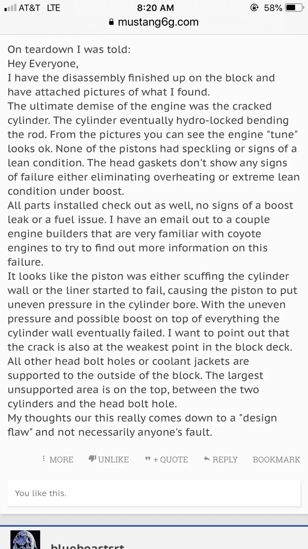

Here is a 5.0 .
https://www.mustang6g.com/forums/th...whipple-stage-2-engine-rod-bent.123294/page-2

I was really meaning strength beyond what has been achieved before with 5.0s. There are gen 2 and 3 coyotes that have made those numbers and more on stock bores. I was talking about numbers in the 1300whp ish and up range which would be clearly beyond the average. Not saying a stock coyote or voodoo couldn't achieve that but from past experience most wont try to push them that hard.
I didnt read all of that thread but the initial cause of that failure is speculation. Even some bone stock motors have failed. At only 600whp it seems plausible something else could have been the cause. When the coyote cylinder cracking was first being seen people were pushing 1000whp ish and tearing down motors with everything else looking fine.
