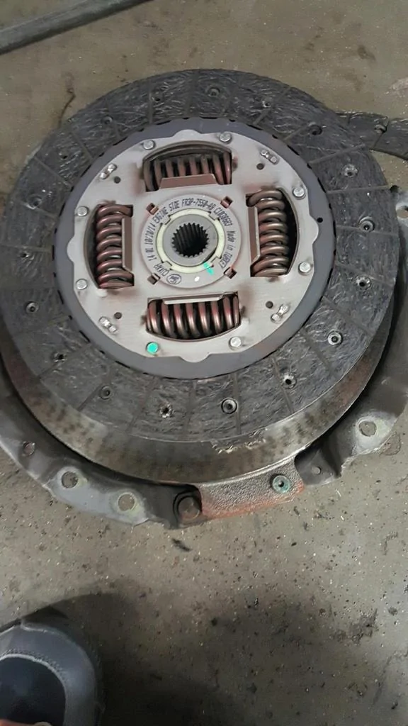

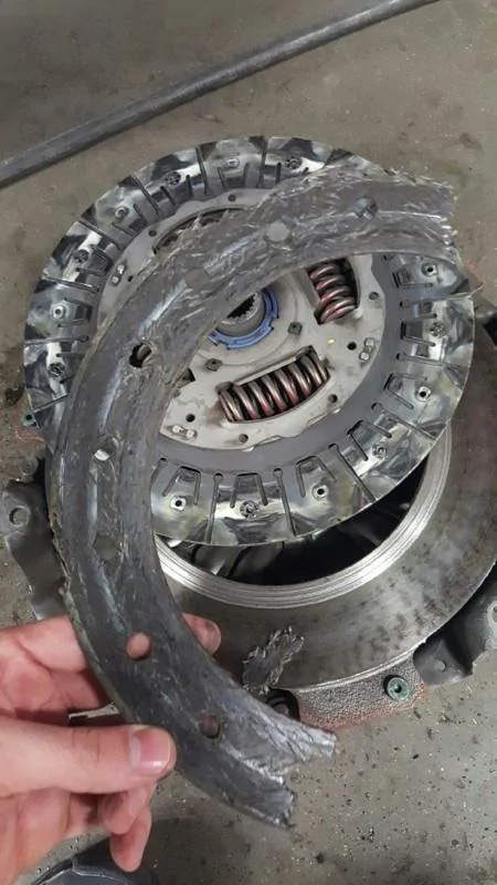

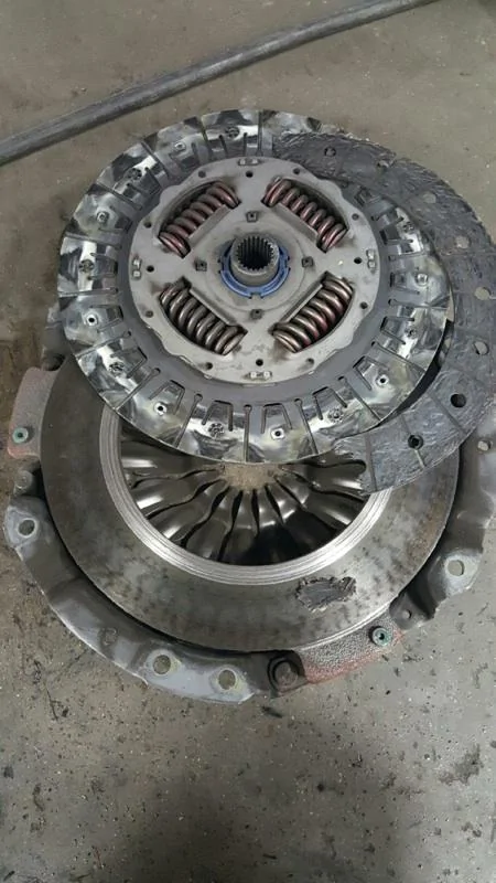

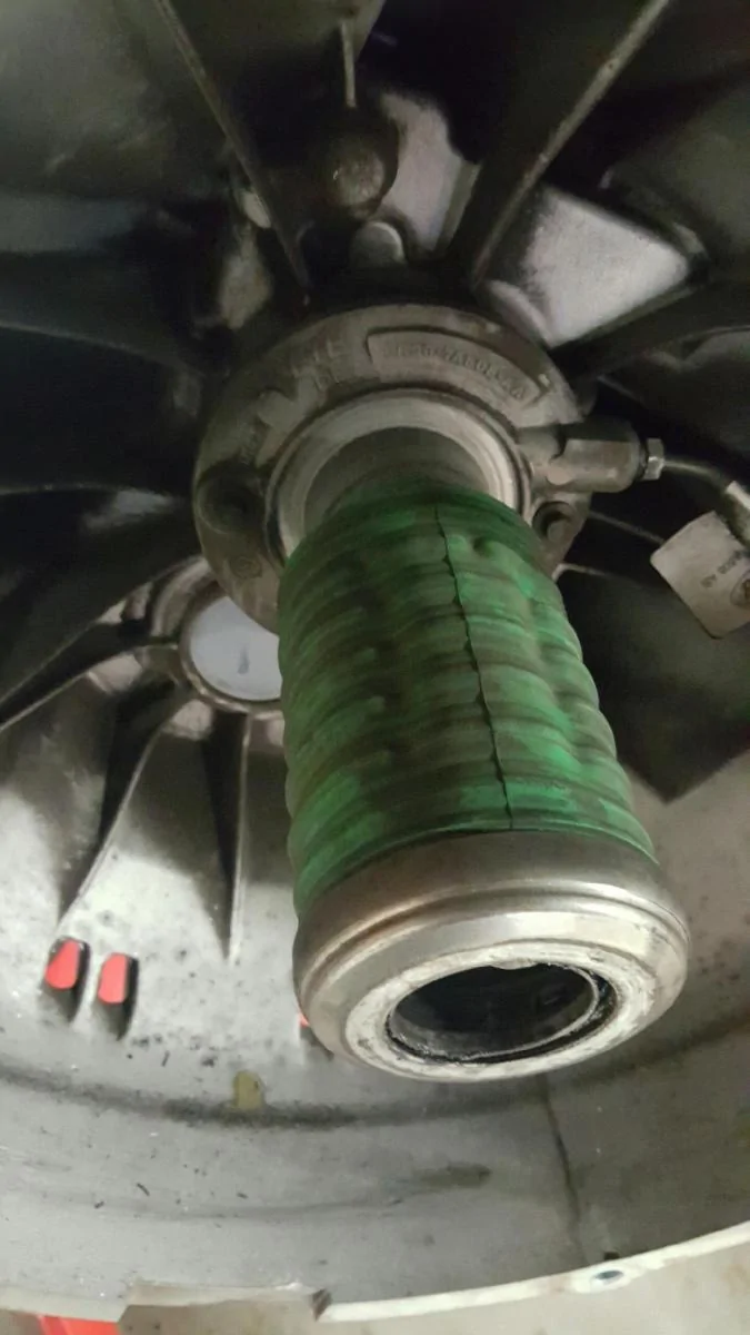

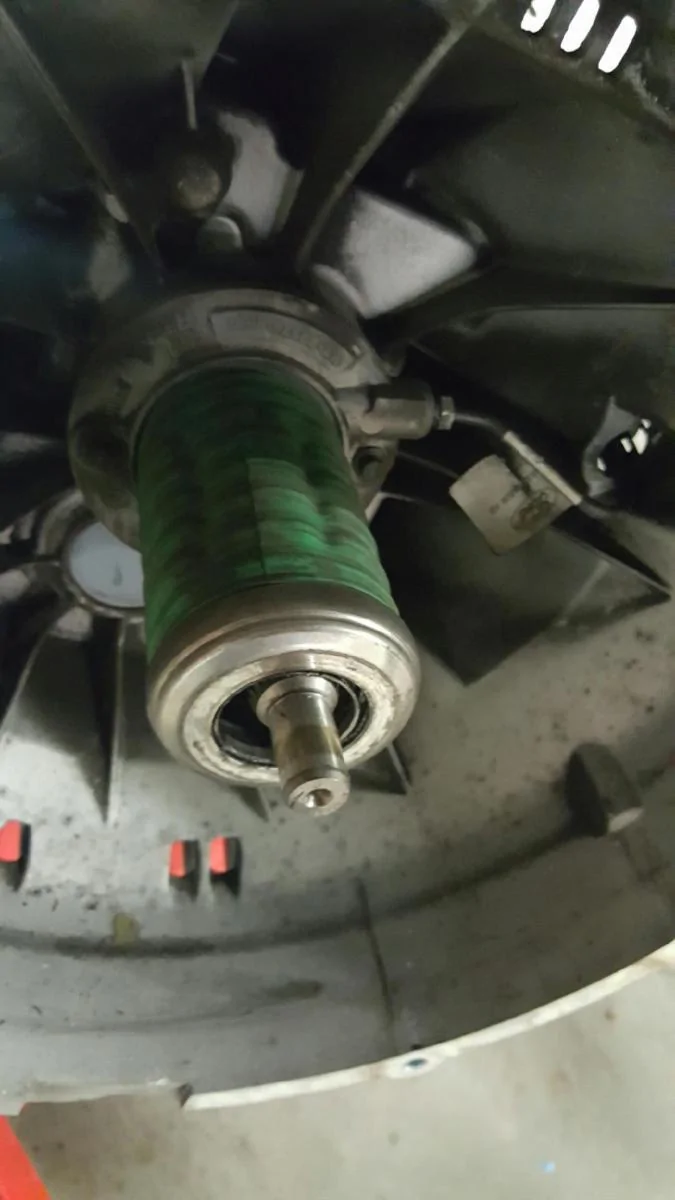

Hey Y'all,
Long time lurker here, I have a 2015 base GT with PP and Recaros being the only options. It's completely stock aside from the Mobil One full synthetic I use, and a pair of Michelin PSS's on the rear.
A couple of weeks ago I was coming home from Whataburger, with a freshly made patty melt, when my clutch stuck to the floor after a shift from 2nd to 3rd. There was a terrible grinding/screeching sound and my clutch would not disengage as I limped it back home where I ate my then-cold dinner.
I thought for sure my clutch had grenaded, but upon examination the next morning my clutch wasn't slipping at all and the sound was gone. It was driveable by starting it in gear, I just couldn't disengage the clutch. After searching the forums I thought it may have been a clutch line or slave cylinder issue, so I took it to the dealership with that in mind.
Nope, clutch was sitting cockeyed. I figured my throwout bearing was bad at that point and I'd be covered. Wrong again, Ford declined my warranty citing hot spots on the flywheel and pressure plate. I asked the dealership for the pictures they sent ford, they sent me cell pics instead because the ford pics "were on an SD card". There was no pic of the flywheel and the pressure plate was mostly obscured.
I have close to 150k miles put on my last 3 vehicles(all stick) and have never burned up a clutch. I'm having trouble believing this story, especially after only 17k miles and how many blown clutches I've seen here. It's going to cost me north of $2k to fix with labor and the McLeod RXT kit I want to replace the old P.o.S.
Am I screwed here? I've always been a Ford man, but this is my first experience with Ford Service. I'll be sure to look at GM's offerings too the next time I want a new car. :frusty:
