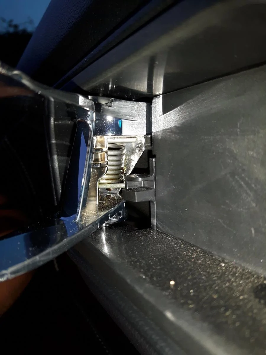

That's a door handle, not a door latch. The issue is with the door latches.I posted this in the EU thread yesterday, but here are my findings...

Since some time I have issues with the door handle on my 15EB, (hard to open & close, door-handle going into a loop lock when trying to open from outside etc.) although my build week was May 13th '15, so after the recall date of April 30th. Anyway that said, I noticed that the spring on my 15 is thicker in diameter than on the 16GT that I compared it with yesterday. Maybe someone could take a pic of the 16 spring as I didn't unfortunately but might be able to do so next week or so..
Spring on my 15:
There's always a lot of time between when an automaker knows there's a problem and when the recall comes out. Sometimes the NHTSA has to force the automaker to do a safety recall, or they'd never put a recall out.GT Pony: While the "Official" recall notice was released by Ford 6 months ago, Ford knew of the issue way before then. One would think that the door latches on the '16 and '17 Mustangs would fit the '15... guess they don't want to hold up the production line like they did when they had many of our 2015 parts on constraint and vehicles were delayed.
