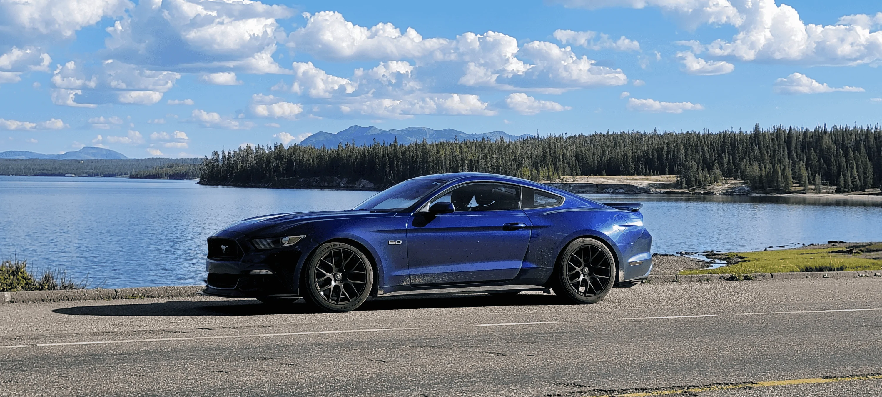

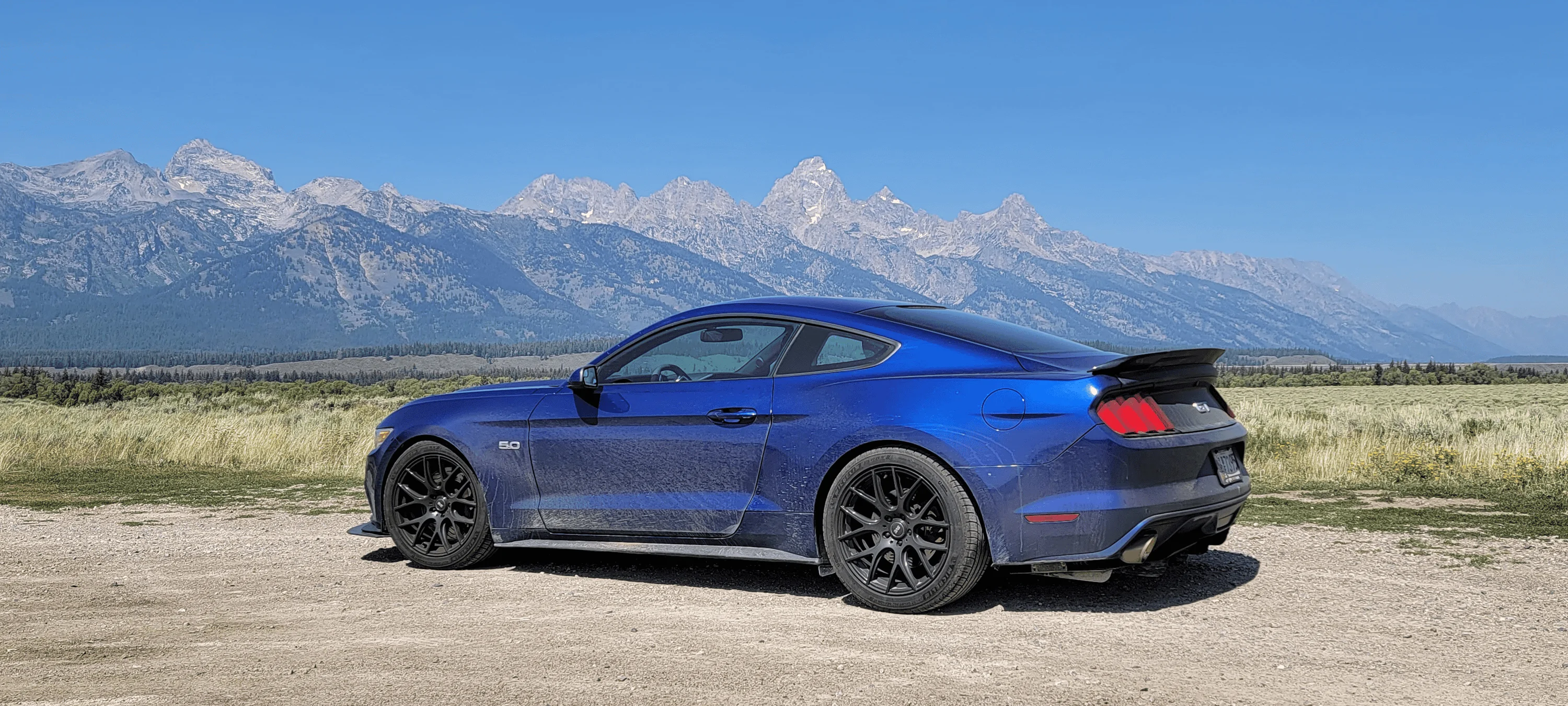

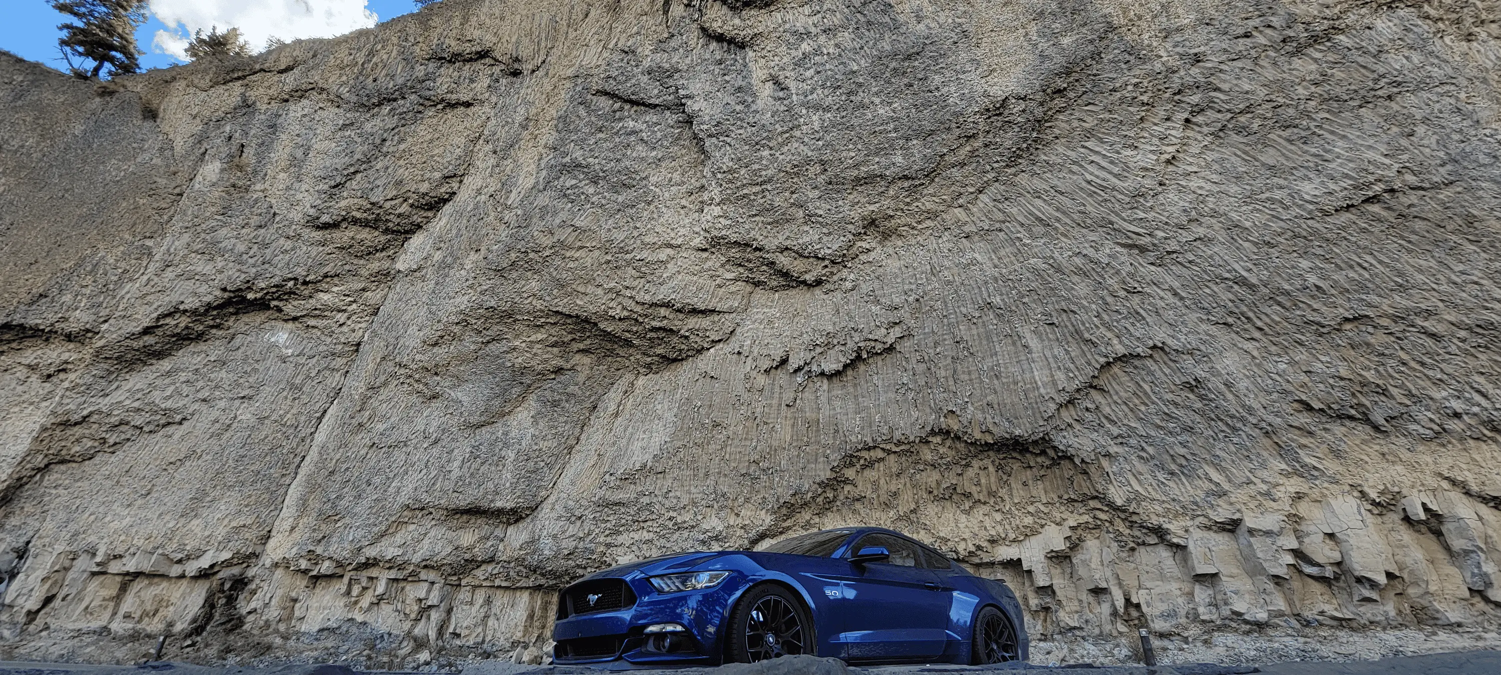

Some pics I wanted to share from my Yellowstone trip:
It was a trip of a lifetime. If you haven't been you should go, and drive your Mustang there.
