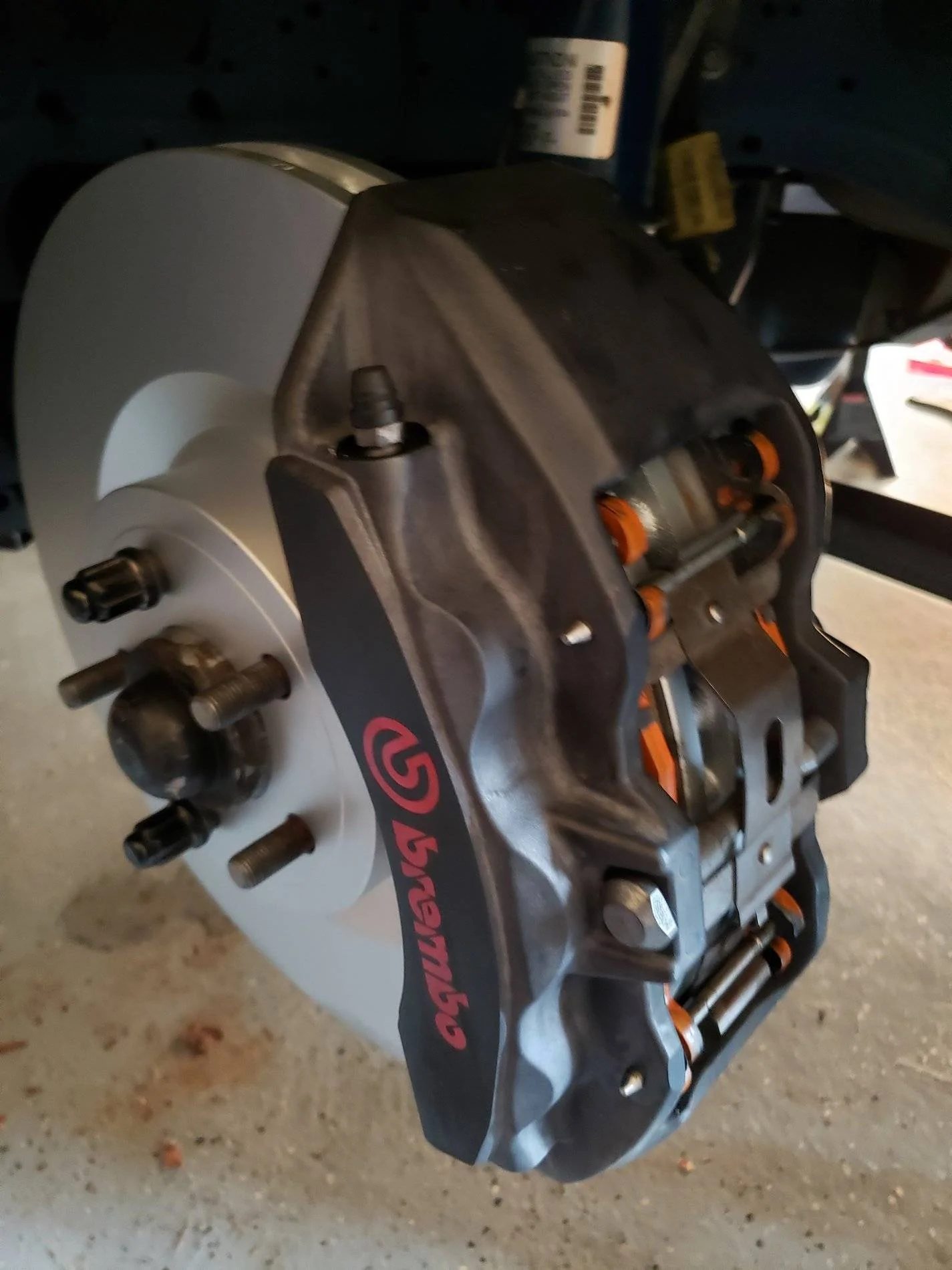

Just got the GLOC R10 pads in for the front, along with new Raybestos rotors. Already has GLOC R8 for the rear that I picked up new for half price. Just got the magnetic autocross numbers in too, so no more green painters tape lol.

Just got the GLOC R10s and R8s on in time for the event tomorrow. Also replaced front rotors with Raybestos (from RockAuto about $50/pc). Never changed pads on the 6 piston calipers before so ill be better at it next time.
Pedal became a little squishy and had longer travel after last event. Turned out it was the pads and rotors. Now with GLOC pads the brakes feel excellent.

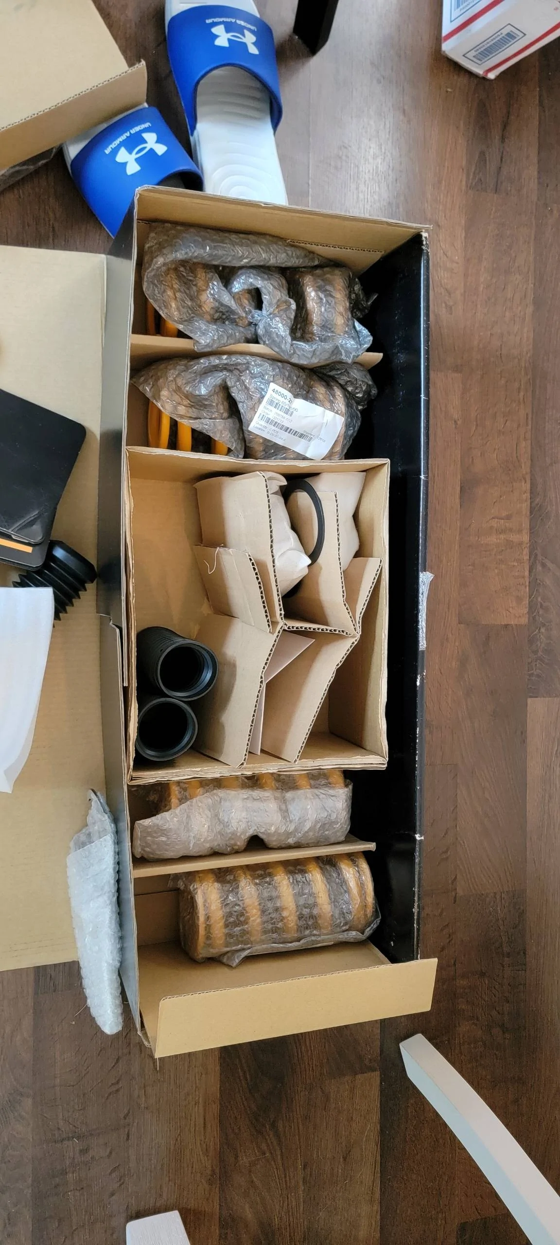

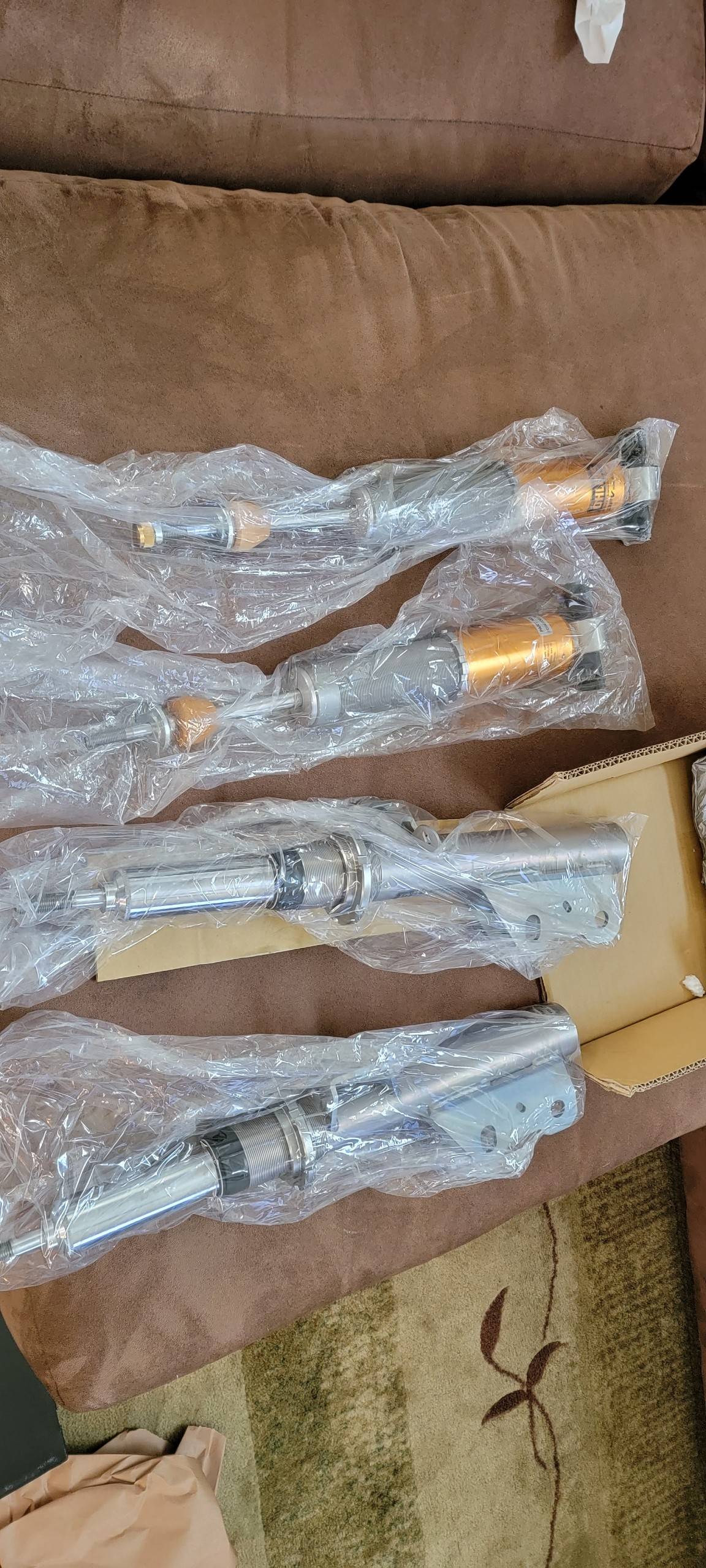

I went with the Ohlins R&T kit from hotpart. Installing them on Tuesday. I considered a custom Ohlins kit from J&M, but after some conversations with Vorshlag on how I plan to use the car, they strongly suggested I use Ohlins' stock rates (515F/800R). It is my daily driver after all and I don't intend it to be racecar. I'm excited to see what having some real good dampers can do, as well as the stiffer front springs.
I will report back on my thoughts once I have them installed.

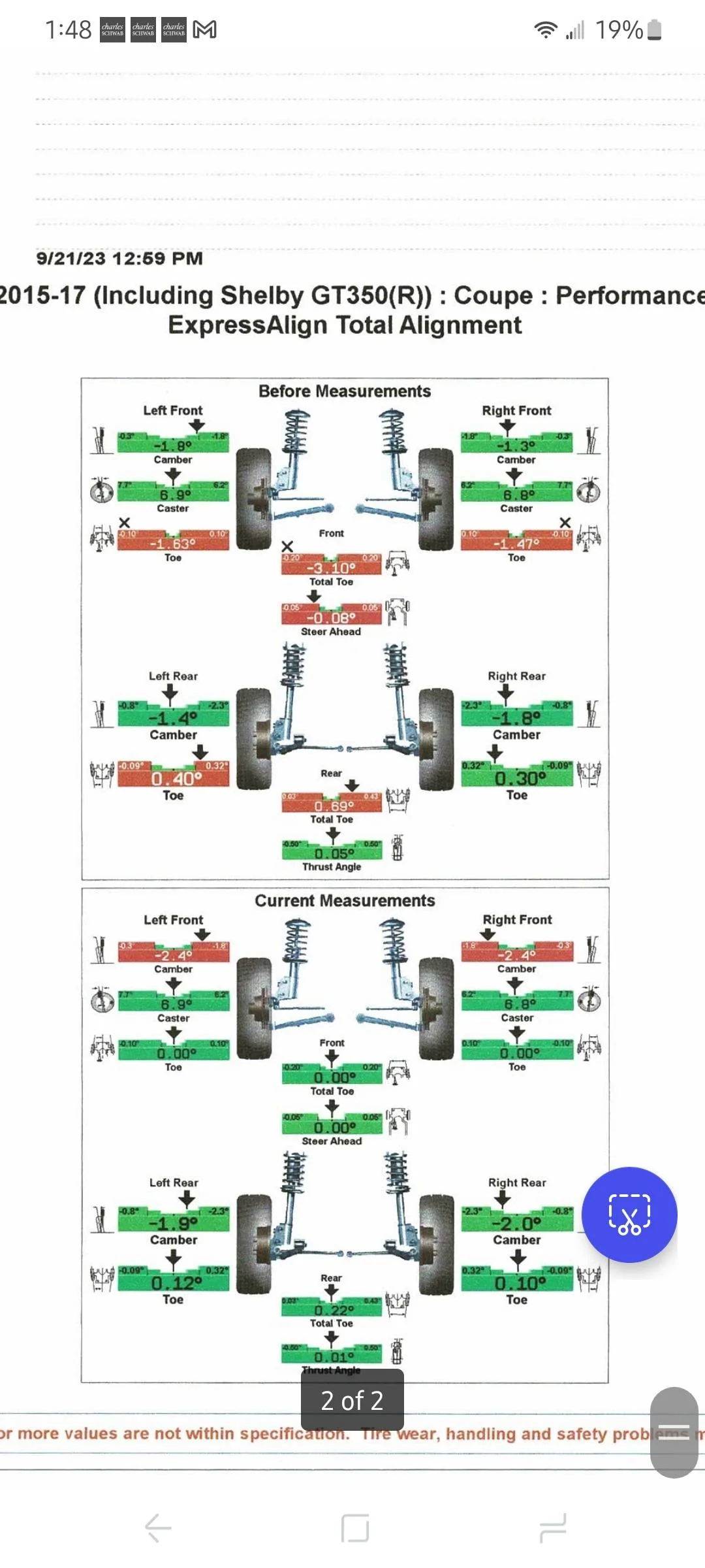

Just picked the car up today with the Ohlins coilovers installed, J&M plates, and J&M bumpsteer kit. Just in a short drive, I can tell you it rides amazingly.
I can't even tell that my spring rate in the front went from 250lbs./in. to 514. It actually feels smoother. The ride feels completely different. The biggest difference I notice is over sharp bumps the damper reacts immediately and with much less drama. That is the DFV working. Much less drama overall, in fact. Flat, smooth and drama free. I have yet to really test it out on backroads or anything so I look forward to that and playing with the damper settings.
I had shop set the coilovers to stock preload which equates to ~25mm lower than stock car. I figure I can adjust later after everything settles and I get a chance to get comfortable with the setup. It appears slightly lower than the BMR SP083 did. Probably similar to the FRPP track kit. My 275/40R19 Michelins tuck ever so slightly in the wheel well. And there is a slight rake to the stance. Also 👍🏻. If I do anything later I might raise the ride height a few mm, but we'll see.
I was able to eek out a little more camber and tech said he thinks I could go further. But for a street car I think this is pretty good.
*** An extra note: the Steeda rear shock mounts - yeah, they don't fit. I had to go back to the OEM shock mounts for now. I thought they would fit considering the FP dampers fit both the OEM mount and the Steeda and the Ohlins were made to fit the OEM shock mounts. Well, I thought wrong. I think J&M has a solution that I now realize is made specifically for the Ohlins.
