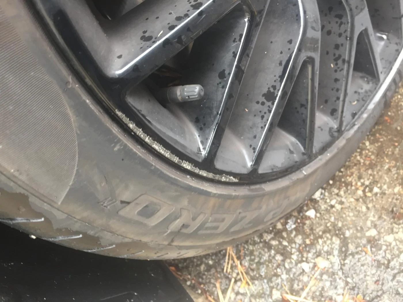

Went through the drive through at a bank I've never been to today. Never curbed a wheel in my life until just now. So pissed....

1st step. wash it.
step 2 buy new wheels and tires!

There are lots of places around that will give you a good rimjob. Just call some local tire places and ask if they will give you a good deal on one

Not sure if you have one local. But Dent wizard repairs rims with damage like that. Just from what i remember on getting a wheel for my bmw fixed there your looking at 175-225
So pretty much I can buy a new wheel for that price.

try alloy wheel here in blue springs...... ive used them before and they do really good work.

black sharpie or touch up paint

Second that...black touch up paint...done

Sand smooth and then touch up paint.
More sanding and polishing.

Find a powder coating place... They will need to sandblast the original finish off...which should smooth the damaged area out to a point it won't be noticed...then he powder coats the rim black again...done! Ask me how I know! Shouldn't cost more than 100$.

Use a Dremel and smooth it down. Then touch up paint.

If you want to go the DIY route:
-Lightly sand or file down the rough edges.
-Use Bondo with Metal Reinforced Filler to fill in the scratches.
-Sand again.
-Use touch up paint.
To really do it right, you need to remove the tire from the wheel and do the whole whee though or send it to a shop.
