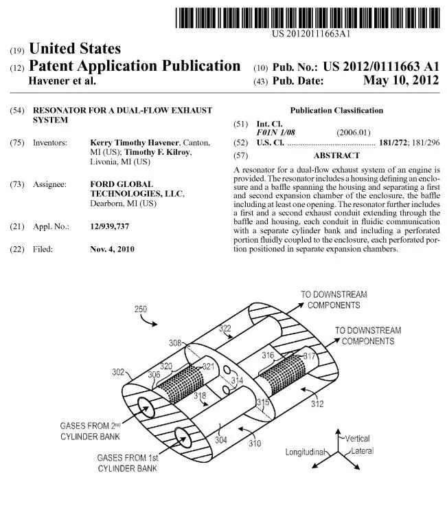

If by 'true' dual exhaust, you mean separate pipes all the way back that are not connected in any way, that is probably not something you would want to do. H & X pipes improve exhaust flow, and therefore performance. Running isolated pipes will in all likelihood reduce performance.just wondering y nobody says anything about true dual exhaust vs. x h pipe
ok just learn something
Yes... they definitely tie together in some way inside that "suitcase".Maybe there is an X in the suit case crossing the exhaust pipes?
That's cool... but still allowing each side to equalize.The pipes do not physically tie together. There are two chambers within the resonator with one pipe having perforations in the first changer and the second pipe having perforations in the second chamber with an opening between each chamber. It's in Ford's patent for the resonator which was previously posted on this site.
