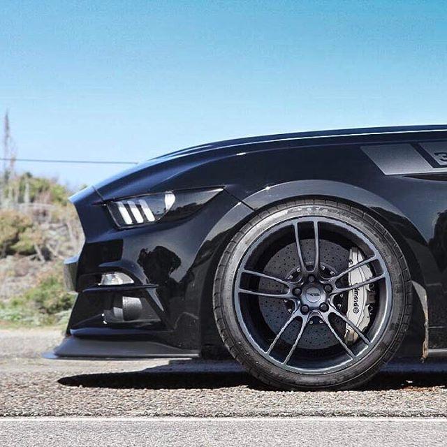

Stock PP front on a 19x10 up front http://www.mustang6g.com/forums/showthread.php?p=1081179#post1081179 That thread should have some more from people who reused the PP tires on theirs.

I've got the stock PP rubber stretched on 10" and 11" wheels currently. Fronts look slightly less stretched than the rears, but neither look bad by any means.

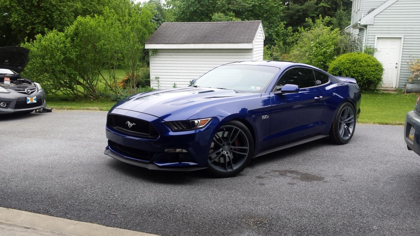

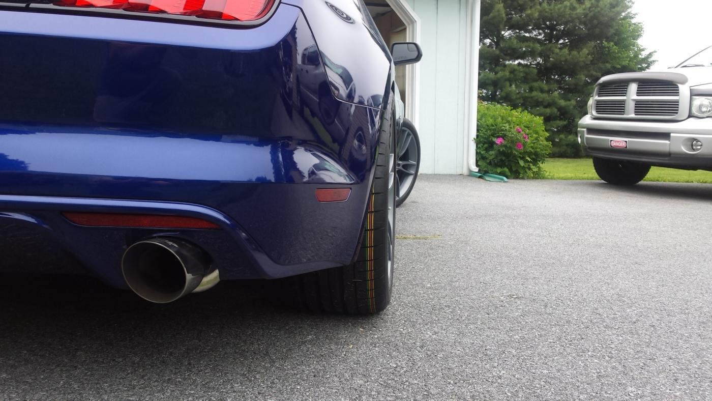

Sure, I can do that. Tire sizes are 285/35 fronts on 20x10, and 315/35 rears on 20x11.
WhiteyDog
WOOF!!!
Jun 30, 2016
1,789
731
Manheim, Pa.
'16 GT PP
Here they are, 285/35/20 fronts on 10" width, and 315/35/20 on 11" width. Took it for a test drive- no rubbing, no issues.
