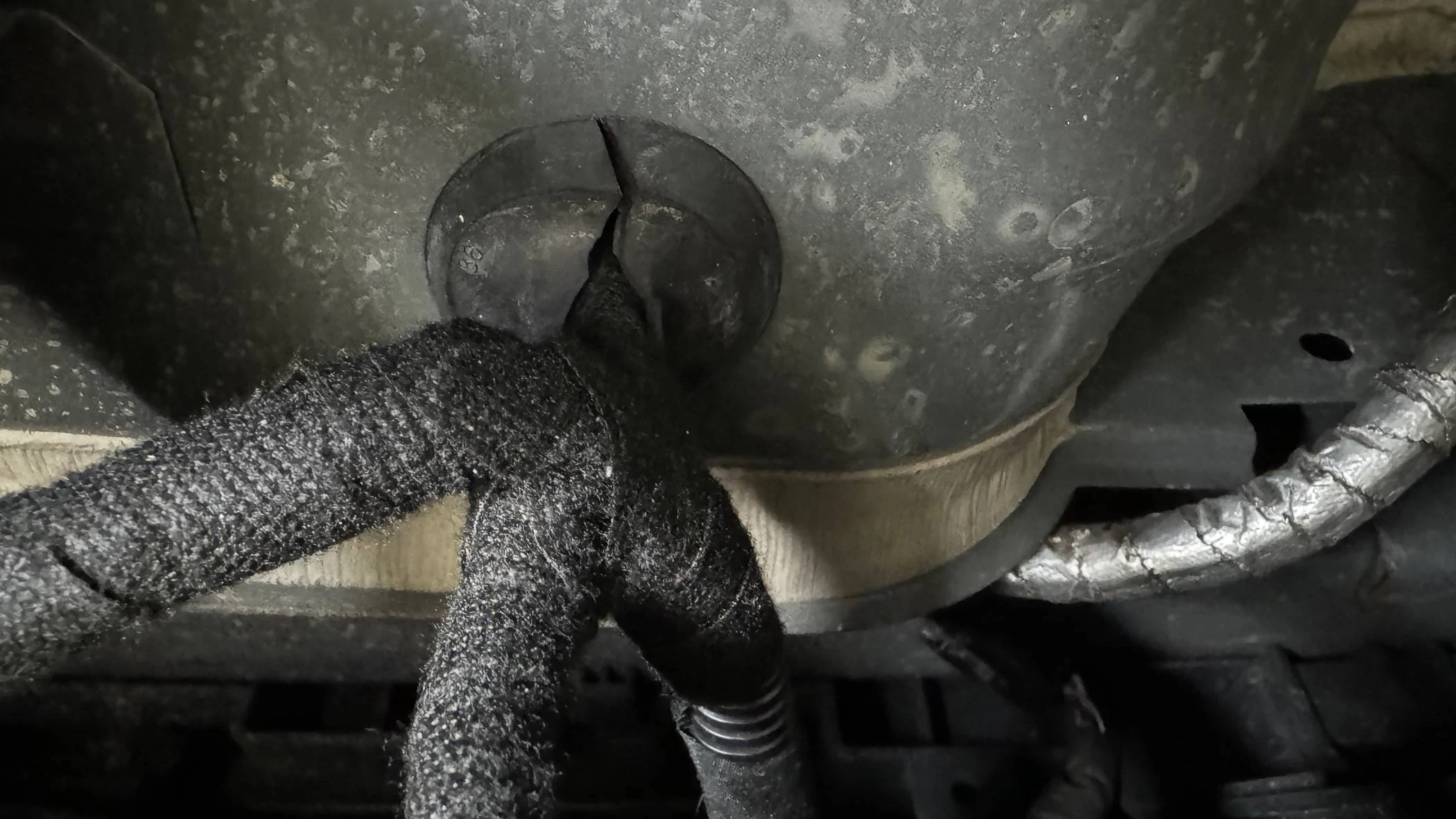

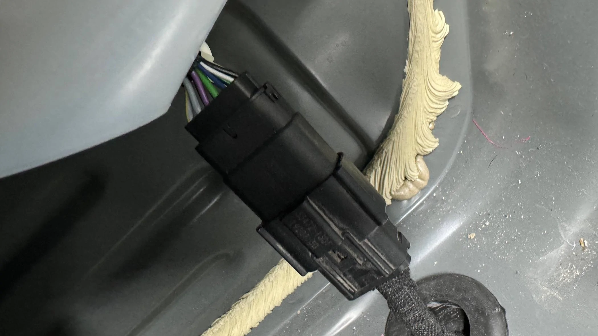

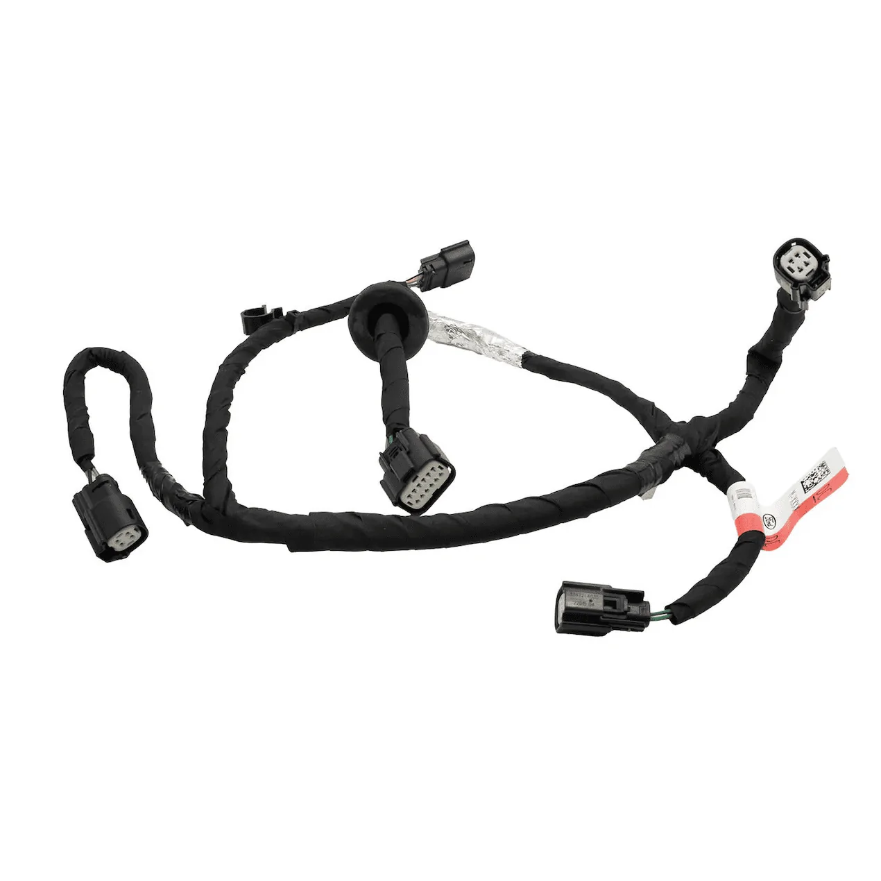

For any one with 2022 trying to do this. I had the plug in the trunk that I used the wiring harness for a gt500. Removed the wiring for the diff cooler. Everything was plug and play. Make sure you have the fuses, turn on turntable exhaust in IPC with forscan and activate the exhaust with a turn.

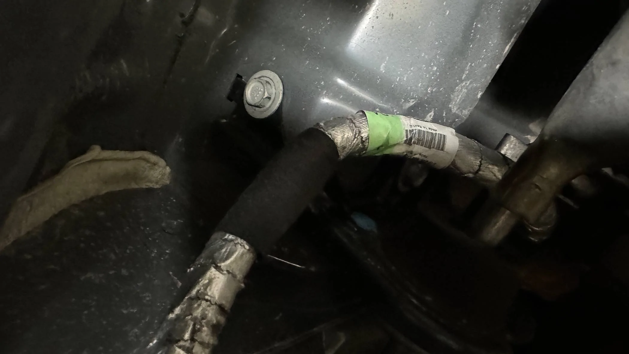

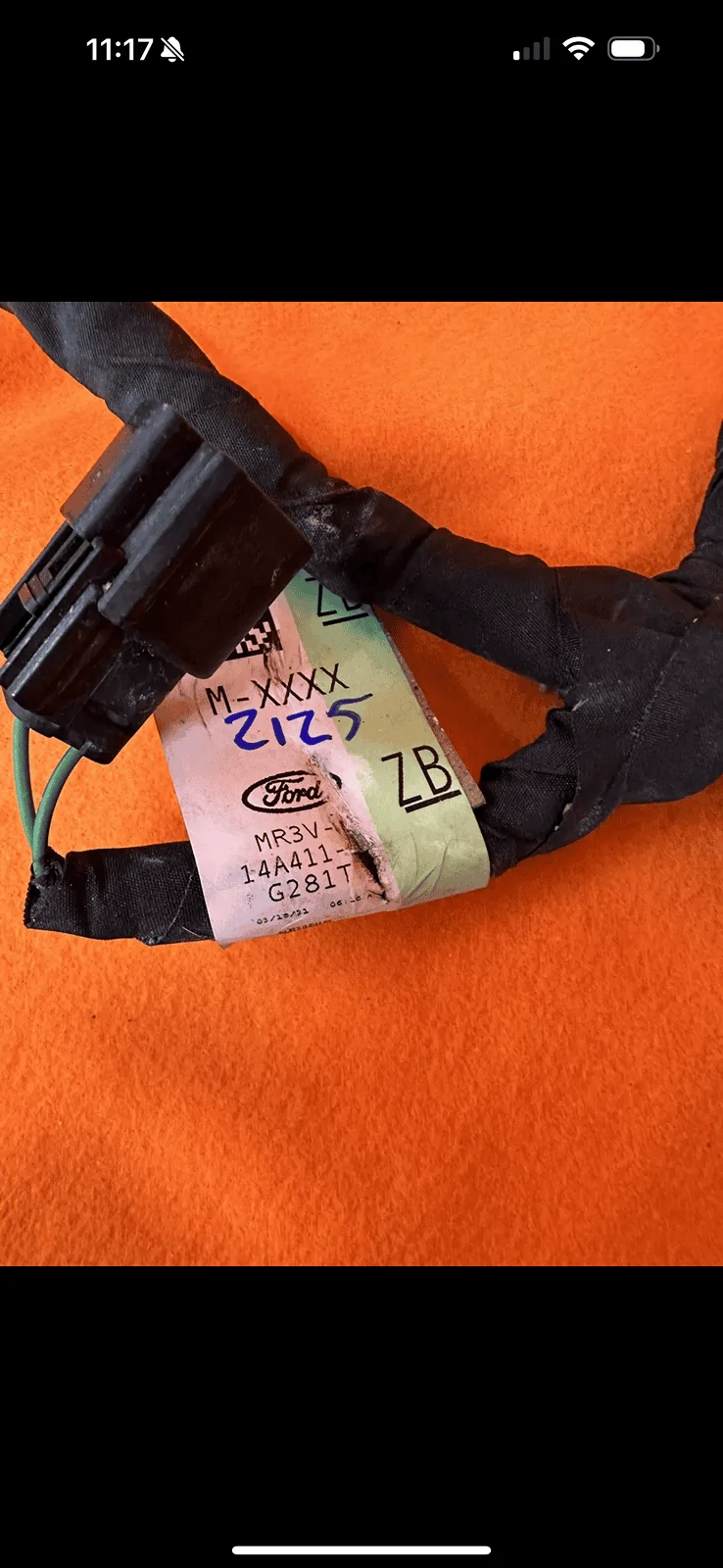

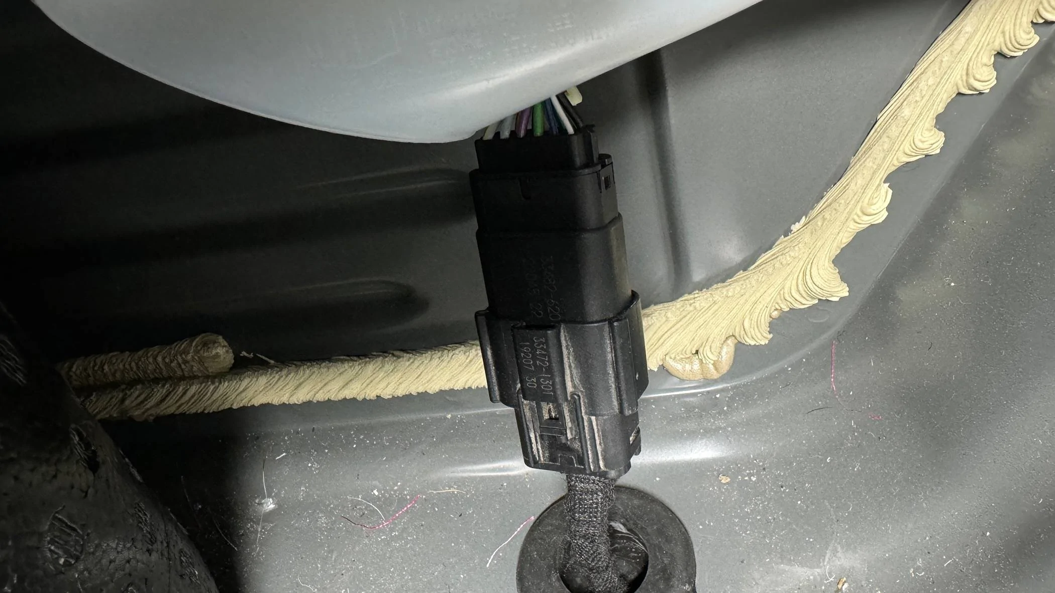

Pretty much if you have the plug in the pic inside your trunk. It’s plug and play. All you need is the gt500 harness which is going to have an extra connector for dif cooler. You can delete it and replace the already connected EVAP harness with the one that came with the car because is too short. Every other plug should be plug be used. Turn on turntable exhaust in the ipc and in the PCM with a tuner. I already install everything so I can’t really show the part numbers but it should be an easy look up. The plug in the truck gos to the EVAP by default. The gt500 harness will replace it. I did some searching before post. The pic with the orange back ground is from eBay. That’s the one u need and you also need two of the ones going to the actuator. They are not the same part number as the other ones in the forum.

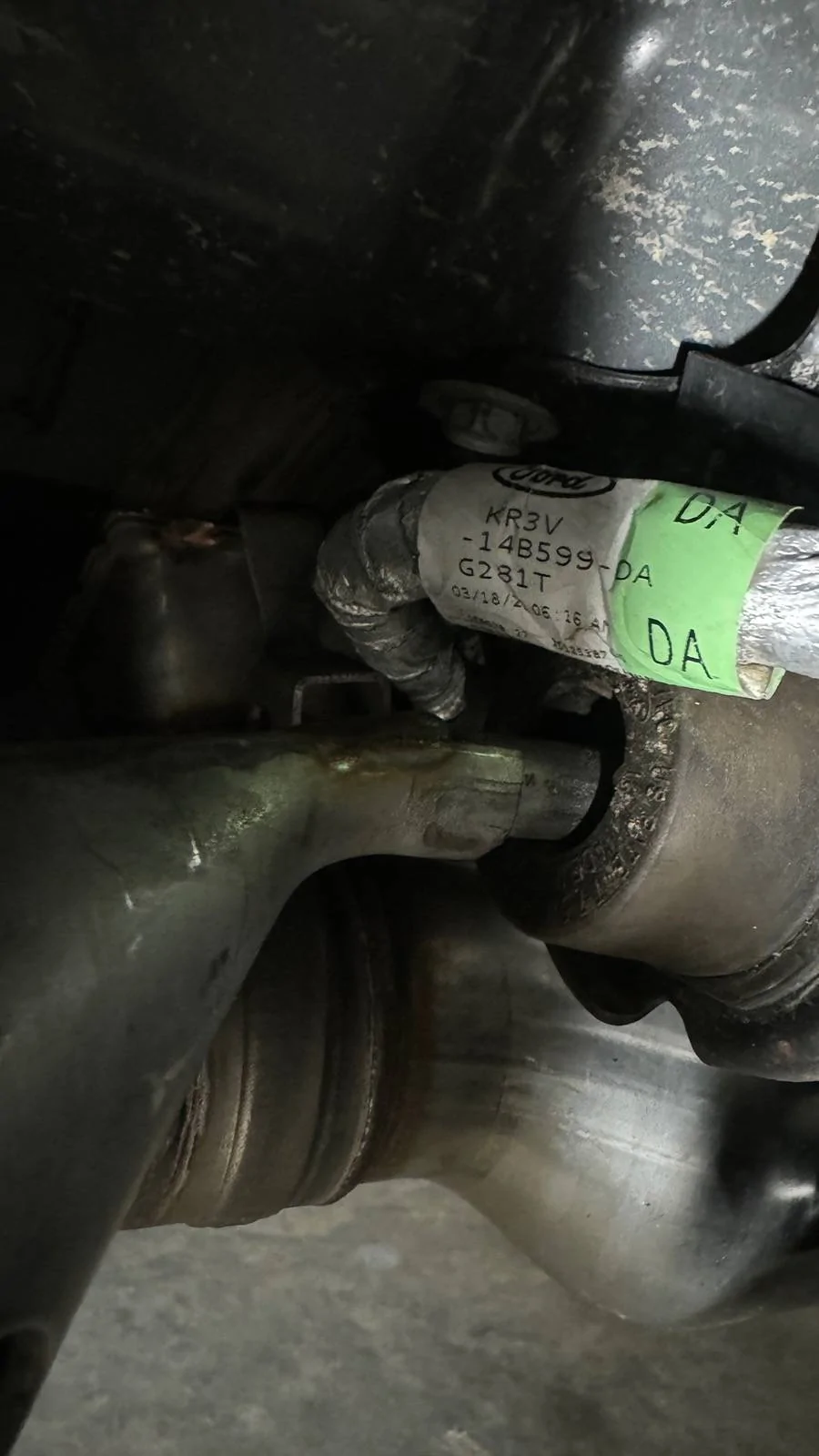

That harness is still on eBay just search gt500 active exhaust harness. The two for the actuators should be PN KR3V - 14B599- DA x2. Sorry I should have taken notes but I was winging it because my car was different. Hope I helped.

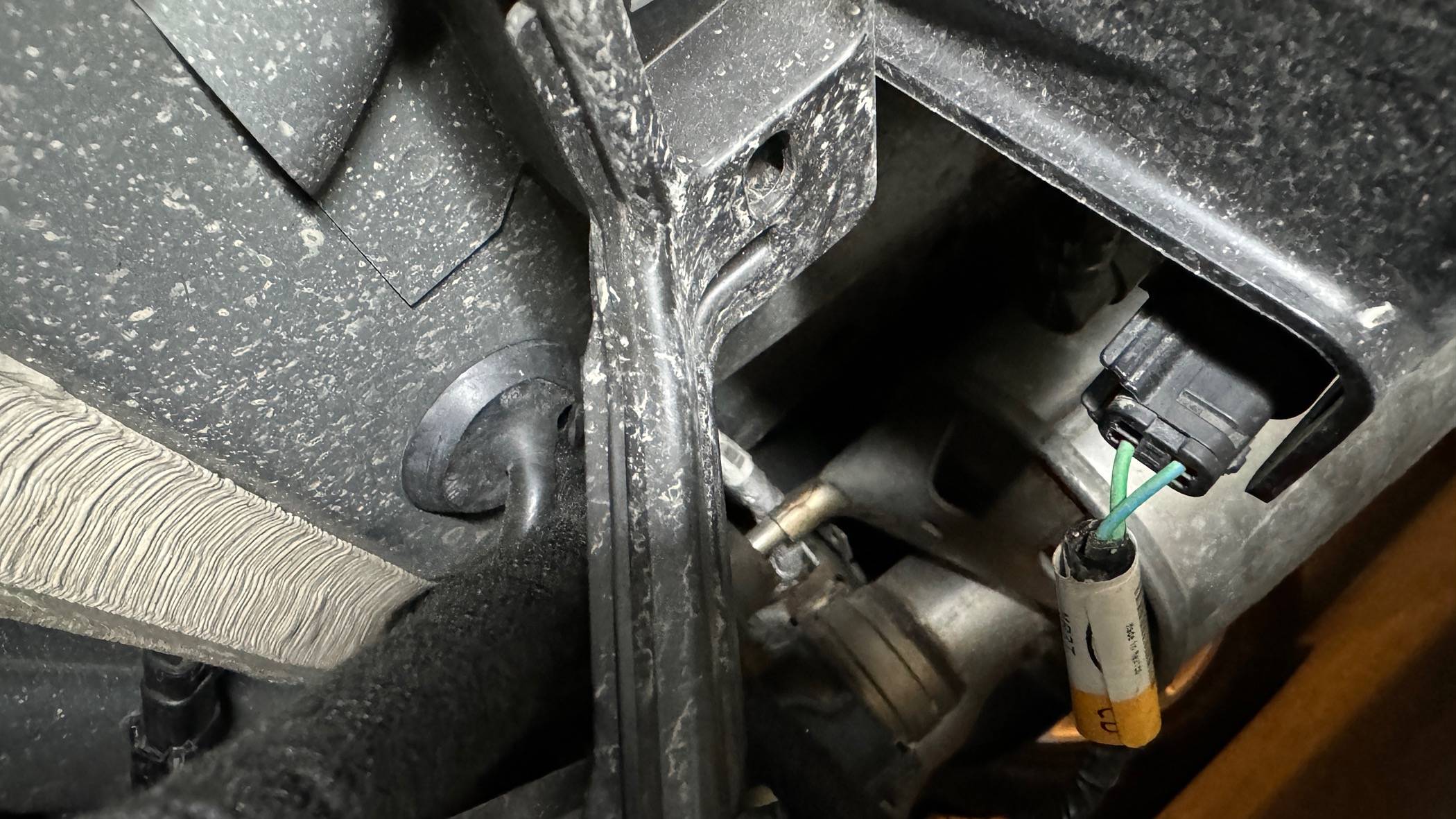

Anyone know the situation on the 24 gt, or is there a similar thread? Are the wires there?
Hi, I am working on retrofitting AE on non-AE model. I haven't checked under my vehicle if there is a wire but I found many codes need to work on Forscan.

If you guys have the plug in the trunk like my 22 does and the fuse/relay under the hood, this harness worked for me.
part # MR3Z14A411DA

I think it’s the same plug I use on my 22. Mine came from a GT500 but I deleted the plug for the rear diff cooler
