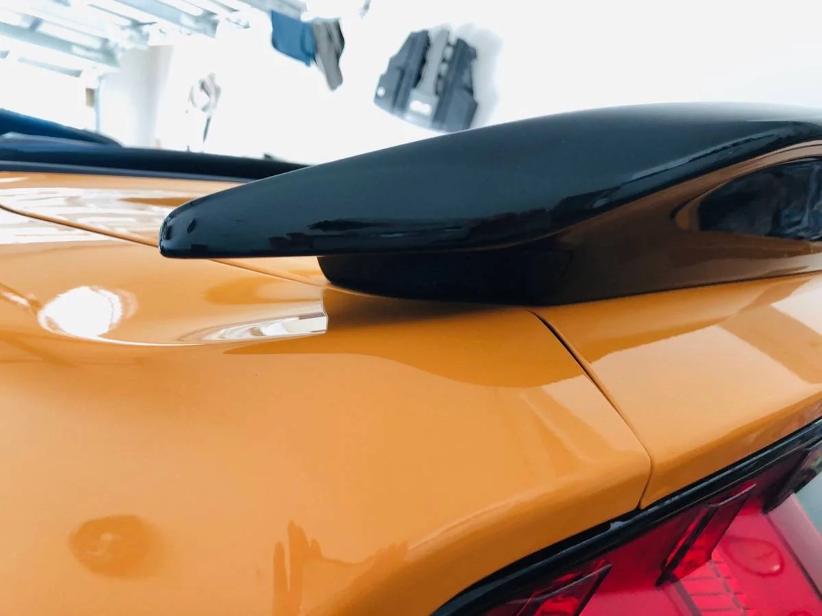

Well, I can confirm that the Speedform GT350 track pack spoiler does not fit the convertible. It WILL attach, after stretching the outboard holes and drilling new center holes, but the ends will not lay flush on the deck lid. It leaves a gap about 1/8" on both ends. Nice wing for the price but just doesn't work with the 'vert.

Yep, that little contour difference in the trunk lid of the convertible vs. the coupe causes that fitment issue, but I mean, it doesn't look terrible :) I had the same thing with my Foose/MMD wing, not convertible specific, and the ends didn't quite sit flush on the trunk lid.
You can see how the BMC sits perfectly flush:

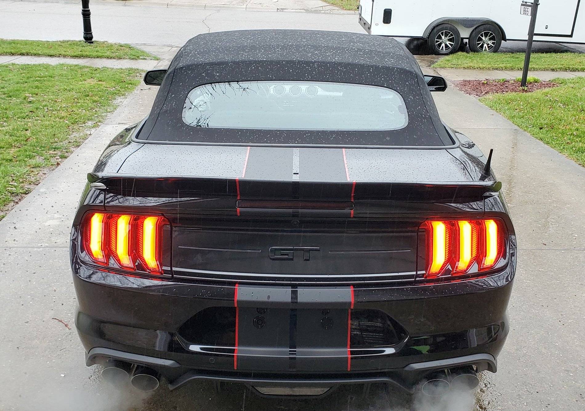

Used the 4 existing holes. Just had to drill into the spoiler for the 2 center. Did not use any tape. I did however put some silicone on the heads to keep water out of the trunk.
This is the same one I have.

Thanks! I think I'm going to try the one from ebay that looks like the BMC one. Unfortunately, the Speedform was leaving too much of a gap and leaked.
