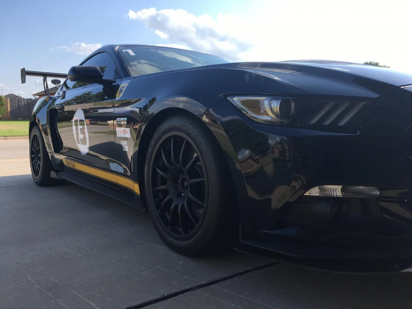

Found a cheap source for 305/680/18 pirelli take off slicks. I'll be mounting them on a spare set of Team Dynamics 18x10 ET 46.5 (based on measurements).
Car is on stock shocks with BMR handling springs. I have arp extended studs so not a problem there.
For what it's worth, they hit the strut when mounting ever so slightly. 5mm spacer I have worked for wheel alone (probably could have been 3mm).
Adding the large 305s, I need some guidance, any help?
