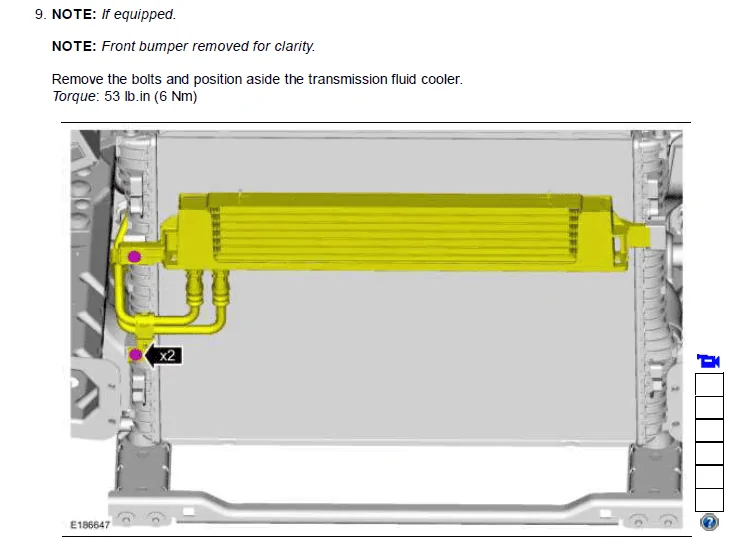

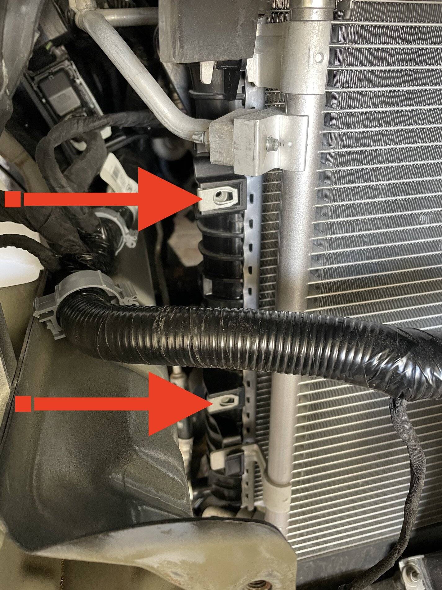

I had my radiator replaced by the body shop fixing my car as they say it had some small damage to it, and i noticed after picking it up that there are 2 bolt holes that look like something should be attached to it, but they are telling me there was nothing there, so would just like to check with you guys if you know if there is anything missing here?
