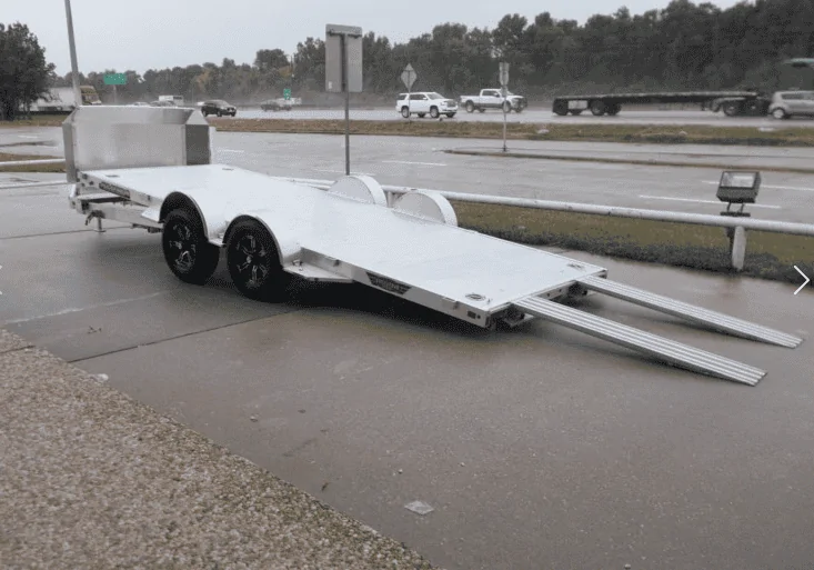

i recently bought a primo aluminum open trailer and added a aluminum tool box on nose to contain winch/battery. The trailer has a dove tail with 7 degree angle and the ramps double as rock protection on front of trailer. I use the provided ramps with my low angle race ramps and my 2019 gt350 goes on with absolutely no issue.. I bought the primo brand new for 7.5k after looking at many other aluminum trailers at twice the price (ie: Futura). Good luck

?? Not sure of the purpose of your post other than to make me feel bad about spending more than 2x on a Futura. Glad you got a rocking deal on your Primo. “Good luck” to you as well. Oh, BTW, do I understand correctly that you have to use two sets of ramps? “The provided ramps with” your “low angle race ramps”. My Futura does not require any ramps at all. 3 degree approach angle off the bare trailer bed. My Mustang, and Boxster clear with room to spare.

LOL Holmes.. Not trying to make anyone feel bad at all and I am a huge fan of the Futura.. I was seriously looking at a Futura and I really liked the low approach angle without needing any additional ramps. My solution is definitely not as sexy as the Futura but the cost of the trailer, the box, winch and race ramps came in much less.

I did think of one negative of the Primo that I did overcome. The fenders are not easily removable as on some other trailers and my car with track wheels/tires would not allow for easy opening of drivers door. I did "modify" the fender to drop it about 1/2" so that I can now easily open the door without issue.

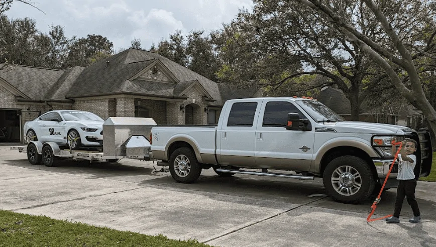

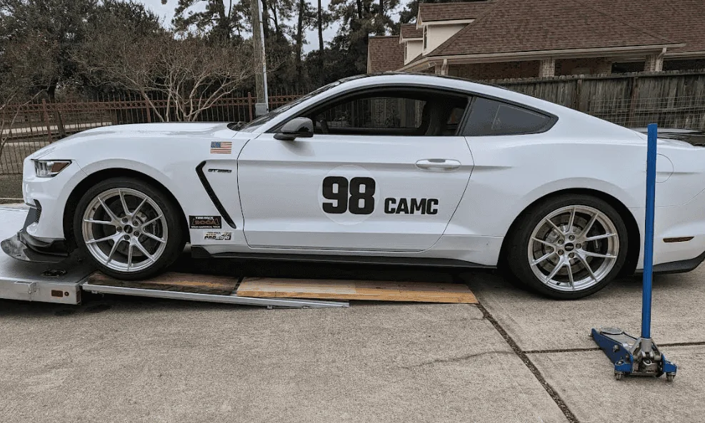

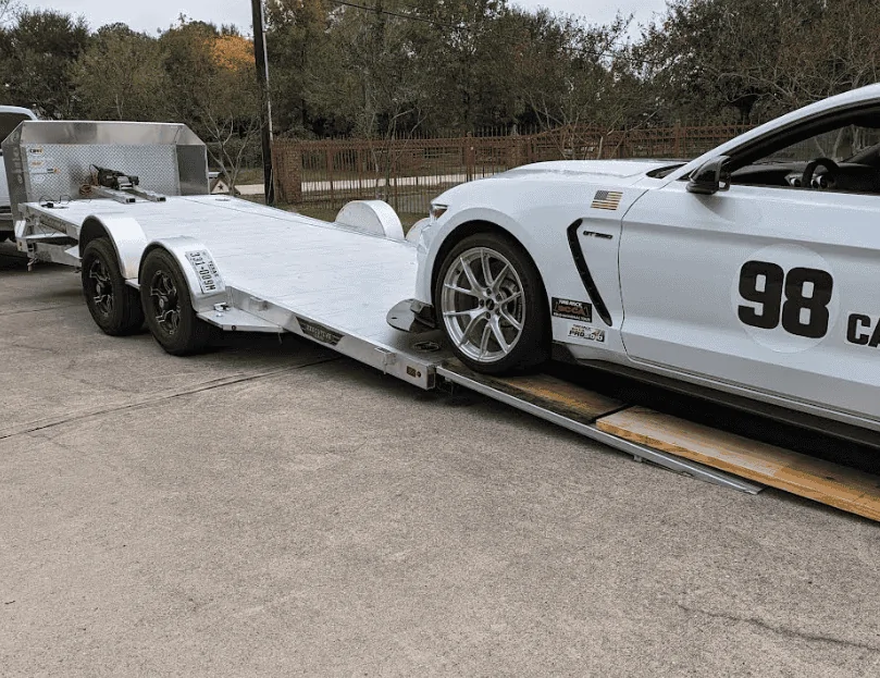

Picked up that trailer in my photograph. Love it. I still need 2x12's to load the car, but if I was stock, it would load no problem. The only thing I am considering adding is a different tie down mechanism because the straps you see there allow a little play. I can crank down on the P-brake, but I don't feel like it's a good solution.
If you are allowed to customize, I would forgo the deck lighting ('ve never used it, even unloading in the dark) and definitely get the winch plate/winch installed. And a son who loves winches. Two person loading is so much easier.

The Aluma trailer I had was a real nice option for the price. It was different than the one above, in that mine did not have the extra step of the ramps, but I can see where that would probably improve the approach angle. I also had to lay down 2x lumber to get the nose up a little before driving on the trailer so the extra effort to set ramps up happened in my case anyway because of the lumber.
