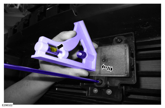

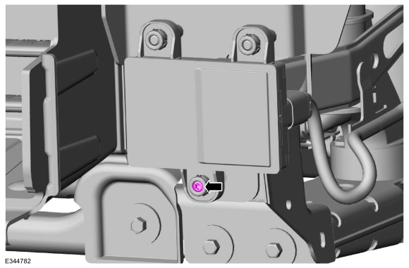

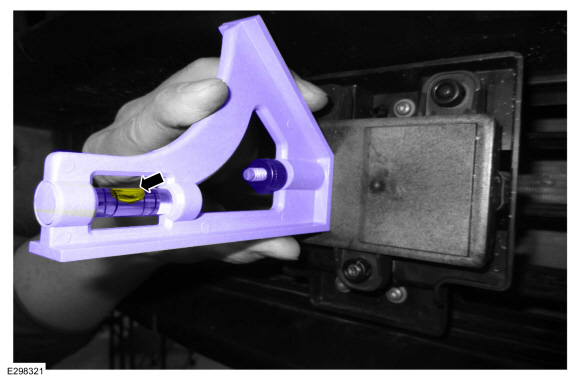

Might be mistaken, but its not the radar system for the cruise control assist and collision detection is it?
How does one align it? It went back in the same bolt locations but without the cutting it wouldn't have fitted. The bolt locations had those metal threaded clips so it went back where it came from but, is it something Ford can check via a computer?Yes it is , might have issues if it is not aligned right .

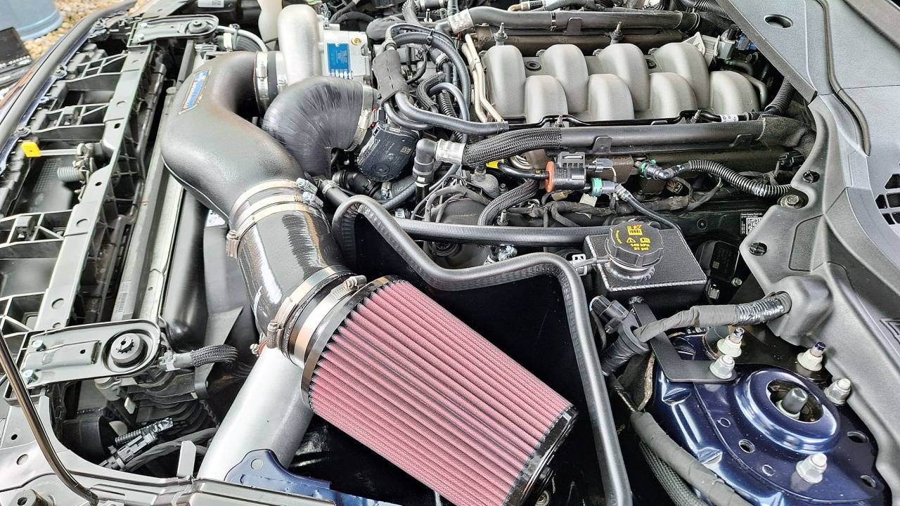

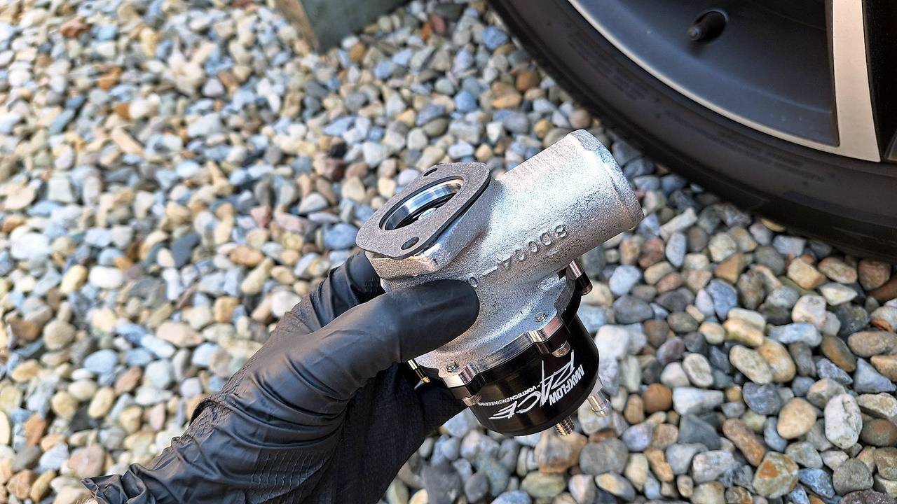

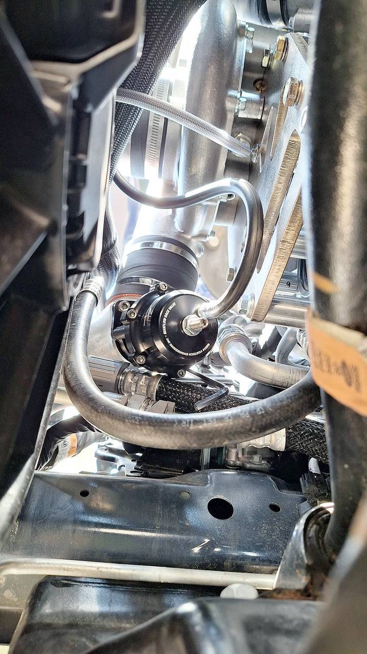

Thanks - couldn't have done it with out you and the rest of the team! I forgot to post in here that the race valve is fitted. So that is the last of the supercharger work done. yey!looks great

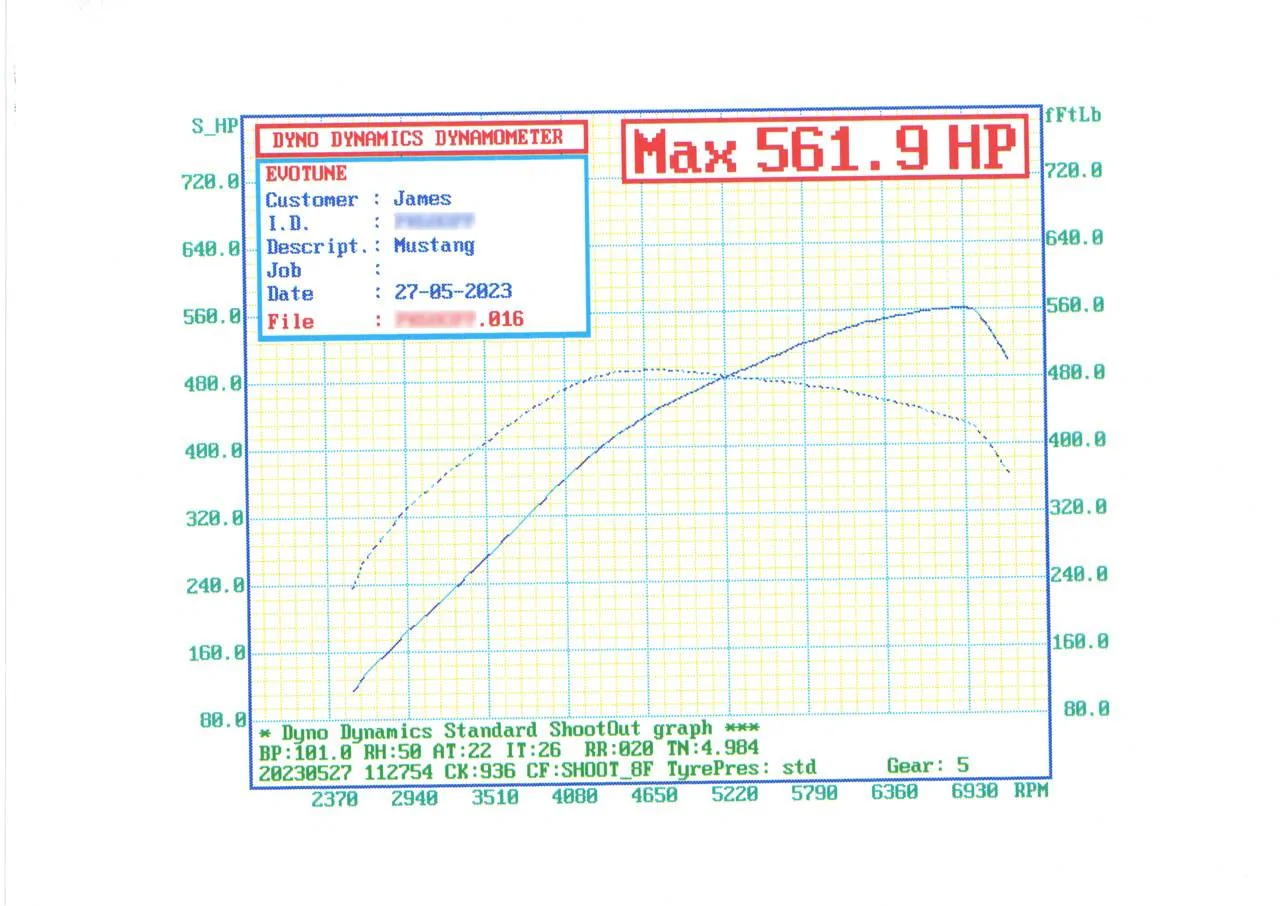

Good question I'm not actually sure, @Wengerd Performance i think was going to tell me but I never heard. Think he said he would calculate it for me. Any ideas?what boost figure is that? Loving the torque curve and the engine revving out til 6.9k revs
surprised dyno operator wasn't measuring it. I wouldn't like to guess but your power figures (at wheels i presume) is about 190hp more than my own MY17 so that has to feel pretty good without the traction worries overwhelming the driving experience.Good question I'm not actually sure, @Wengerd Performance i think was going to tell me but I never heard. Think he said he would calculate it for me. Any ideas?![]()
I need to pull up one of your logs againGood question I'm not actually sure, @Wengerd Performance i think was going to tell me but I never heard. Think he said he would calculate it for me. Any ideas?![]()
