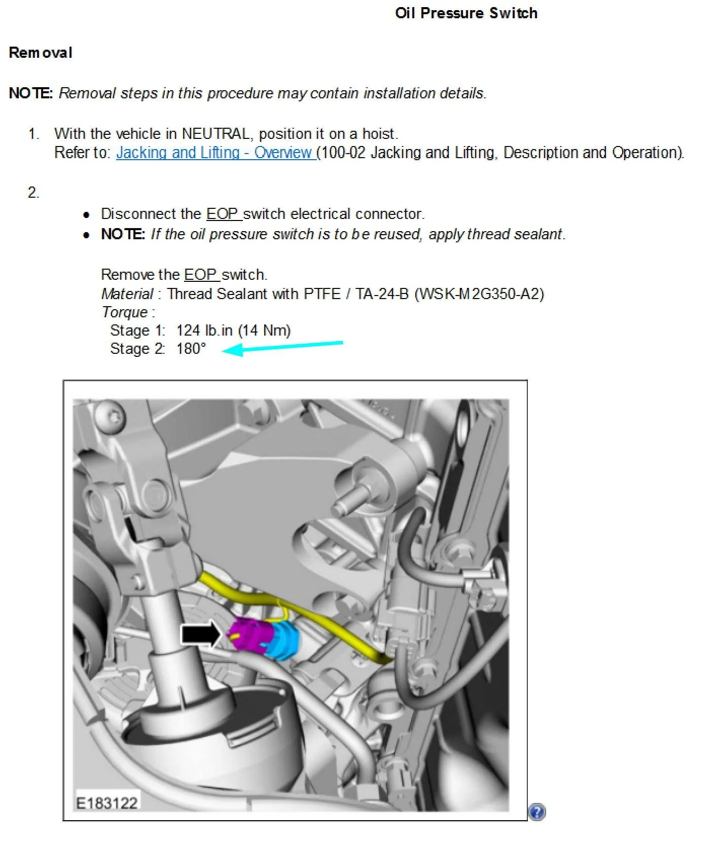

Towards the front, in front of the oil cooler lines.where is it in relation to oil filter. When your lookin up through the trap door in belly pan
If I remember correctly it's before the oil filter looking from the transmission, take it to the dealer and have them fix it, they are aware of the problem, it's a simple fixwhere is it in relation to oil filter. When your lookin up through the trap door in belly pan
YesSo is this pic supposed to be looking down from under the hood. Also the service manual doesn't show any 5.2l only 5.0l. So are they in the same place. Also look at torque spec does that mean torque 124 in# then half turn more?
