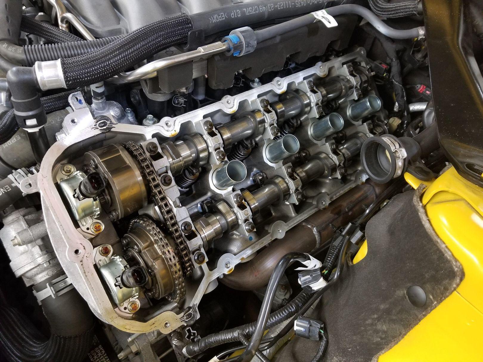

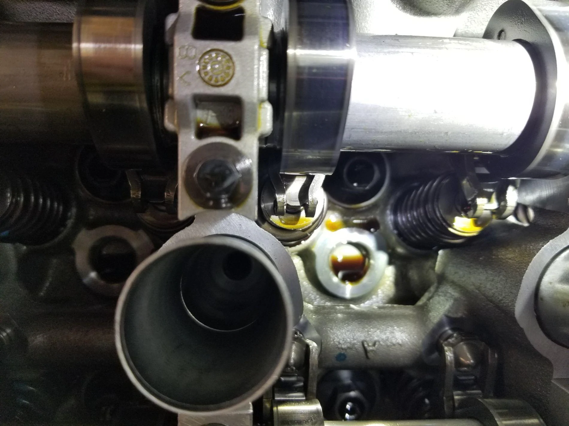

Dealership got a preliminary check on it by checking compression and codes and confirmed it was a misfire on #5 or #6 with 14% compression, which all other cylinders were good. They suspect it's being caused by a valve issue (didn't elaborate more until they tear into it in the next few days).
I'll update this thread with more info.
I suspected it was the well known cracked intake manifold issue, and hoped for something simple like spark plugs. Turned out worse :doh:
