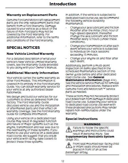

Ford recommends all fluids after each track event.
Could you please post where you found this information? I have been looking through my owner's manual and have not found it yet.
Not that I don't trust you, I just want to read the actual statements from Ford. For instance, I changed the oil prior to the HPDE, and my oil life monitor says 95% afterwards. According to the manual the oil life monitor is supposed to account for driving conditions, so I'm not sure whether I'm just wasting money if I change it again, or if Ford is giving me conflicting information.
Of course it was about 40 degrees on my track day, so the heat cycling of some of the fluids may not have been very severe.

It's on like the first or second page.
Huh, I definitely don't see it there. I looked all the way through to page 27 from the beginning of the manual and don't see it.
Sorry I was at the track when I replied. It's physically page 12. :)
Thanks! That's a big help. I will do the trans and rear diff fluid or have it done. At the very least I will discuss it with the dealer that did the maintenance and make sure they will back me up if I ever have a claim.

Swapping the driveline fluids every track day is a bit conservative...oil yes, especially with low end oil, but tranny and diff every time is a lot, especially if you get a dealer to do it each time.

You better pray the dealer doesnt void your warranty for HPDE. You usually wanna keep that kinda thing to yourself...
That said, changing all fluids after an HPDE is a waste of money and fluid. Run good fluids like Amsoil and you'll be fine. If you went for a full weekend of HPDE on Motocraft 5w20 however, then I'd be a little concerned.
Technically Ford only recommends engine and trans fluid after every event, rear axle every 12 hours.
