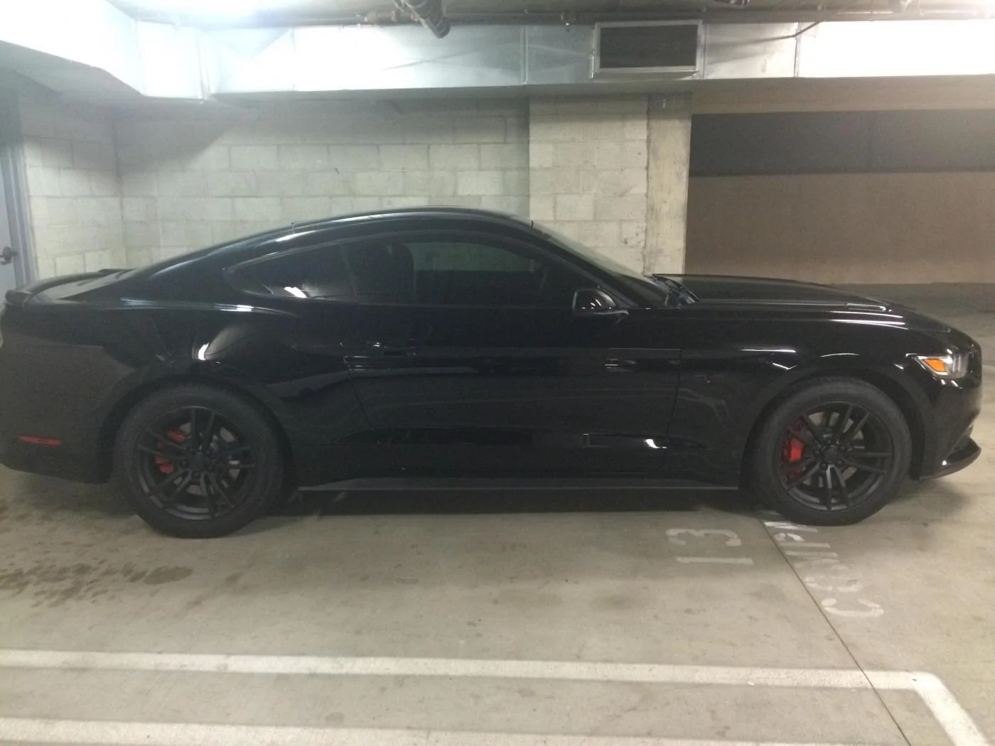

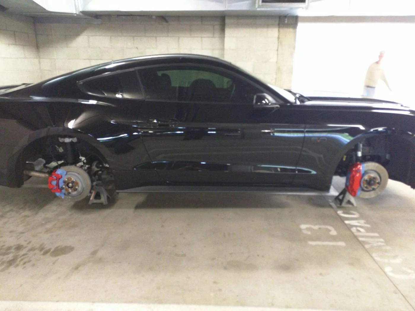

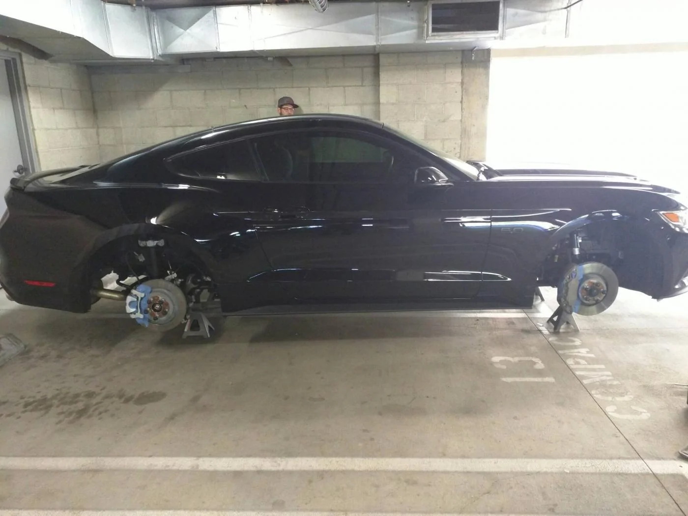

Painted my calipers this weekend. Sorry for the shitty angle with the tires on but in person it looks great. Very happy. Kit was really easy to use. Only advice I would give is to not use the paint brush included as it is a POS. I went and bought some other paint brushes and cut them down and they worked much better than the included one. I put the car on stands, removed wheels, cleaned calipers with included brake cleaner, taped off places I was worried about drip, applied a coat to each caliper, finished my beer, did another coat, had another beer, did a third coat, let it sit for two hours, then put wheels back on and get car on ground, then let it sit there for another 24 hours.
