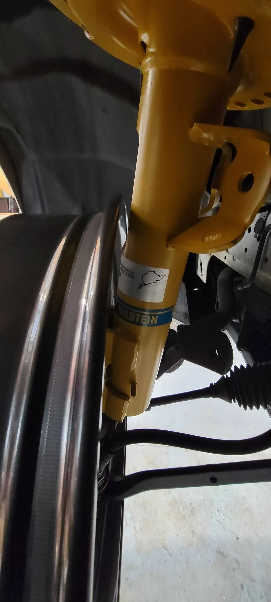

No, the idea comes from (rare) reports here from people with S550s who post here who have had tires sometimes rub the strut with ET40s.
Look at the picture. Most shocks dont have that recessed cutout that those yellow bilsteins do, so a ET40 10” wheel is actually very close to the strut with some tires. Some 285s seem to touch some shocks under full droop. Others clear. Either way a little rubbin at full droop isn’t usually a deal killer and many people dont seem to have the issue. ET35 fits every time.
Paul's Pony
Jan 8, 2020
GA
Paul
2020 Mustang GT Premium, Magnetic, Showstopper Red
I'm considering an Ace wheel that is available in ET35 and ET40. After looking at that pic of the ET40 wheel fitment and hearing your explanation of the problems some people have with the ET40s rubbing with certain strut/tire combos, I think I'll go with the ET35. My question for the thread is how close will I be to rubbing the fender now with 285s on the 19x10, ET 35 wheels? On the fitment web pages it looks like I may have only a 1/4" or so of clearance. I guess that's enough as long as nothing touches right? What about tire deformity under hard turns etc? Anything to be concerned with there?

I have 1/8" clearance and there is no sign of rubbing. I track my car.
I think the tire does not distort at the top even under hard cornering.
