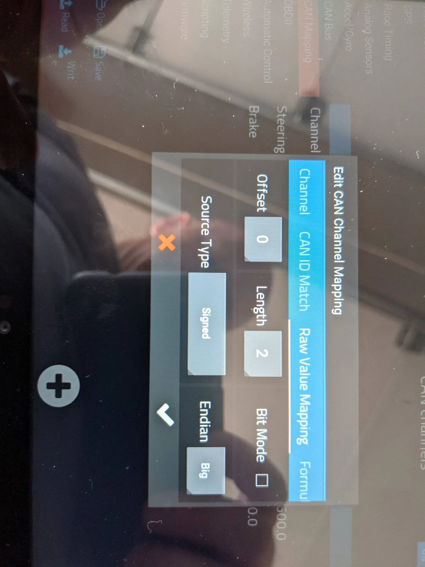

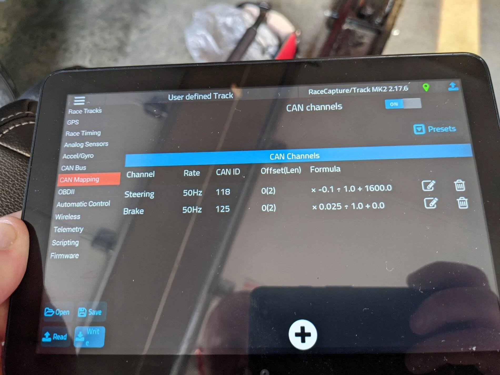

Anyone figured out CAN bus IDs for things like Brake Pressure and Steering Wheel Angle ?
S197 presets don't seem to work (I'll experiment some more but at least first shot wasn't successful). Google search brings nothing, search on the forum is mostly someone asking question and others not knowing what he's asking about...
