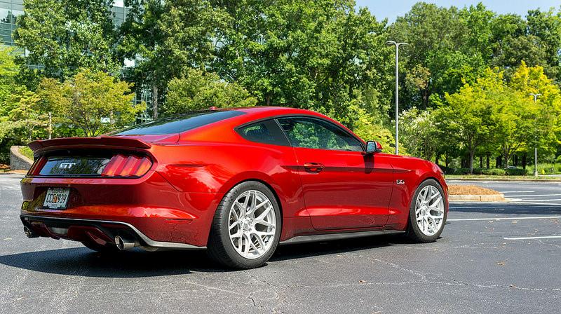

There are tons of different options. I went with a (relatively) light wheel with the MRR GF9 19x9.5 on all four corners at a +30 offset. I run Michelin PSS with 275/40r19 all the way around. The wheels are rotatable without a space and the fitment is spot on.
The PSS tires weigh 4lb less total than stock tire setup, and the wheels (at least mine) came in dead on 25lb a piece. That's pretty light for a "cheaper" wheel.

here's how mine sits with +30 all the way around.
I think +30 is perfect for 9.5, and honestly, with the PSS i've had excellent wear so far, and the grip is insane. In the wet it's rock solid stable, where the Pirellis were spooky. The dry grips is magnitudes better. I have no traction issues whatsoever. No reason IMO to go wider than 275 with my current power level. Maybe if I ever go FI, but not NA.
