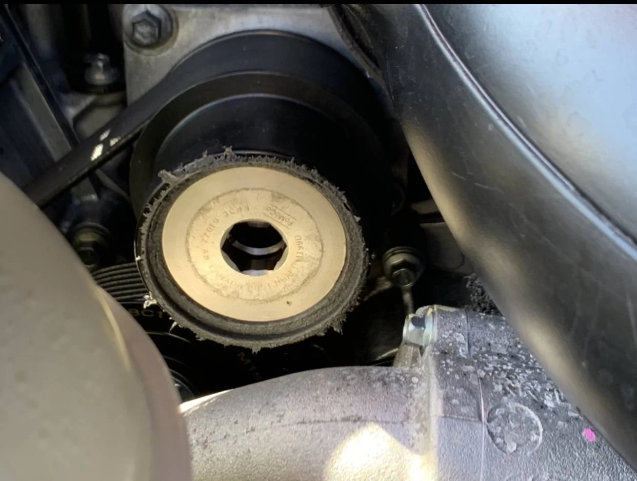

Possibly causing this issue?
Not my car happened at a track event. Repair was covered under warranty.

Mine looks like that too. But figured it may have been pullied before I bought it lol.

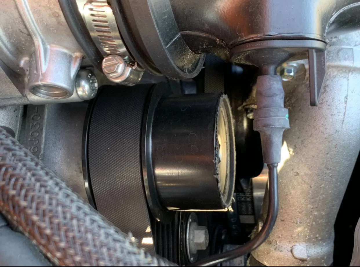

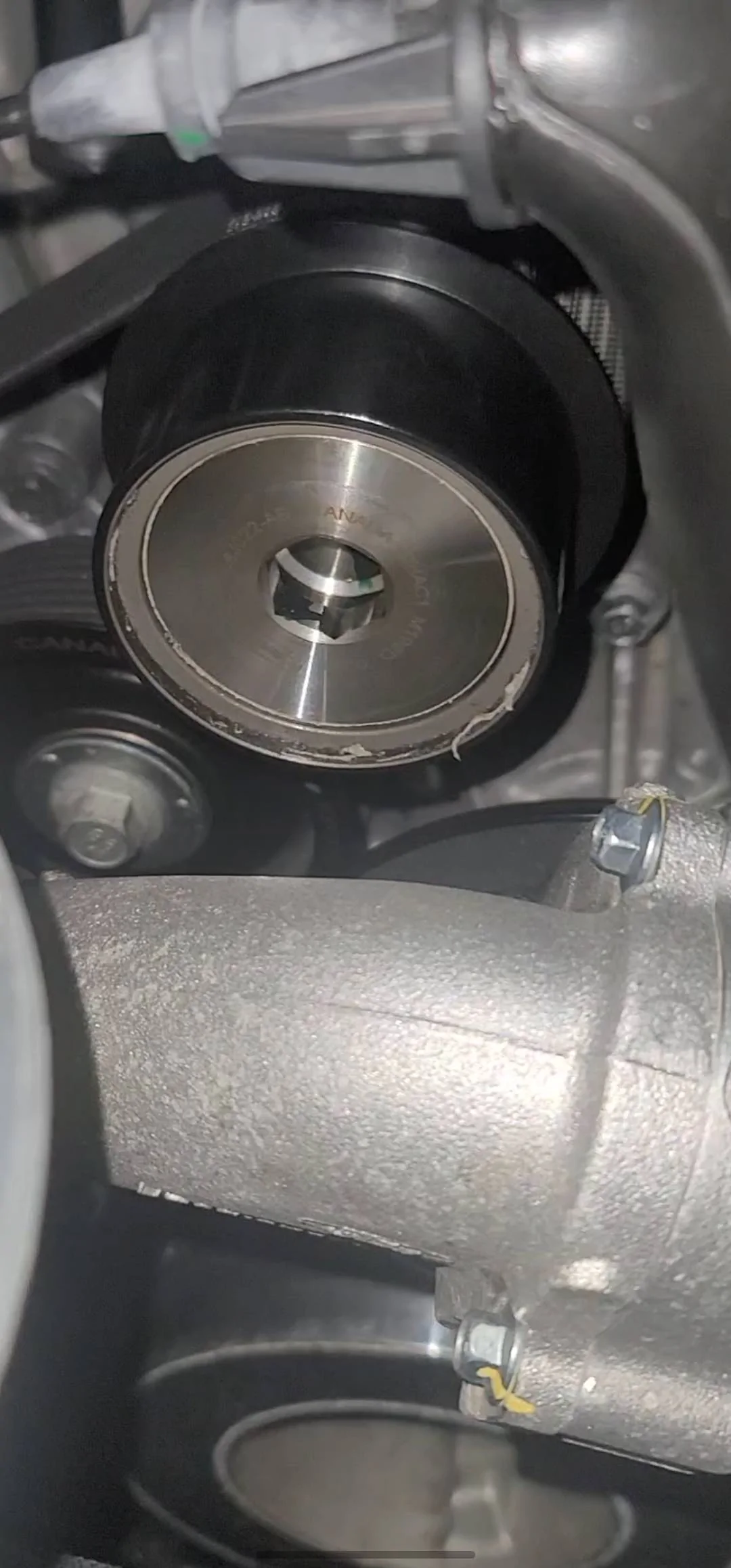

Mine did it too (in Dec at COTA):
Felt like it went into limp mode for a while, but recovered. Didnā€™t see any codes. Still had boost pressure.
Blew black gunk out the front and yellow goo out the back.
They replaced the whole drive assembly. I never found the front cover piece.
I wanted to feel if the clutch was working but the guys told me that Ford called for the part ASAP so I didnā€™t get to see it removed. Repaired in Jan 2022.
Mine happened on a cold day in Dec with ambients around 40*. Wonder if itā€™s temp relatedā€¦

Mine was in the first couple of sessions on the first day. Froze overnight. 42* when it happened. I warmed the car up for 10 minutes before the session.
The rest of the event went fine.
Except for the limp-mode feeling for a 1/2 lap or so, I didnā€™t even notice it until a guy asked to see my engine between sessions. When I opened the hood, I noticed what looked like cobwebs around that pulley. Thought that was strange until I noticed the pulley cover was missing and when I wiped away the cobwebs, they felt like crystallized grease. Very weird.

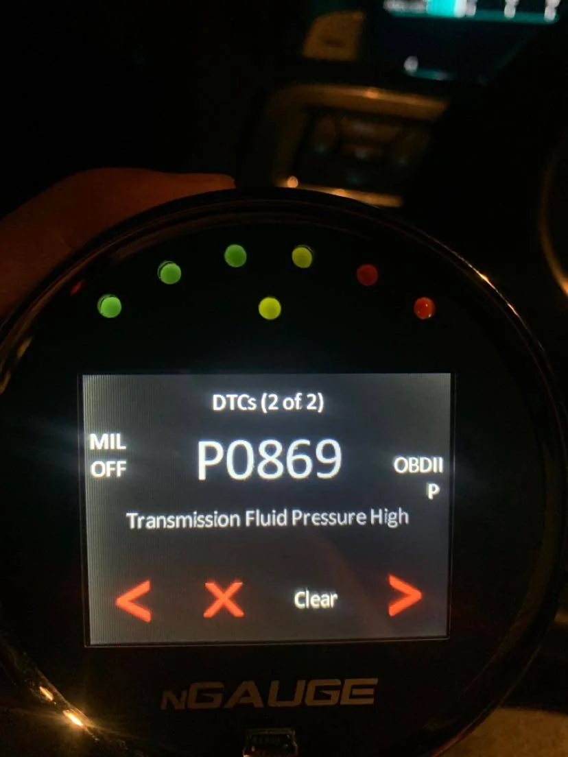

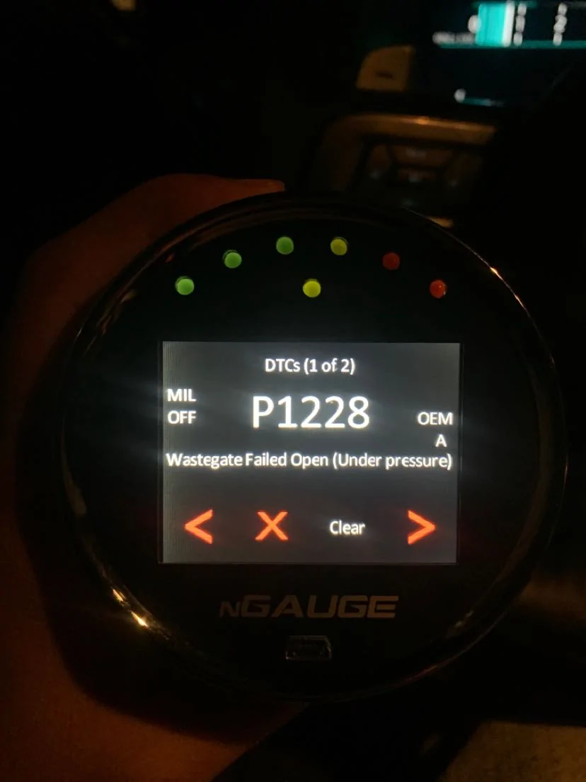

That's good to hear, have you had any problems after at all, I scanned it and I got codes p1228 and p0869 hopefully it's the same fix
