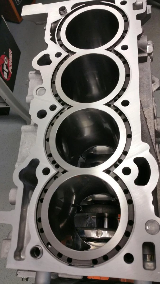

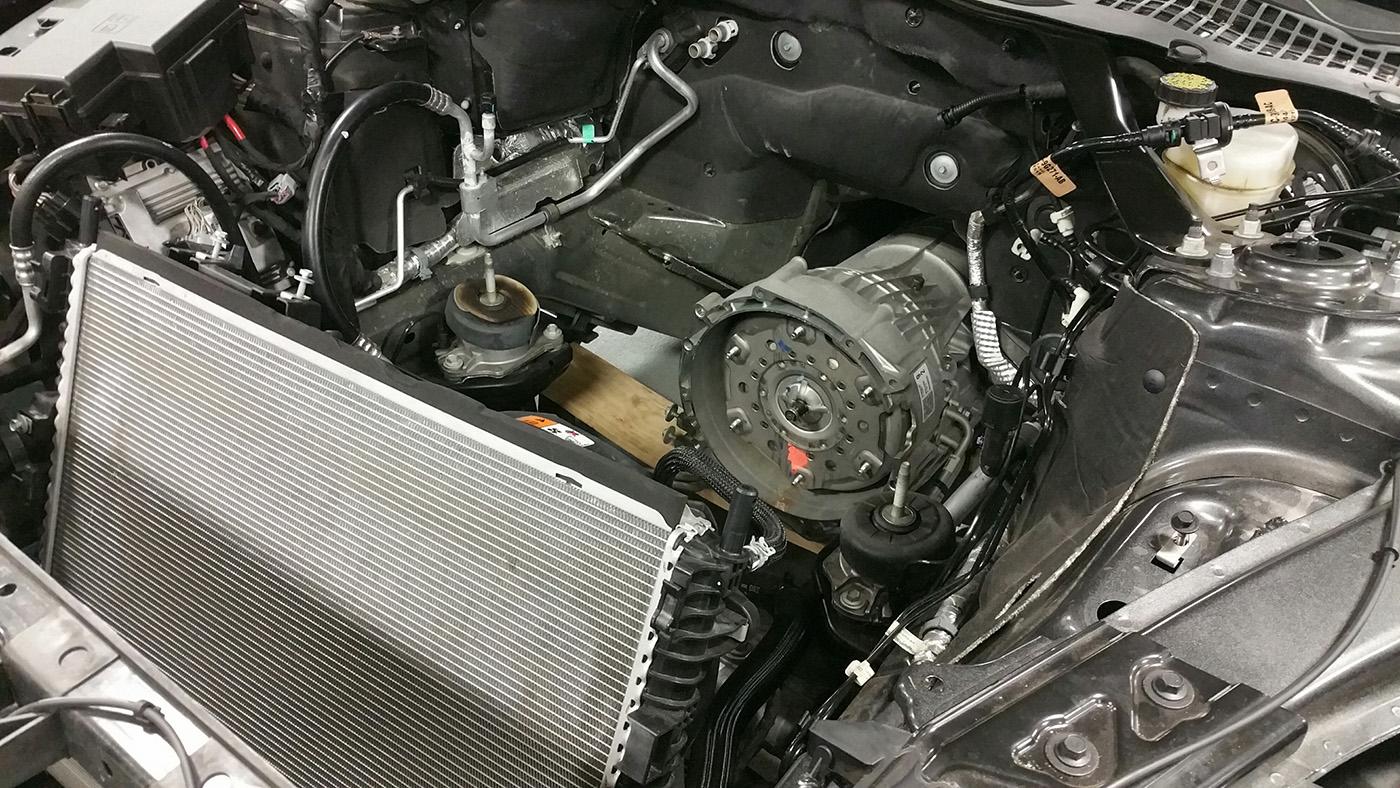

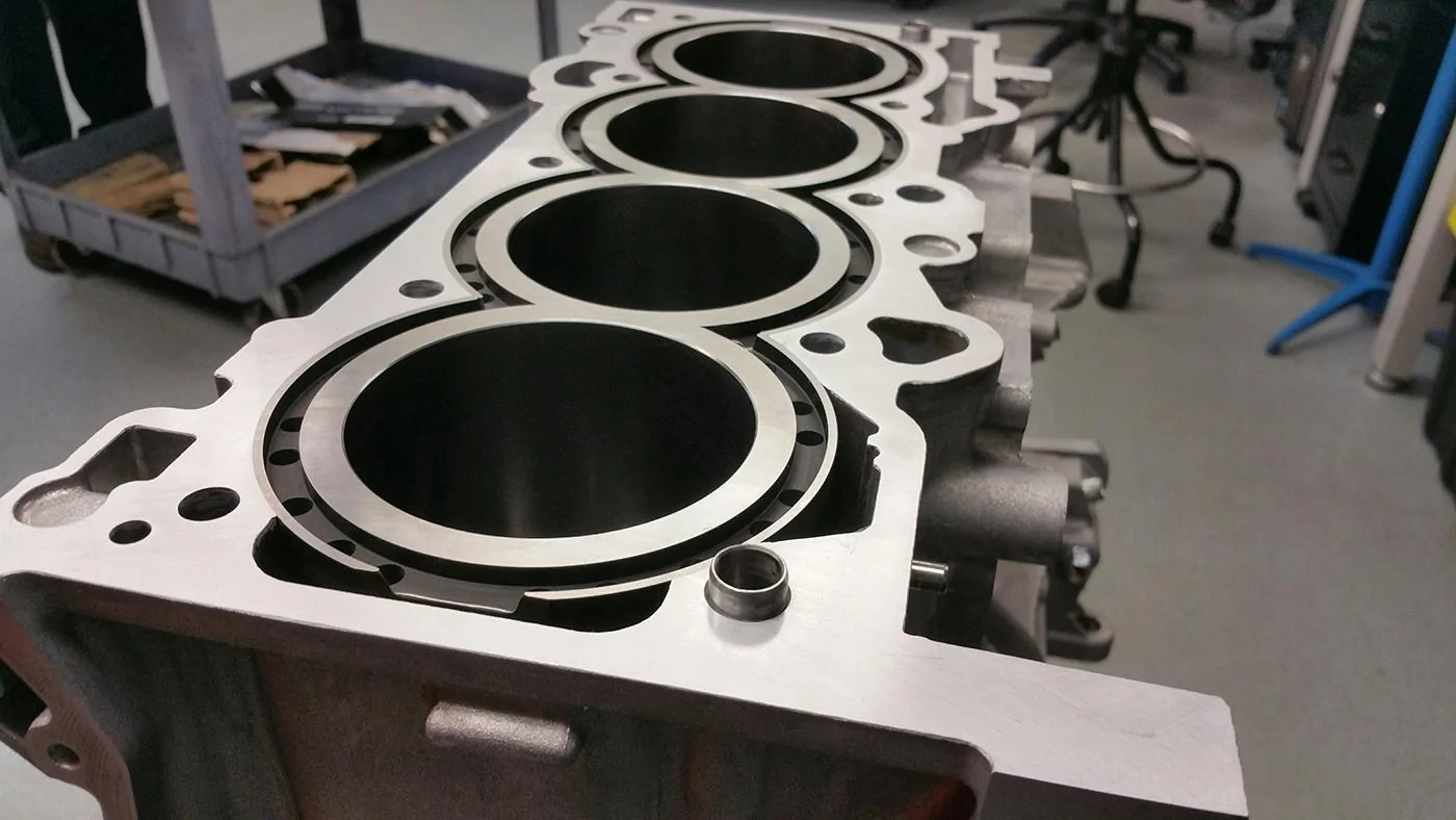

So it begins!! Build completion is just around the corner now, bit delayed but aren't they always. Car will be hitting the track fairly soon, once some final Aux Tuning is completed and the weather clears!
To start there are no words I can say that even begin to tell my gratitude to Adam @ Tune+!!! The man has spent countless hours coordinating the build of my entire car and just NEVER stops or slows down!! I simply drove my car to him and went back this past week to pick it up. He called all the shots and coordinated everything with my build. Which of course I'm overly ecstatic about to say the least. I mean come on, who doesn't want a daily driver w/remote start that can easily make over 600hp, runs pump gas (E85), still gets almost 30mpg and will blow the tires off on the highway if you want it to!?!?! Car is just sick and there's still WAY more to come, just waiting on the new fuel setup Adam is building as I speak. Then we can get into some serious boost numbers and start seeing those 700hp+ numbers!!

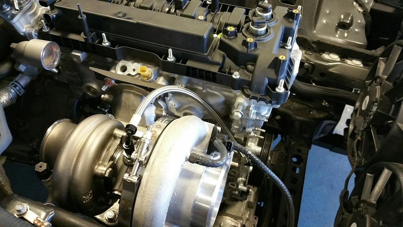

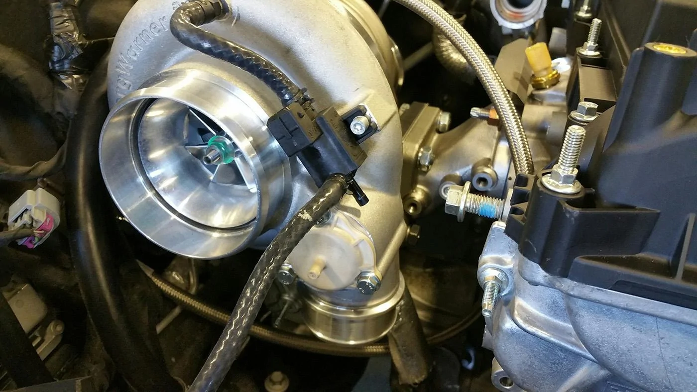

CP-E did has build an amazing EFR Turbo Kit to seamlessly toss this AFR 8374 under the hood and make some power. Craftsmanship of every part of the turbo kit is flawless and worth every penny! Blows my mind this Big Turbo almost spools like stock!! I truly didn't expect it to maintain the crazy boost curve down so low in the RPM's. Twin Scroll is the ticket for sure...

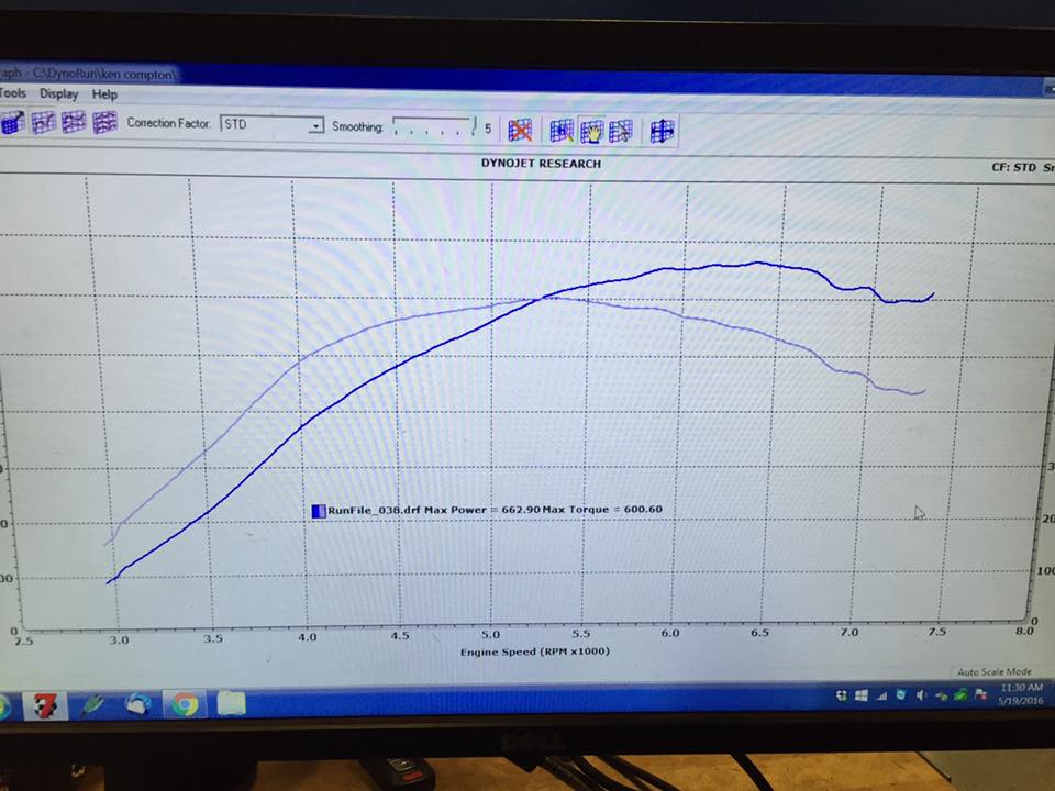

Preliminary Dyno Results & Video, E85 Pump Gas:
Dyno Video on Facebook
(Unfortunately we ran out of fuel and couldn't turn the boost up yet)
July 29th 2016 -update-
Adam remotely Dyno Tuned my grocery getter (literally) today to a lil over 700hp!! Need to take some time to update everything here but just haven't had time. Now trying to get the car ready for the track this Thursday!! Dyno does't mean much to me, track is where a car is proven :)

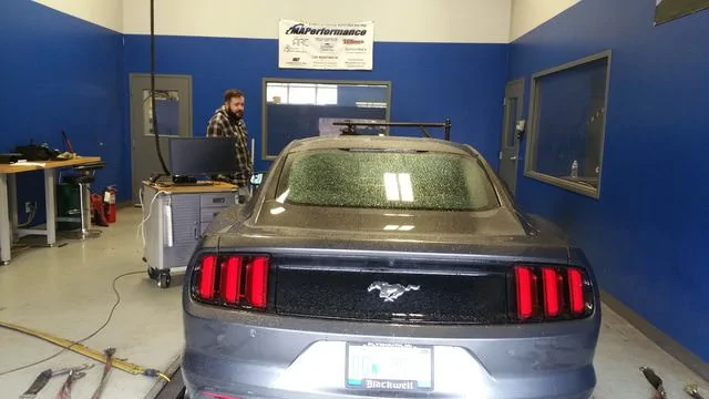

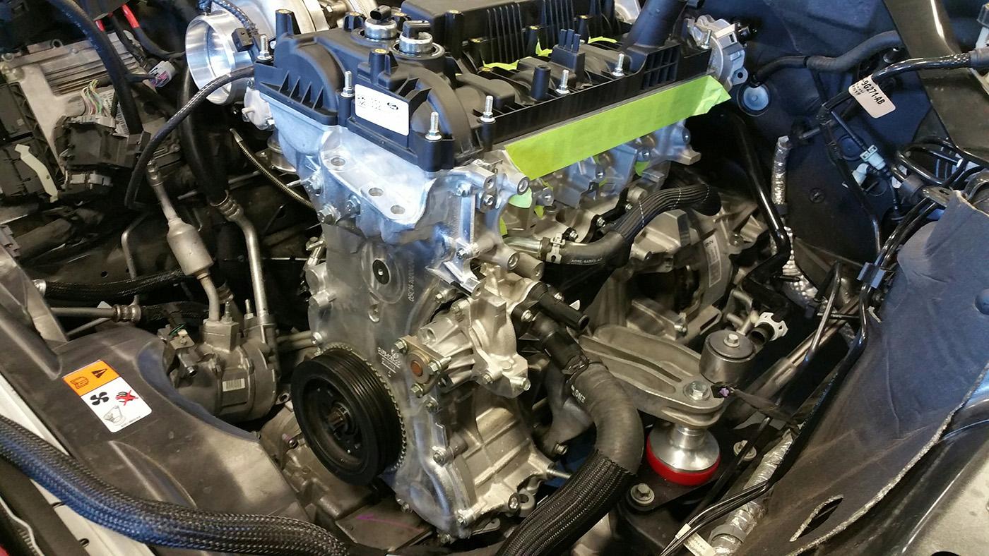

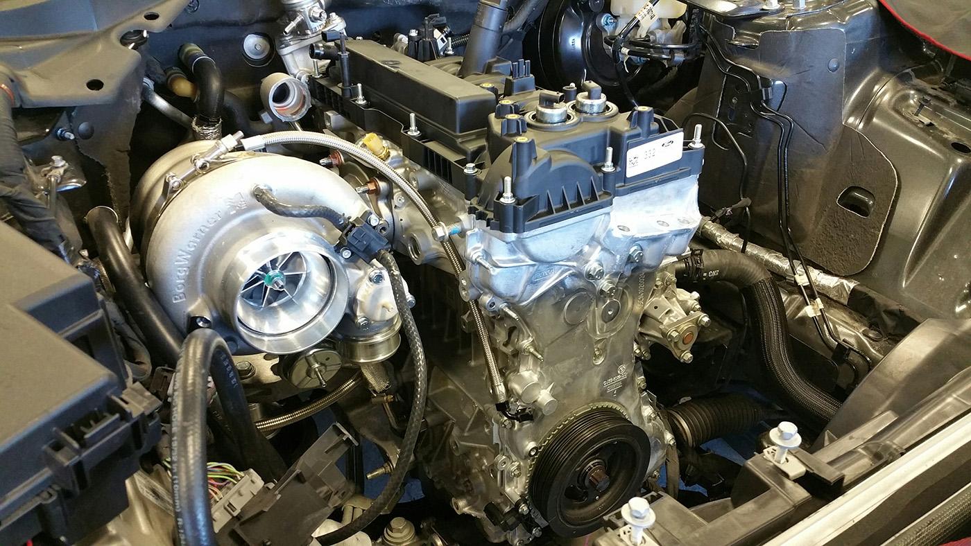

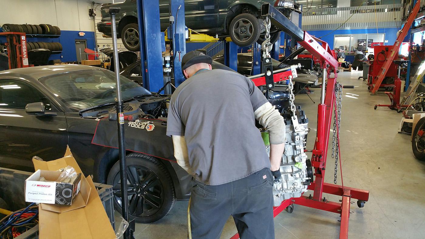

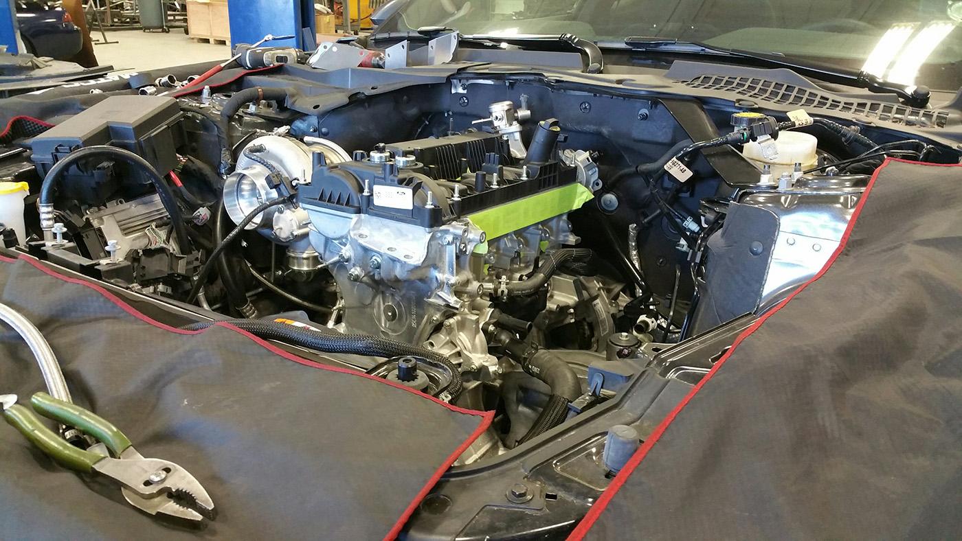

Sorry for the delays with updates but things were running a bit behind. The original post above has been updated and here are some pics from this past weekend:

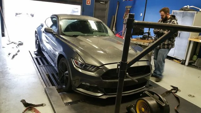

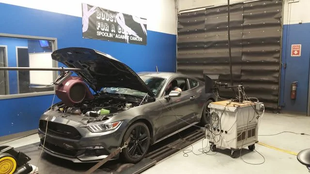

Pulling the car into MAP Dyno Room, wonderful rainy day:
Adam getting things ready:

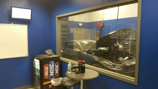

MAP Facility:
Ready to Rock:

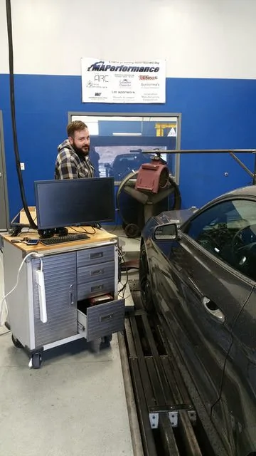

The Man doing what he does! Currently working on three computers, on the Dyno, tuning the Car & Aux Fuel, while talking to a customer on the phone!!

You would post pictures of me in my dyno strapping clothes hahaha.
