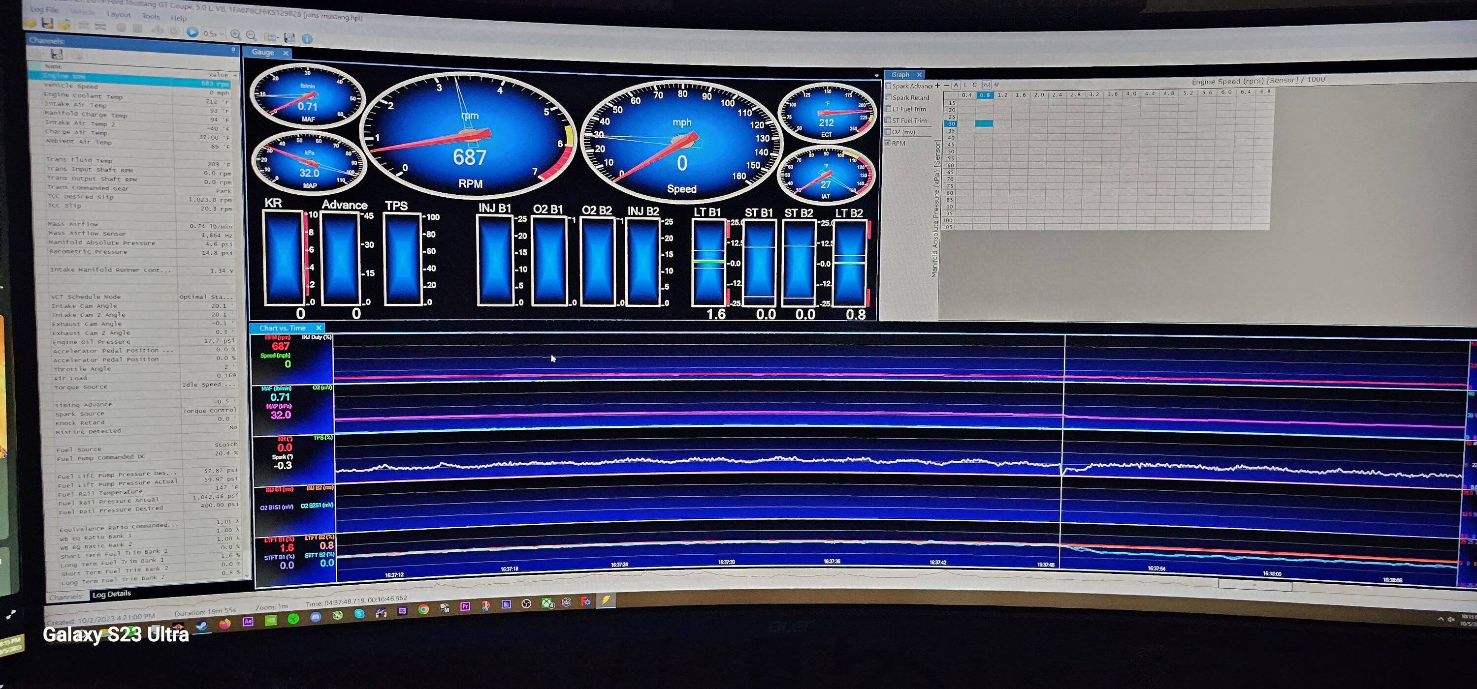

Hey guys, first post on here. I have a 2019 gt with a troubled history. Seems previous owner cooked her well and i would see 230° head temps regularly. Got the car with 36k and am now at 48k. Got an engine replacement due to unresolved p0300 and sometimes cylinder 2 misfire. Engine bucked on a pull and I stayed in it for some carnage. I took out cylinders 2,3,7 and smoked the torque converter. 23 motor in and lo and behold the new engine had same issues. They found a tsb for a cat issue and replaced drivers side. I had some weird high end issues and to me it seemed the coilpacks got cooked and couldnt output what i needed. New granatelli coilpacks on and ever since I haven't really noticed an issue other than tone differences at times. Except last week when i went to make a regular pass on the highway and it started bucking again. I have sometimes been able to hear a noise coming from the front of the car when driving against high walls or fences. Tested the throttle KOEO and sure enough it made a noise that to me sounds like electricity building up due to resistance. Thought I'd post here for a before and after since a new OEM throttle body is on its way. I have had a weird bucking issue with the car and unsure if this is related or not. At idle the throttle angle fluctuates between 2 and 3°. On idle LTFT bank 1 doesn't move at all from 1.6% LTFT bank 3 doesn't move from .8%. STFT for both banks stay more on the higher side of 0-1.6 typically staying at .8 or 1.6 with small dips to 0.0. Fuel lift pump pressure desired is pegged at 57.87 and actual is at 59-60 psi. Fuel rail pressure desired is 400 psi, actual slowly increases 5 psi every 5 seconds at idle. After idling the car for 3 minutes after a drive the fuel rail pressure actual went from 936 to 1203 psi. Fuel pump commanded dc stays at 20%
I am hypersensitive and the throttle is tricky to get a linear press so I cant quite determine if there's a dead spot in The body or not. Here's a video of the noise, I plan on recording with the new one and see if it makes the same noise or not.
