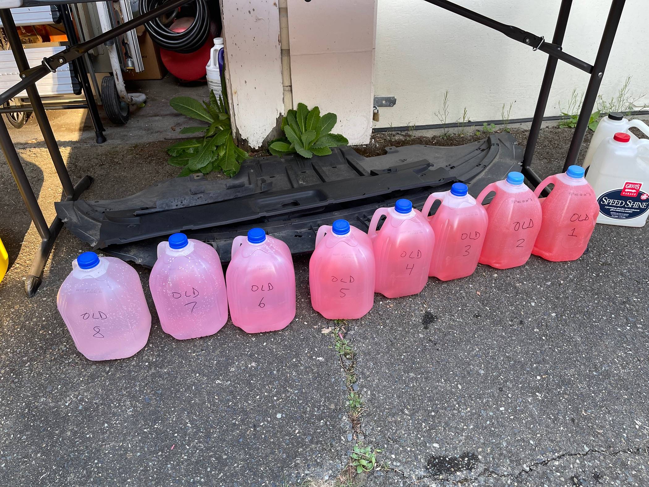

Just finished this on Monday. Decided to do what you did, but decided to turn it into an experiment of course: How many gallons of distilled would it take to get as close to clear as possible (without using any forced flushing system) until I felt it was “good enough”?
For me it took 8:
I know this is silly but I learned some things about this cooling system in the process. I learned you only get heat while running distilled to operating temp if you drive around a bit to get the air to bleed. Sitting on the speed ramps wasn’t going to let the system self bleed even with the expansion tank at the highest point, which this system actually does pretty well. I measured exactly what I took out, so by the time I had most of the coolant out it was a matter of calculating how many quarts in the system vs quarts of concentrate to put in like you described +\- some 50/50.
But yes, there’s no way I was going to get ALL of the old coolant out with this method. But you’ll get most of it.
