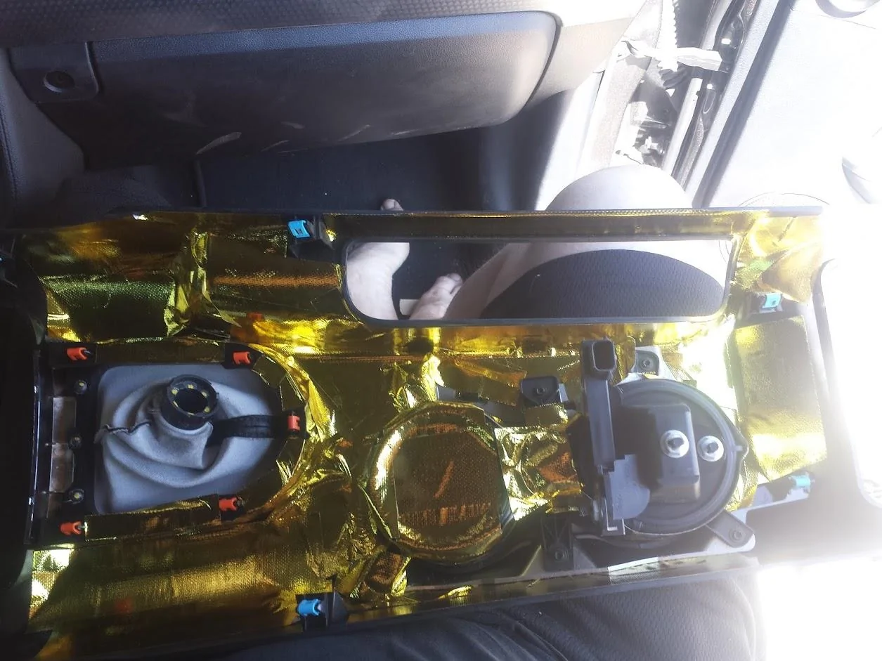

The solution to this was pretty simple. When I did my Steeda Tri-Ax shifter install I had the center console out, so I decided to risk a few bucks and some time and shield it. The center console is quite easy to remove: Pull off the kickplates at front (they just pop out with clips and a magnet) and remove the two 7mm-head bolts. Use a spudger or something similar and open up the center compartment and use a spudger to pry out the clips from back to front; there are two on each side. Lift up from back to front and you'll find a connector just under the rear cupholder. Disconnect this. Unscrew the shift knob, and if you have the Tri-Ax shifter you'll need to loosen the three set screws on the reverse collar; otherwise I believe you'll have to drive out the reverse roll pin (I had good luck using a C-clamp on a punch and socket as a die).
Once the console was out I set about with this stuff:
http://www.ebay.com/itm/201467456074?_trksid=p2060353.m2749.l2649&ssPageName=STRK%3AMEBIDX%3AIT
I cut it into strips and layered the underside of the console. I also removed the cupholders (which was held in by a few Torx-head screws) and lined the cupholders as best as possible. After reinstalling the console and driving I noticed some areas I missed, so I did it again. I've found that key areas to hit are around the shifter, around the cupholders, and by the parking brake lever.
When I was done, the underside of the console looked like this:
I had some (but not much) reflective material left over.
The difference is dramatic. There's at least a 70% reduction in heat intrusion into the cabin.
This is well worth the time and $17 if you get tired of ambient and exhaust heat making your cabin warmer and the center console of your Mustang being obnoxiously hot.
