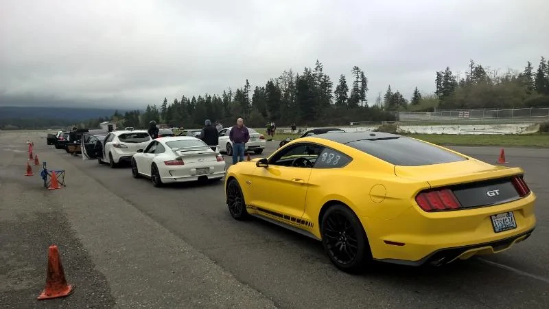

My background: I'm def not a frequent autocrosser (mostly time commitments, but hope to change that) and this was my first time in the Mustang GT (Stock).I have auto crossed 6 times over the past 8 years in my prior cars. I was in the novice class.
Conditions: 60 degrees, moist track, cloudy, rough tarmac, no hazards (trees etc) on an abandoned airstrip. 33psi front and rear cold tires. Heated was 35/36 psi.
Goals: Have fun, let loose, learn better car control on this Stang and how to overdrive it, try to improve times.
Results: Dropped 8 seconds of my time (not competitive) between the first run and fourth. Had the most fun I've ever had in a car. Decided I want to do this more often.
Highlights + Observations:
  • At my novice level, I didn't notice excessive lean (which was weird, I was expecting to).
  • Suspension felt supple and sporty (like a BMWs suspension)
  • I did not experience under-steer. I was expecting to based on many people wanting to run larger front tires.
  • The tires were out of their element. They are really grippy when its hot, but here in 60 degree wet conditions they were neither here or there. I bet Michelin AS3's or even Super Sports would have been much better. Overall grip level was moderate with sudden loss of traction. Bleeding some air from the rears (about 3 psi) probably would have helped as well.
  • I DID experience some over steer. A lot of this was due to overenthusiastic novice mistakes like too much throttle at the wrong times (mid turns, etc) and hard tires - hey, it was addictive!
  • Not surprisingly, my fastest run was in Normal mode with TC on. Runs in Sport + (I did not try Track or switch TC off) were slower.
  • I am pretty confident Sport+, Track and Track+No TC are much better, just not for someone like me starting off trying to learn the course in a new car in damp conditions.
  • I spun the car once mid turn on a damp patch with Sport+ and TC on. I have never spun a car before! So guys, remember, Sport+ and TC on will not save you from a spin! It was AWESOME.
  • On the subject of driving modes, my last car has crazy intervention in any mode other than 'M' mode. Even in 'M' TC would slow it down. You had to switch everything off. In this car, the computers did not visibly intervene. Sport+ mode was like M mode.
  • Of course, the M mode made the suspension incredible stiff (unlike this car).
  • Steering was GREAT. I love the steering on this car as I've mentioned before.
  • I felt the Mustang was more nimble and neutral and less heavy feeling than my BMW M6.
  • The increased torque was also noticeable throughout the run Vs my old car.
  • The throttle response in the M6 was sharper in 'M' mode and I missed that. However, I did not drive in Track or seriously in Sport+, so not a fair comparison.
  • There was a lot of wheel hop off the line. This needs to be fixed aftermarket.
  • I missed the wicked exhaust note of my M. I need to throw on a set of Corsa's soon.
  • I was on the only S550. Got a TON of compliments and folks wanting to ride in it.
  • The key to faster laps was riding with folks to learn the track more, being gentle on the throttle for the most part and improving my lines.
Wrap up thoughts:
  • Biggest mod today is the driver mod! I learnt a lot. I really believe I could have gained another 8 seconds easily if I had run in the AM (so the whole day) and with practice and skill further 5-6 seconds over the season in the stock configuration.
  • There was a lot of Stang love. You can always meet people who have a story about a Stang and want to share.
  • The experience driver in the E92 M3 had loads of love for my GT. He said the S550 was a killer car and very similar to this M3, observations that I share in general as well.
  • Dont quote me on this but I think the fastest times of the day were a 2006 GT (koni yellows and a larger rear sway bar, otherwise stock - 5 speed auto to boot), a 911 GT3, an E92 M3 (R compounds and larger front sway), what seemed to be a heavily modded Fiesta ST and a heavily modded 3-4 y/o Golf R. All these drivers were pretty seasoned auto-xĂ©rs and had an approx 8-10 second lead over me :first::first:
  • There were some folks twice my age kicking ass. Came back with ego in check. Probably a good thing!

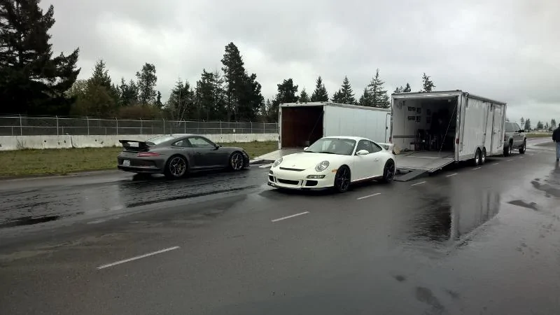

nice writeup, good to hear your impressions. pretty serious guys out there huh? trailering their fully streetable 911s to an autox? hehe a track day i can understand.

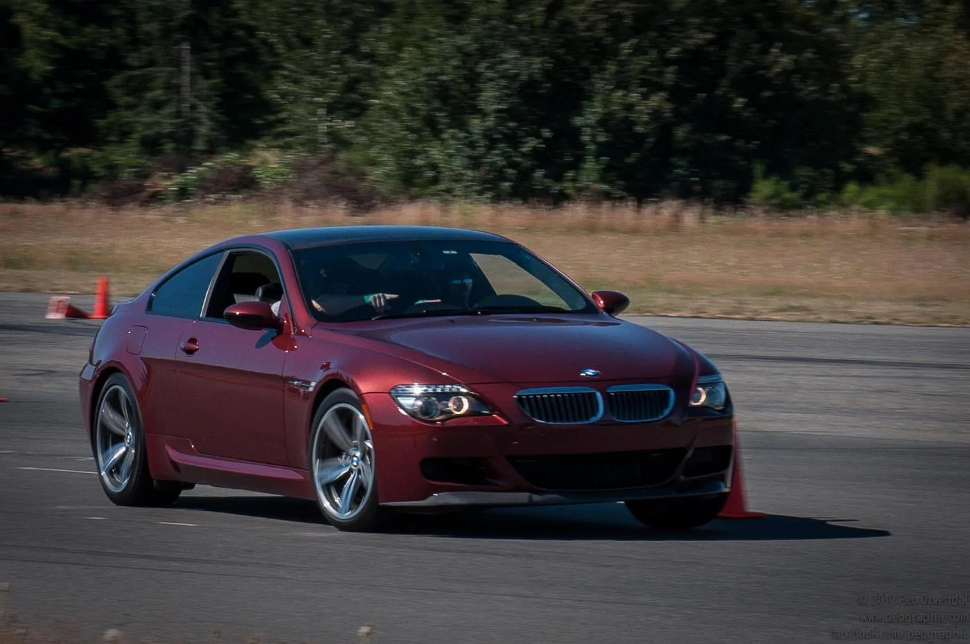

what year was your m6? those things are beasts but i haven't seen many on the autox, definitely more of a touring/road course car. although i don't think people would think a mustang is a great autox car either and it seems like they do okay or better than okay. seat time is the best thing you can do to improve any car and it seems you realize that. glad you had a good time!

My M6 was a 2008, so mid cycle refresh with that sonorous 5L V10 carried over! Never seen one at auto-x myself as well. A great GT car and freeway killer (high speed stability and confidence second to none) with one flaw (other than reliability)- tiny gas tank meant range was small. This is a similar problem with the GT500's as well - I dunno why manufacturers give their top performance models the same size gas tank as the base models!
S197's could become competitive (for that era) autocross cars with mods - the aftermarket was simply astonishing. Lookup 'Royal Purple Forum Wars' video on you-tube, a guy in an 05/06 GT (suspension mods) laid waste to pretty much everyone across different classes. I personally felt that generation, including the legendary Boss 302 had a certain old school-ness about the way they drove.
The new GT-PP is a different beast for sure. Unlike any prior Mustang, it has solid fundamentals from the factory - predictable neutral handling, solid steering, great brakes, stiff chassis and a tasteful interior to boot. The pluses are it still has that huge aftermarket to really make it outstanding and that solid engine. Out of the box though the M3 (E92) and M4 are more aggressively setup.
Track was very technical, all 2nd gear. Thats why the Fiesta ST and built Golf R were laying down times the same as a GT3, E92 M3. I dont know how the guy in the mostly stock 2006 GT pulled off what he did! I doff my proverbial hat to him.
